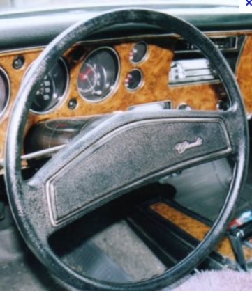

   / Power Steering for B7100 and others? #7
   / Power Steering for B7100 and others? #8
If'n that be what youse be wantin to use then use it.:D
   / Power Steering for B7100 and others? #9
Sorry, that's all I could picture although my last one like that was brown.
