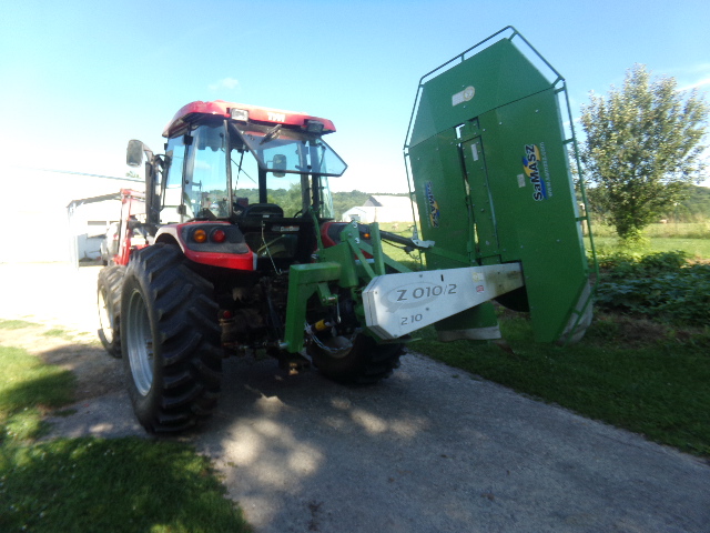

With a 2.1m SaMasz drum mower on a 74 hp tractor, I will cut 5-6 acres per hour.
With a 40 hp tractor a 1.85m drum mower will cut close to 4 acres per hour.
And I also have over 150 sheep.
A 2.1m drum mower will out cut a 3m disc mower.
