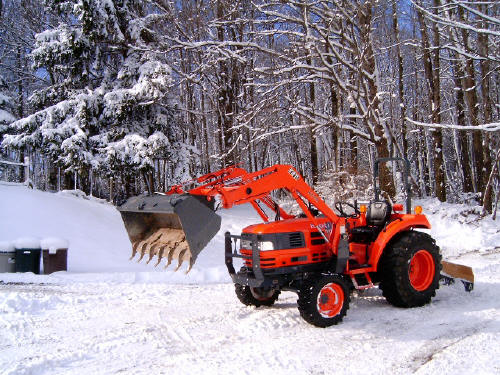

</font><font color="blue" class="small">( What other impements do you run? )</font>
6' boxblade
6' brush mower
7' backblade
5' tiller
6' rear finish mower
8 1/2' backhoe
6' rake
3 point PHD with 12" auger
