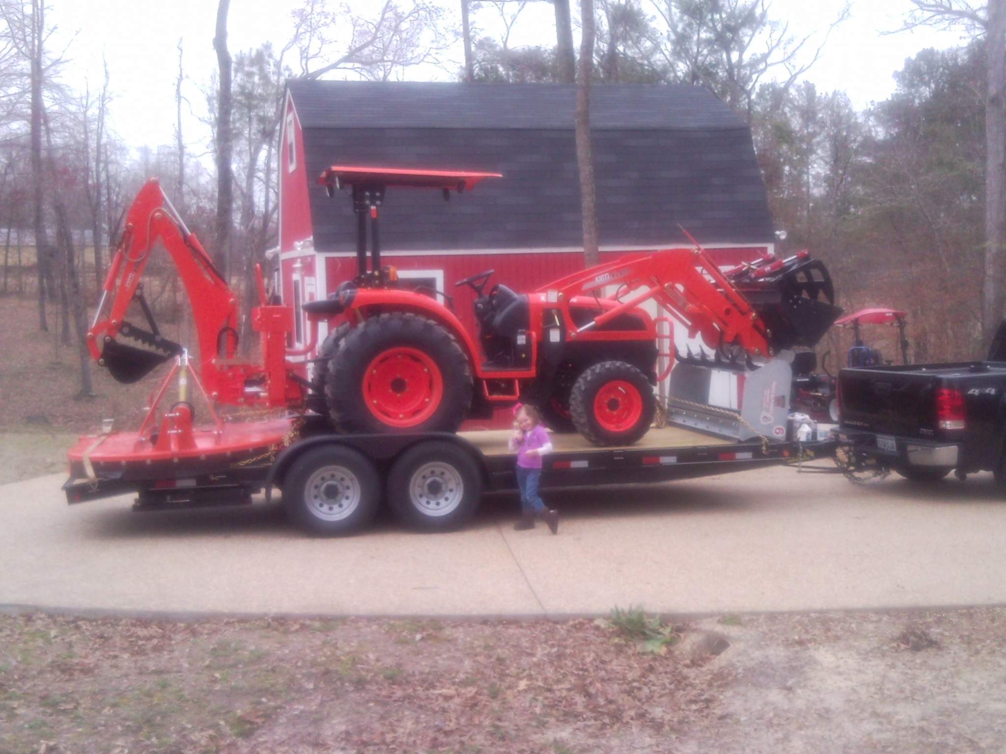

I recently purchased my tractor (DK45SEHST) and trailered it home along with several implements. As you can see from the picture, the cutter was loaded behind the tractor at the end of the trailer. I unloaded the cutter with the backhoe. As I did this unloading I questioned the lifiting capability of the backhoe. I thought backhoe should easily lift the 800 lb mower. However, I had to lift it by curling the bucket and kind of scoot it of the rear of the trailer. Is that to be expected?? I had the tractor running at about 2000 to 2200 rpm. My initial thought was shouldn't the backhoe be more powerful than that?? (Please give me your thoughts!!) :confused:

not positive about your particular machine but by looking at it, 800lbs is probably going to be close to its max.

BTW, that is quite a load there...over 7500# is my estimate.

Gentlemen, I appreciate the replies. As usual you have help me think through my question and realize there is some common sense to it. Of course, the backhoe is designed to dig, not lift!!!:p So, why should I be disappointed in not lifting. I have a top notch fel to accomplish those tasks!
I think I was a little over 10,000 lbs. I remember Wallace stating that the tractor, bh and fel was over 6600 lbs itself, add 800 cutter and 500 for the bb and 2400 for the trailer along with about 200 to 300 for the grapple.
