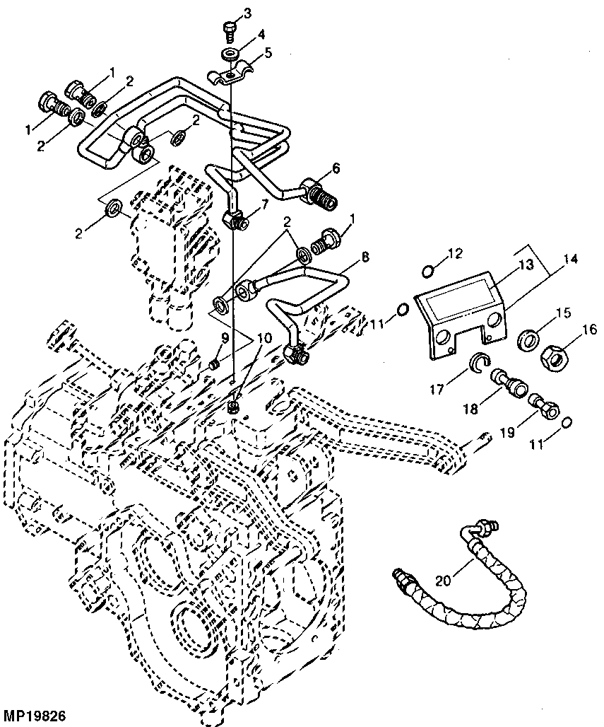

I don't know if this will help, but if you're looking for "Power Beyond Kit" you will probably have difficulty finding it. I just bought this kit for my 2001 JD790 and it's listed as "Rear Auxiliary Hydraulic" kit.
Also, after installing this kit, and knowing what the parts look like, I bet you could probably make a kit yourself. I think I remember reading a thread about someone doing just that. I'll see if I can locate it for you.
TommyJD790...
   / Power Beyond #4
lekwyo,
I just looked up your "Rear Auxiliary Hydraulic" kit on www.jdpArts.com.
There are 2 kit part numbers (MP31353 New) and (MP23146 OLD). These kits look very similar to the one that I bought for my JD790.
You can look at the breakdown of these kits and it will show each piece that's included in the kit. I'm not sure what "new" or "old" means.
I bet if you call your dealer and mention those 2 part numbers, they'd be able to track one of these kits down, or order each individual piece.
There's also a pretty good illustration of the kit on the JDParts website.
TommyJD790...

Tommy, I am not sure where the MP31353 number came from. I found LVB25221 that fits old and new models. It is still available.
