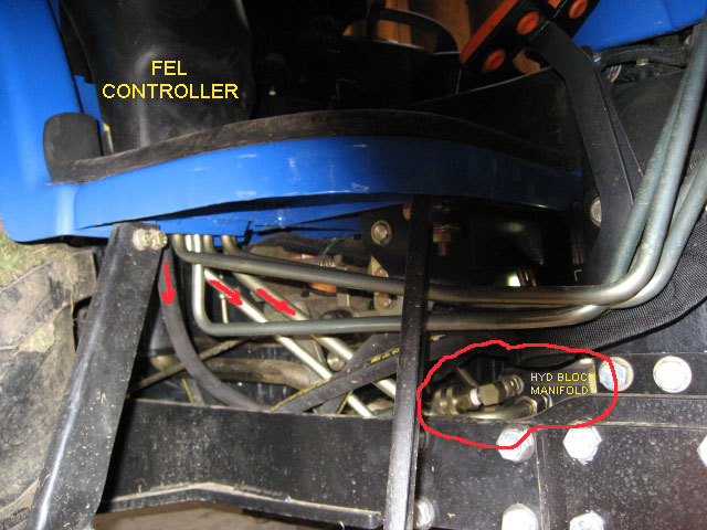

Looking under FEL controller, you will find two steel hyd lines and one hyd hose coming from the FEL controller and connecting to the hydraulic block manifold/diverter valve.
Close up of hydraulic block manifold/diverter valve. Disconnect the FEL hyd hose from the hydraulic block manifold/diverter valve QD and connect it to the BH long hose (pressure return) that you routed forward over the axle.
When you remove your BH, make sure that you reconnect the FEL's hose back to the forward hydraulic block manifold/diverter valve.

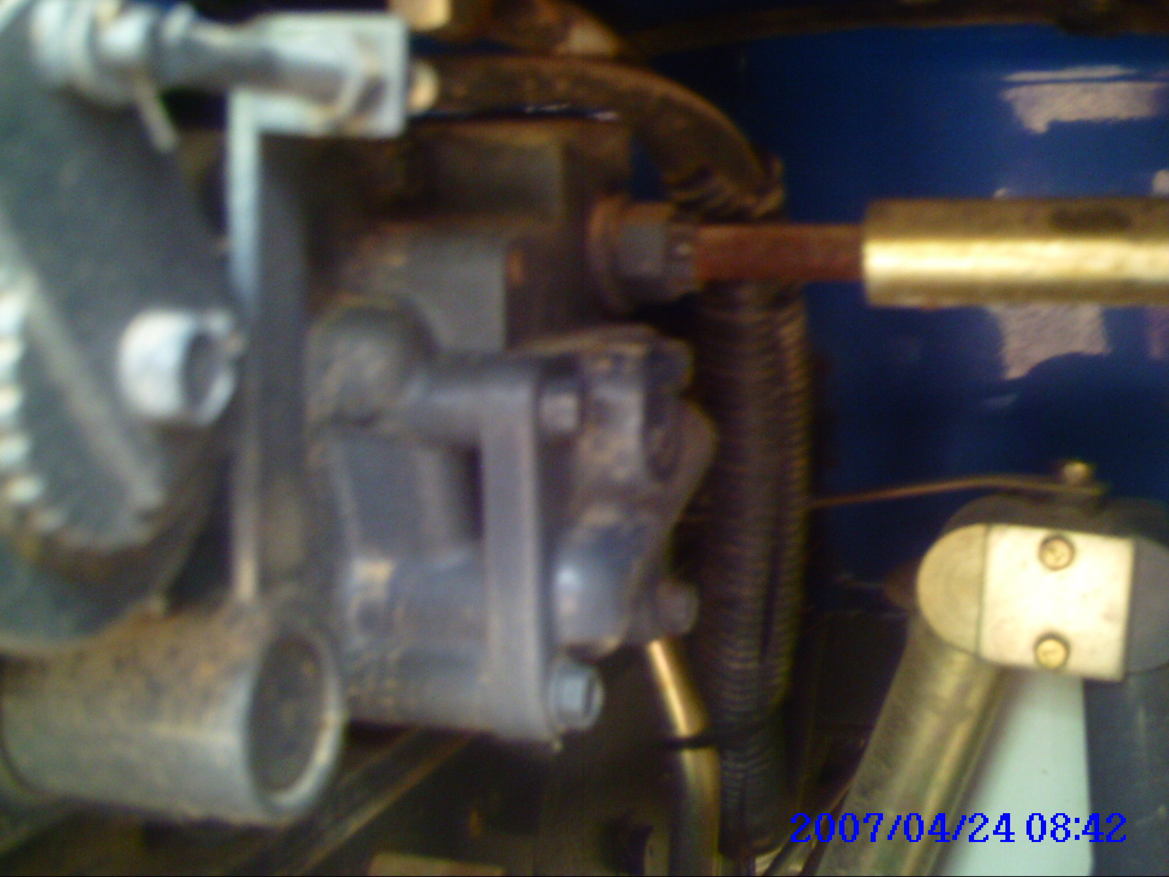

here's a picture on my port inside the rear tire

It looks like your cover plate at the right rear manifold doesn't have any fittings on it, just attaching bolts. In that case, I think you'd have to run both of your BH hoses forward and just match up the QC's with where you removed your FEL hose. I'd trust your dealer to make sure for you.
