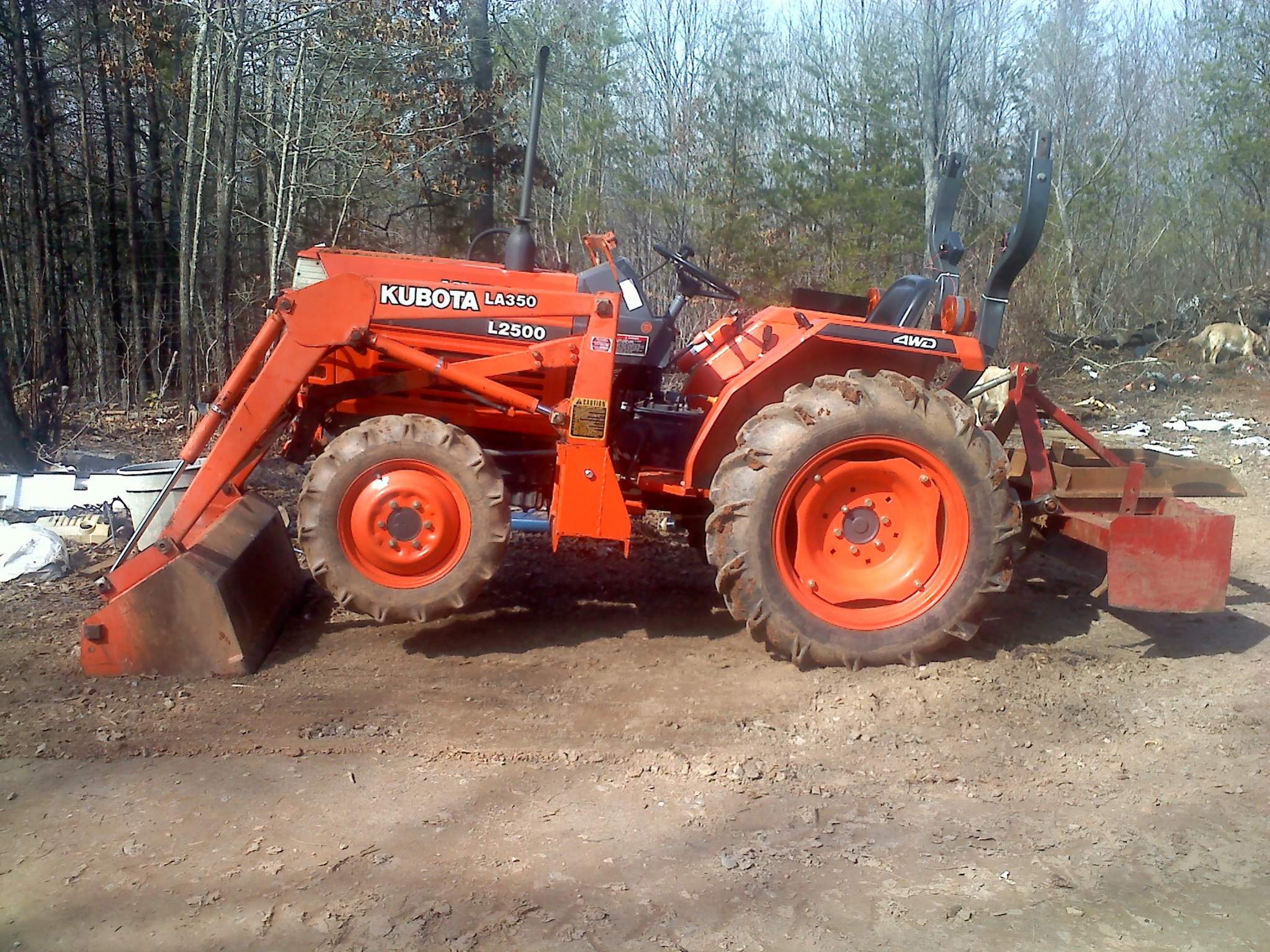

Hello All
I agree with rbargenon as he helped me on my install of FEL to my L2500DT. I didn't know a thing about hydraulics and found out real fast power beyond is used in conjunction with the pressure relief valve on the valve body of FEL .
Also JJ on here is also real knowledgeable about Hydraulics on tractors he also helped me a lot.
BE SAFE Carl
