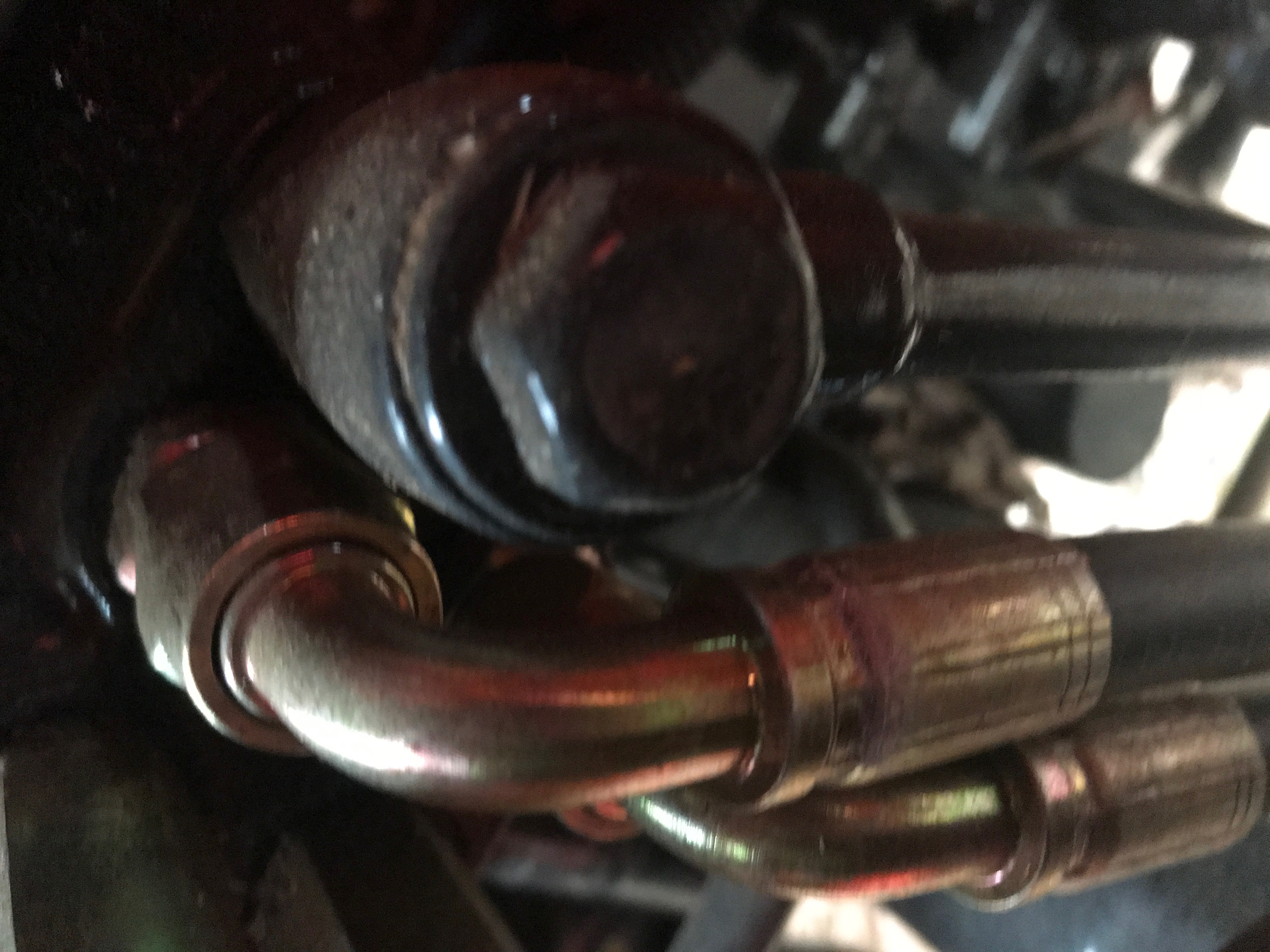

I need a good picture of diagram (both even) of where the Power Beyond port is on the 2610 HST. Anyone got one or can take one? I think its located under the seat. But I need to know which line into the valve is the Power Beyond one to tie into it for a third function install. I am debating doing it myself so want to really get a handle on what I am getting into here.

Is this it? The Black banjo bolt with the solid line coming out under it? Located right under the FEL joy stick?

Been looking for the same information and have come up empty so far, have a new 2610 that I am getting ready to install the Kioti third function kit on.
The instructions and illustrations are terrible....
Hate to bring up an old post but was not able to find the information anywhere even on TBN and it was never confirmed if the image is correct.
Would be great if anyone has a recent install of one of these kits on a 2610.
