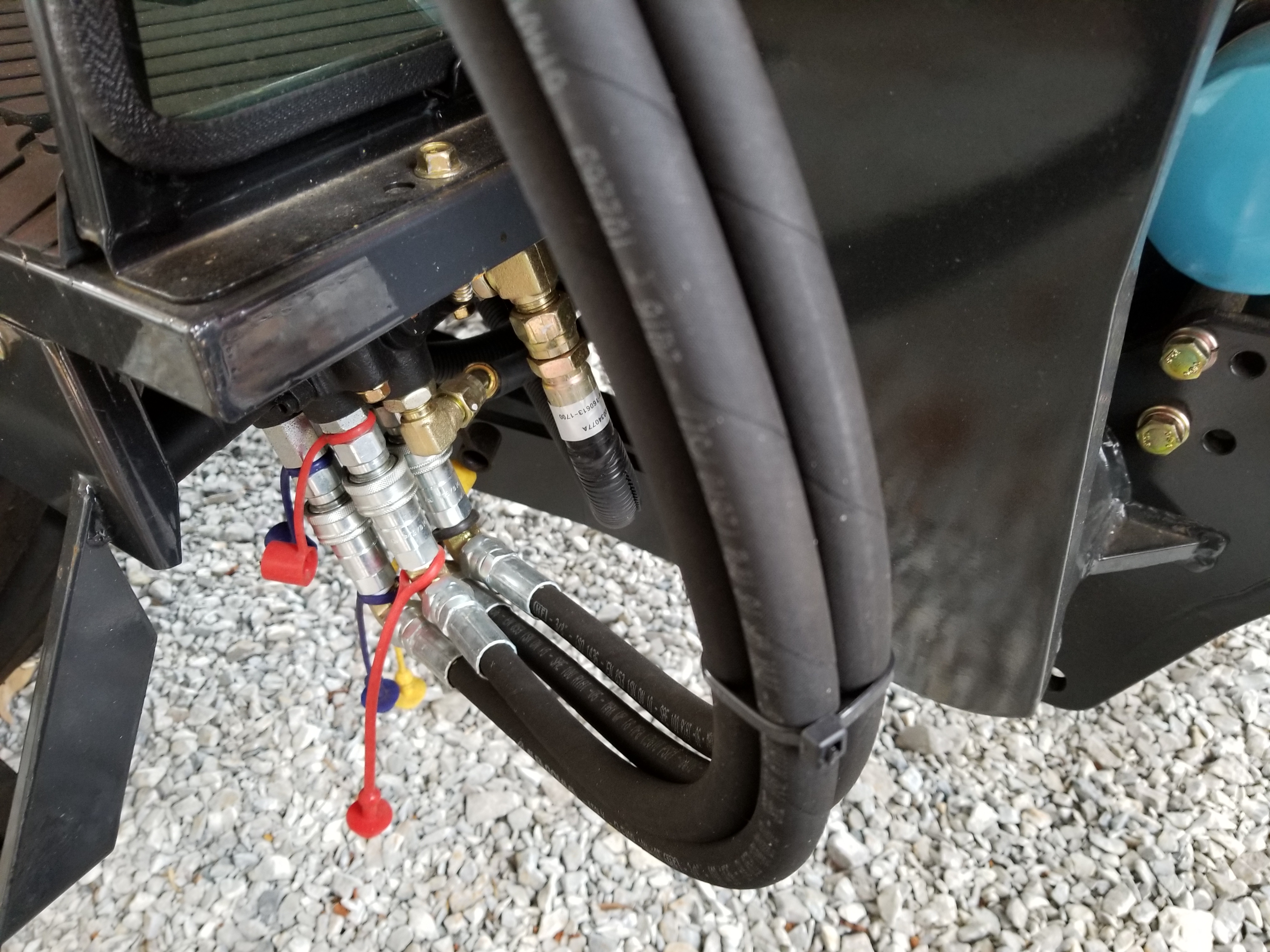

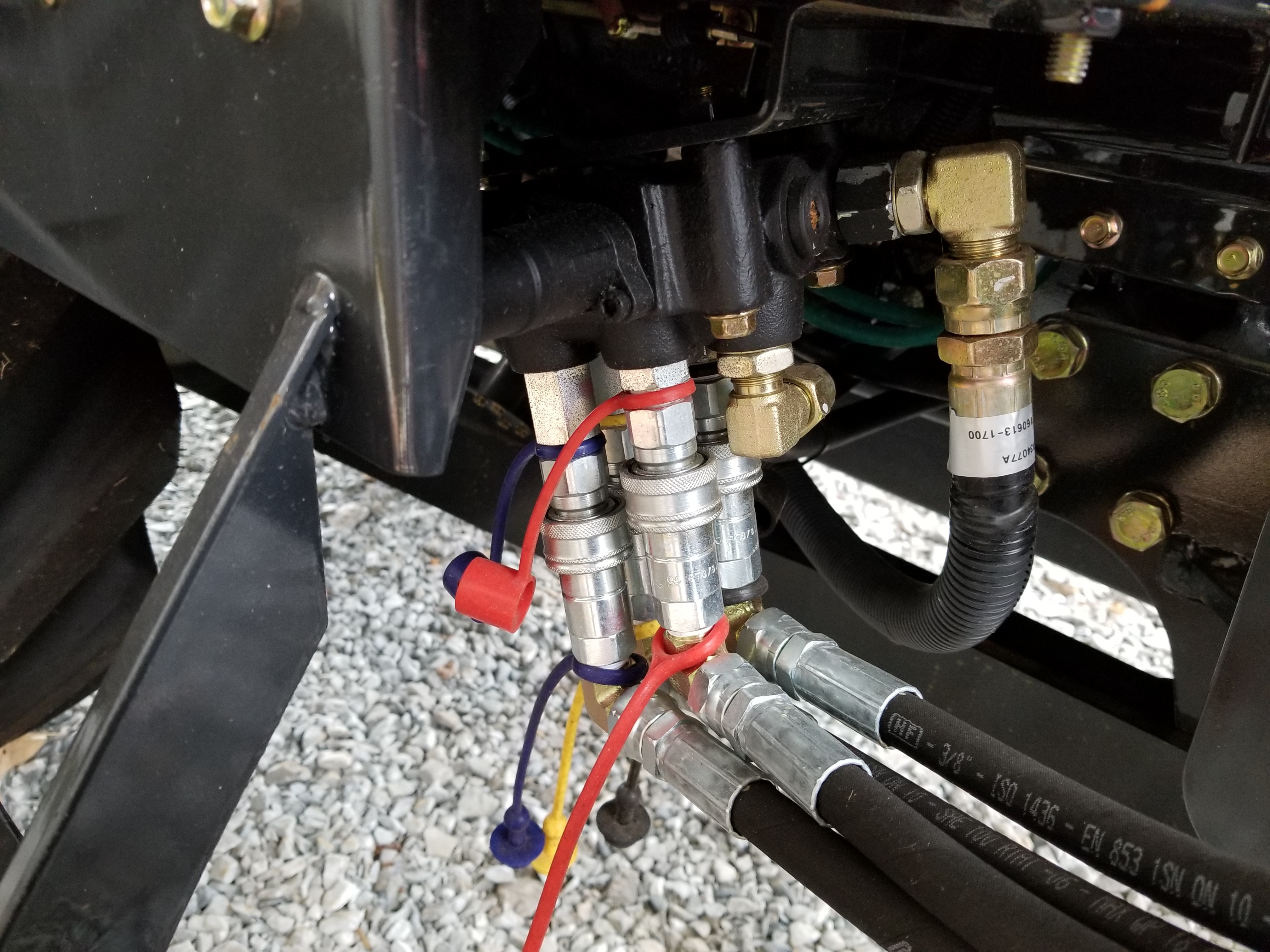

Hey guys, got my Wicked Grapple in and just got my WR Long 3rd Function Remote.
Now I am trying to identify my power beyond port. I have a Branson 4520R with a backhoe and BL25R FEL. I took a few pics of the loader valve. valve 1.jpgvalve 2.jpgView attachment 536804

Does a hose go from the loader valve back to the vicinity of the 3-point lift? If so, that's your prime candidate.
   / Power Beyond Port Identification #3
The hose that has the 90* fitting going into the valve. It has 160613-1700 on the label. That should be the power beyond hose.
   / Power Beyond Port Identification #4
The Branson shop manual says the power beyond port is marked 'C' on the valve body, and it looks like it's the one that Brian identified. There's also a tank line that goes back to the transmission under the seat. On my 3725 the dealer added 3rd SCV has two lines that run from the loader valve area to the remote valve. One connects to the loader valve where the power beyond 'C' port is and the other connects to the hose that used to connect to the C port. Saves the hassle of running a line back to the 3pt or factory SCVs.
Note that the loader valve doesn't put any flow out the PB port when the loader is being operated- it all goes out the tank line. You won't be able to move the loader and open/close the grapple at the same time. You can test this by raising the 3pt while operating the loader.
