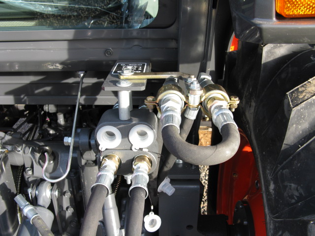

I operate a Rhino 75 on a sub-frame using PB for power. It is an easy and clean setup. QC fittings to attach to the PB, and then get a "jumper" hose (see attached pic) when the BH is not attached. (I have since removed that PB fitting and now it is in a Kubota OEM casting sitting in a stack on top of the other two QC castings.)

I would recommend bringing the PB to the rear like in the picture above for the BH, log splitter, etc.
Do you also have remotes?
