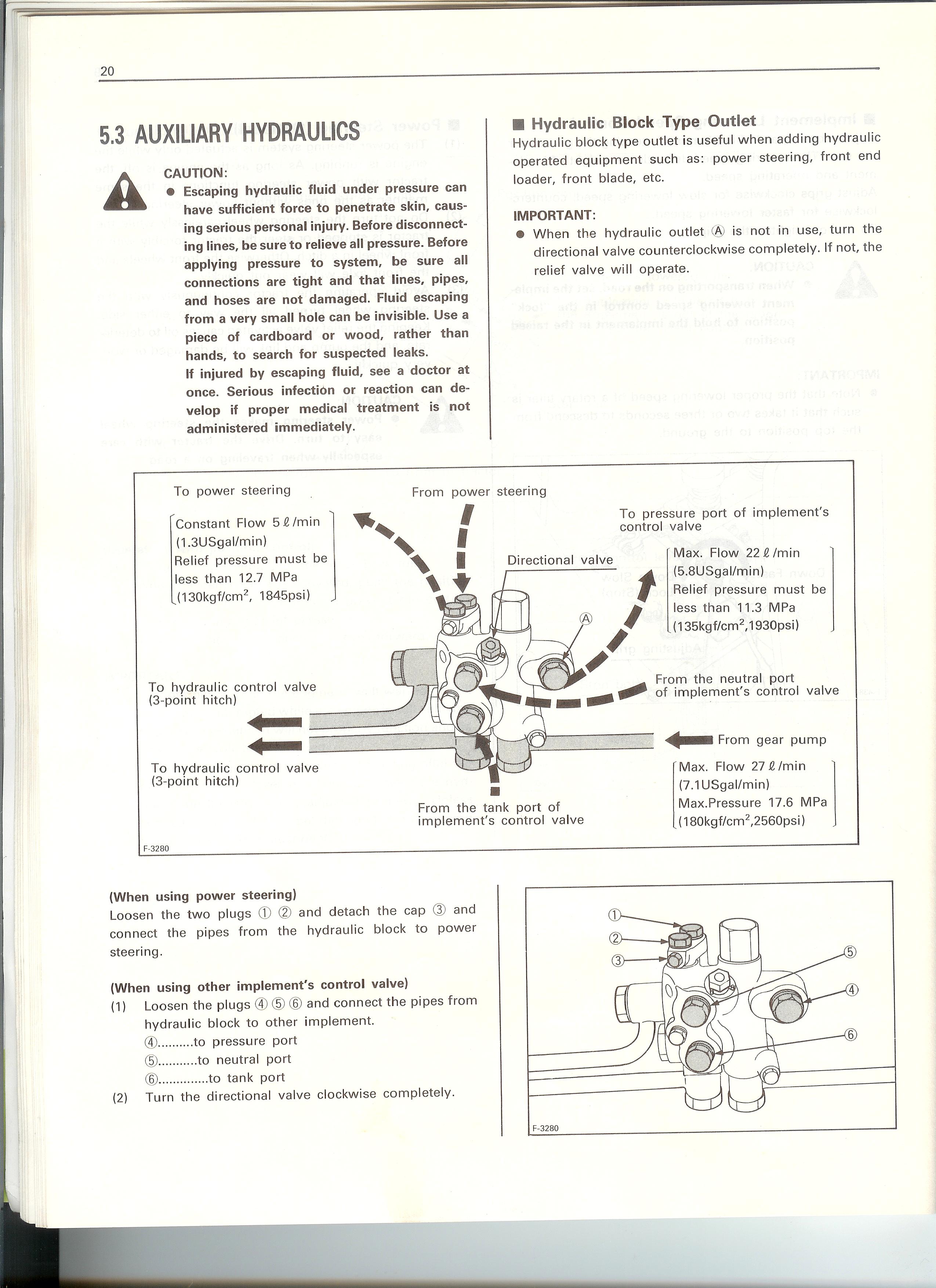

The attached page is from the B9200 Operator's Manual showing the auxiliary hydraulics. My question regards the "From the neutral port of implement's control valve" which is the FEL.
What is the function of the neutral port on the loader valve? Is it something like a case drain as opposed to the normal return line?
Thanks
Edit: I'm looking to add a rear remote valve(s) so need to figure out how to tap into the hydraulic system.
