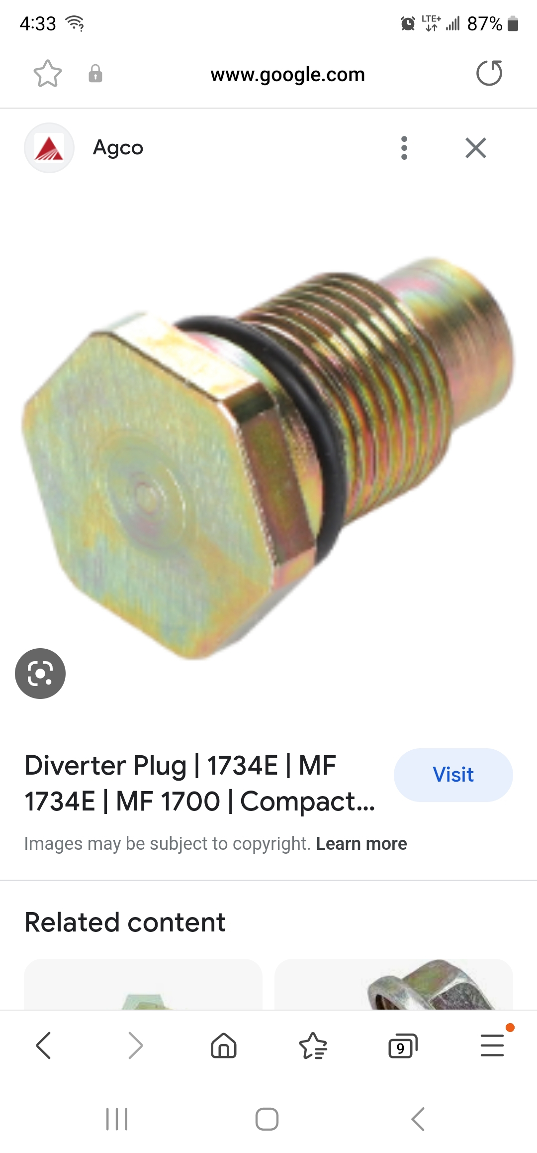

   / Power beyond not providing preasure for backhoe.
This is the diverter plug I put in.

   / Power beyond not providing preasure for backhoe. #5
Where or what is that diverter plug installed in?
Can you pressures before and after that plug?

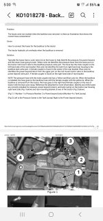

Number 3 of the fel valve body

   / Power beyond not providing preasure for backhoe. #7
Patrick
If you remove that plug does the valve body appear to be machined so that plug would block a flow passage? I suspect that plug is to isolate the power beyond port from tank galley in the loader valve.
That's what appears to be happening but I just followed the book and says to pull plug and add diverter plug.
#9
Alright , I figured it out. The diverter plug wasn't seated completely. Either the machining of the plug or valve is a bit off so had to torque the crap out of it to seat. Now just to figure the hydraulic psi out for my mf1533 to set the relief.
