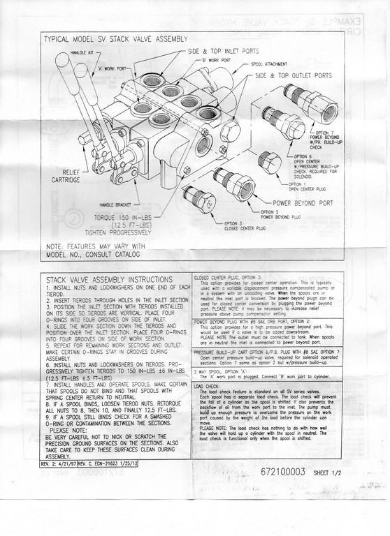

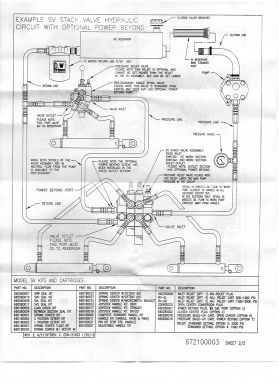

Maybe this will help. It's from Surplus Centers "SV" series stack valves and has the most complete diagram I've seen.
   / Power beyond and tank ports #10
Key is every individual valve stack or module has to have an outlet to tank. It is all part of the internal passages in the valve bodies. Tank lines can be teed together if only one connection is available at the tank. Tank lines are low pressure as that is how fluid gets back to tank when a cylinder reverses. Most open center valves have a plug that has to be inserted to activate the PB outlet, and normally sold as an option. Surplus Center's technical desk is very helpful. Use them.
