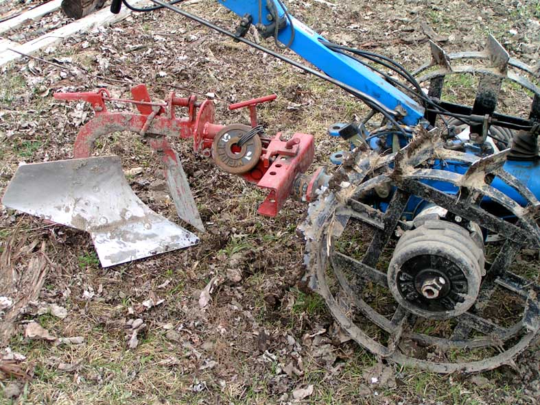

Hello,
I'm new to the forum so would like to introduce myself and ask for advice all in my first post. I have a small holding in Poland, where I'm busy setting up a garlic farm, been at it a couple of years and it's going well. I have a Fort two wheel tractor with I believe a Lombardini 6.5hp diesel motor,
4 fwd and rev gears with diff lock, I think the tractor is from the same stable as ferrari, goldoni and BCS it's italian anyway. I have a quality reversable single share plough with pre cut knife and would like to do some ploughing with it but have some concerns, the ground has been worked continuosly since time in memorial, but I only have 12 inch wheels but do have a tandem set, could I effectively plough with this set up? as all the videos I have watched the tractors all seem to have larger diameter wheels.

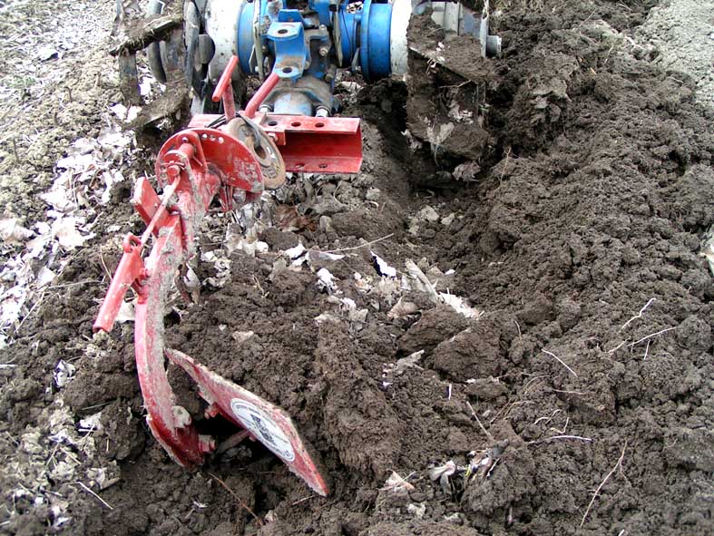

Hi! For plowing we need traction. BCS and Grillo are too light and need weight in wheels. I add 80 lbs for my Grillo. Second is grip tire chains are very good.Because chains are self cleaning. In wet ground tire grip come full and slip no more traction. Personnal! Tandem wheels are zero for plowing soil or snow . I make steel wheels ( Homemade.) Pads are 2 in.x 4.in Very good traction but not very good for grass. For you try with 100 lbs in wheels . and try tire chains. For traction tires chains are very good Good luck! Oldmech PICT0083ch2.jpgPICT0084ch2.jpg
