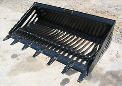

1- Initially I had decided to get a 60" - 66" rock bucket with teeth, to try and pick up the rocks I could on the first pass by just skimming the box lightly across the ground, probably slightly under the surface. Following example: Rock Bucket.png

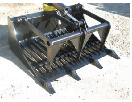

I might now would prefer a narrower bucket to make it easier to control the rock gathering. And a lot of folks on TBN seem to like the grapples a lot, as a general purpose gathering/carrying tool. So the following may be useful for several purposes, including rock gathering using the smaller bucket width: Grapple.png

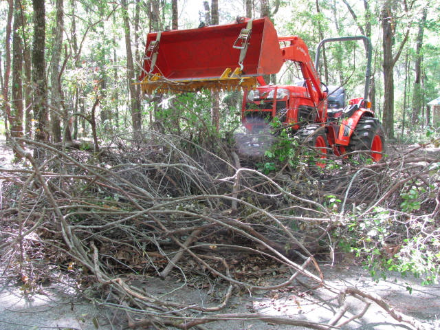

RE tying tractor to trees, there is the post on this site somewhere, with a newspaper article of a guy who had a tree go the wrong way. It flipped his tractor and killed him. The "push the tree" or "pull the tree" method is best used on smallish trees. With big trees it might be best to let them go where they want (i.e.leaning) or get a pro, especially since there are no buildings to damage on the site yet.

My Kubota B3300SU is an increment lighter than an LS R3039.
I do not think you will have enough FEL power for a rock bucket, heavy grapple nor stump bucket. All are HEAVY plus work beyond the bucket therefore lifting capacity is immediately reduced. There are lighter weight rake/grapples OK for your potential tractor~see LINK~but your tractor is still on the light side. Tractors are engineered to PULL NOT PUSH. You are asking the tractor to PUSH above tools.

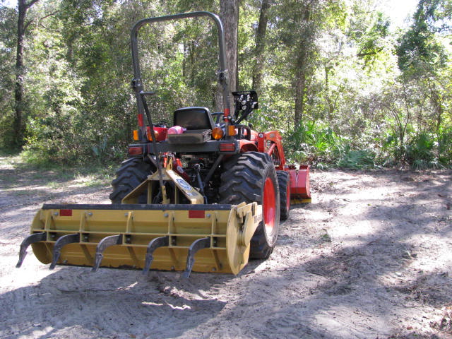

Consider a box blade of 600-700 pounds for your tractor, with scarifiers. The rippers will likely prize out the rocks you want removed and you can adjust the box height to pull large rocks along. ETA has well regarded box blades, just get a heavier model. "Rick" at ETA has given me excellent guidance when I have been unsure over implement selection. Tractors PULL box blades.
You can use the Box Blade with only one ripper, dropped all the way down, for your subsoiler. (Rippers are about $25 via Agri-Supply should you encounter an immovable boulder.)

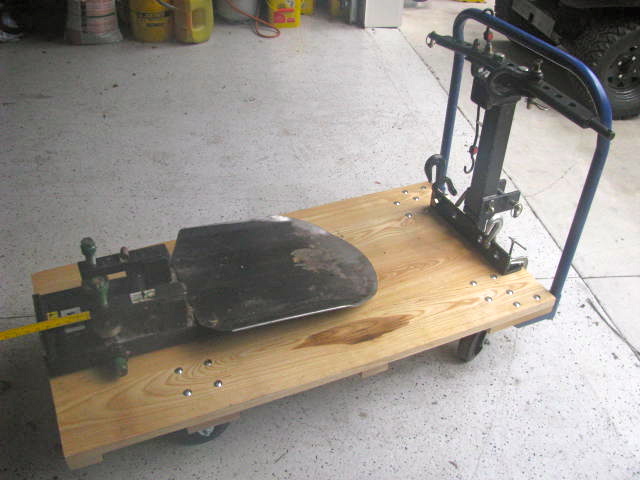

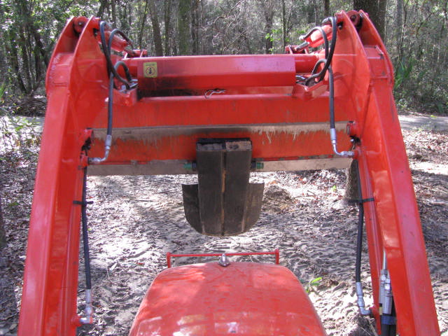

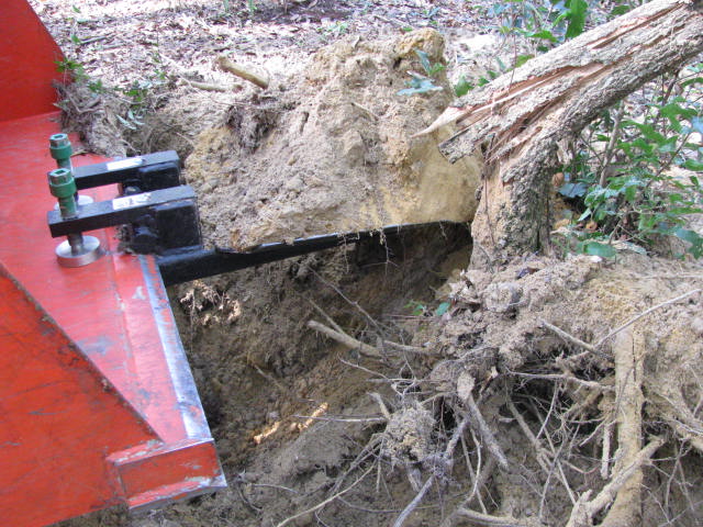

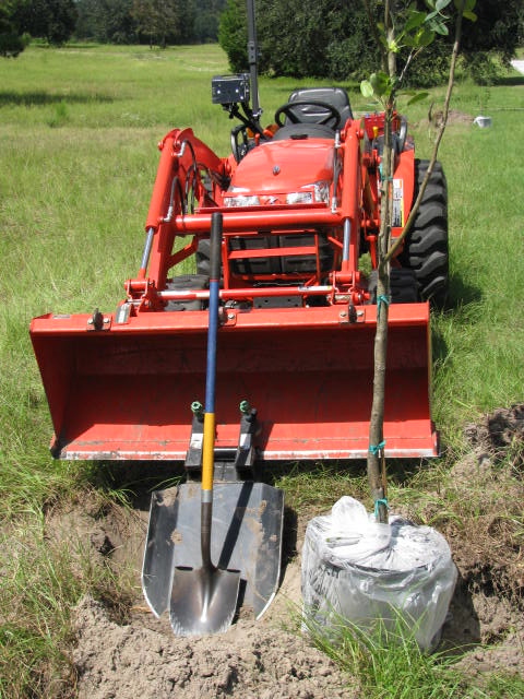

A Bucket Spade is efficient for preparing holes for trees. You can excavate 4" stumps too. Following vender also has a quick attach Toothbar which you may wish to consider. Popular alternate to generic Toothbar is a Ratchet Rake, pictured.
BUCKET SPADE LINK:

jeff9396, I did not see your attachments until now. That spade looks handy. But being a neophyte on these matters, I have been concerned about attaching devices to the bucket and having heavy weight combined with hydraulic power damage the bucket at the attachment points. Plus I think I may need more reach than this.
Any idea how these would work at the end on forks?
How thick is the steel? The web site does not give particulars. But the video is impressive.
   / Potential new LS R3039H owner with landscaping questions #8
Bucket Spade is designed so it can be secured over pallet forks. The spade is heavier built than any forks I have encountered, so forks would be the weak link.
I mount Bucket Spade directly on my bucket. There is 15" of support under the bucket, the pads are 4" in diameter and the fit is fairly close BEFORE you tighten the screws/pads with a wrench. When secured BS is integral to your bucket. I have not damaged my bucket despite considerable use of the BS; just faint paint scuffs where pads engage.
I have dug holes 4' deep, probably could go deeper by working in a circle but have not had the need.
In light digging you use the bucket hydraulics.
For heavy work you position the spade, then drive the tractor forward in HST/LOW with 4-WD engaged, pushing the blade into the ground. You have infinite reach and NO load on bucket hydraulics in motive mode.
An effective FEL tool for not much money.
(However, the 1,200 pound rated Platform Dolly was $299, delivered, from eBay vender. If Ratchet Rake was not presently on the bucket it would lie next to the Bucket Spade. At age 65++ I try to spare my back. I can pick up the Bucket Spade or the RR with the bucket, directly off the dolly.)
Bucket Spade weighs 110 pounds; A BEAST.

I pull a 630 pound Bush Hog (brand) Rollover Box Blade. Rollover Box Blades are an anachronism but I am prone to experimentation so I bought one. MtnViewRanch/Fit Rite Hydraulics is the T-B-N Guru on ROBBs, coincidentally. He has Gannon Earthcavators, industrial strength.
Nothing wrong with a Box Blade from ETA. I have purchased three implements from ETA, two built by ETA, with satisfaction other than minor quibbles about paint chips on 1/3 implements.
72" Category I&II XTreme Duty Box Blade by Everything Attachments - 635 pounds
In Florida sandy-loam this would work fine. With your rocky tierra it might stall out before filling, which would do you no good. Rippers engagement might anchor it; no good. Price proportioned to weight.
Perhaps this one:
Everything Attachments 66 XTreme Duty Compact Tractor Box Blade - 377 pounds
Hydraulically operated Top Link will allow you to easily tilt BB for max bite with the box. This may compensate for what I consider light weight.
I would discuss your soil and tractor with "RICK" I have followed his advice and been happy. His advice for final selection would be more valuable than mine. Really.
I would NOT want a Box Blade wider than the rear tires. Full or empty Box Blades are ponderous, inhibiting tool behind you. ( Think Jaws ) ETA is the only supplier making a 66" wide Box Blade. (Smart positioning.) May be ideal width for your contemplated tractor.
Consider implement weight per foot of box width, not gross weight of implement, for good performance.
