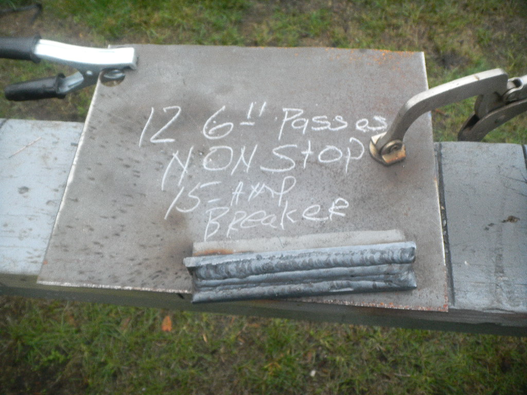

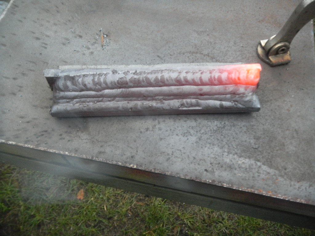

If I were you, I would look into the Everlast Power I-Mig 140E. Then contact Mark with Everlast to see what kind of deal he can make you. You can run Lincoln's .030" NR-211 self shield flux core for outside work and Mig for inside work.
I ran an endurance test with member here roadhunter's I-Mig 140 on a 120-volt, 15-amp breaker.

bjr here is what that Everlast Mig machine can do with Lincoln's NR-211 self shielded wire.
