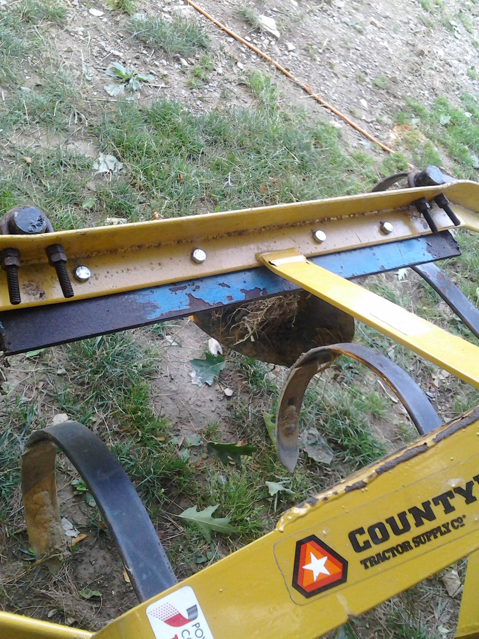

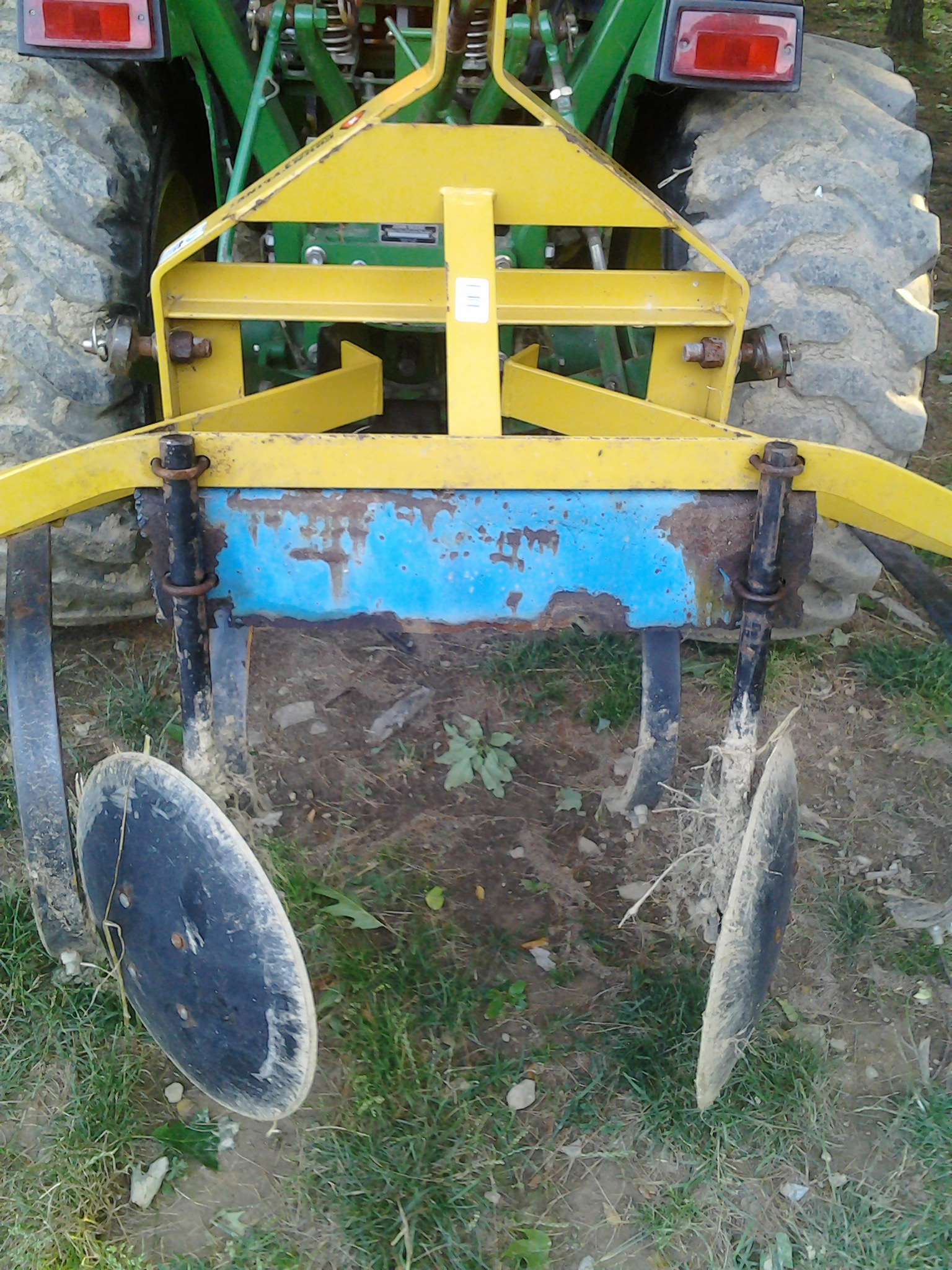

Pictures of my potato hiller mod were asked for by several people. At the time I had no camera. The cultivator/hiller is at my BIL's house because he plants the potatoes.
I used part of a Freightliner frame, U bolts and shanks with discs for the modification.
The u-bolts were ordered here: McMaster-Carr
The discs and shanks were ordered here: US Small Farm - The Good Name In Small Fields - Potato Hilling Disc
