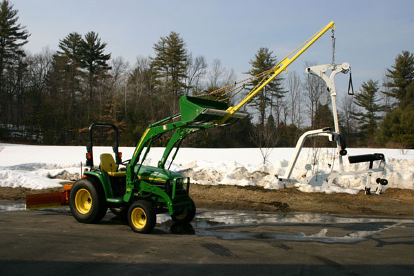

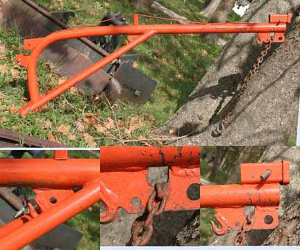

I like picture to help me think of project ideas. Post your pictures of your boom pole here. If you are looking for ideas, this kind of post helps you cover a lot of ideas in a few minutes.
A few ideas that were incorporated into my pole:
1. Fits a Cat I SPEECO quick hitch. Fast to install.
2. Plate at end with keyhole for chain. Chain has grab and slip hook, and can't fall off.
3. Plate has a grab hook and holes for my shackels.
4. The receiver hitch at end can be used with my 5' stinger for high, light loads.
Docheb, Spencer, and a lot more of you have done some really good work. Post your pictures here. I hope to adapt this to fit by FEL Bobtach.

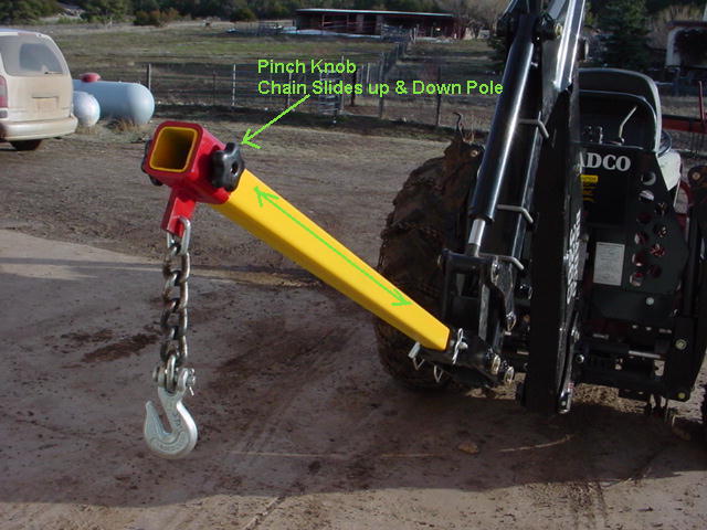

Here is my adjustable boom pole attached to my Backhoe

These first two are really cool. I like all the attach options you put on yours JRP, and the slding chain on GuglioLS's would be really handy, not to mention it's neat to be on the BH.
I don't have a good pic handy of mine, but it's just a stock one with a hook at the end, and one near the middle. Nothing special. John

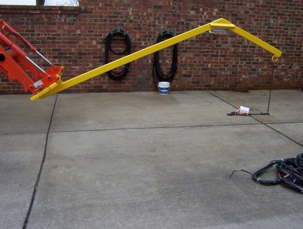

Here's mine for the other end. I really like the backhoe version, I'll have to add that to my to-do list! /forums/images/graemlins/smile.gif

   / post your pictures of your boom pole
45V I like yours a lot. It fits the KISS model but has good design elements like the strongback. I want to make one for my FEL.
Thanks for posting.
