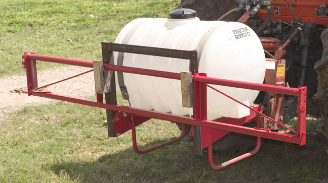

Share your "build it yourself" sprayer photos on this post.
I built this spray boom. The design requirements were:
1. No tools to install.
2. Folds if you hit something.
3. Spray with center section or all three sections
4. Fit in a pickup.
5. Light enough for one man to handle.
6. This one is 21' unfolded.
7. Proper spacing and heigth - minimal drift, good coverage.
8. Uses standard Tee-Jet components.
This is the sprayer tank. I added an angle frame with two wooden hooks. Hooks are suppost to break before the boom bends. I need to paint this.

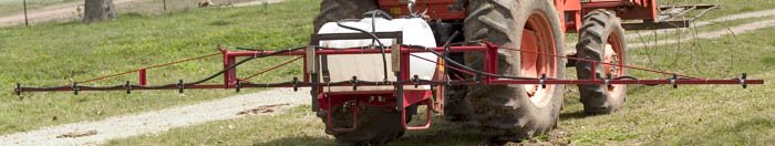

The center section uses 1 1/2" EMT conduit at the top section and 1 1/4" square tubing as bottom. EMT pivots in the wooden hook if the sprayer snaggs something. 1 1/4" is a standard size of metal tip brackets.

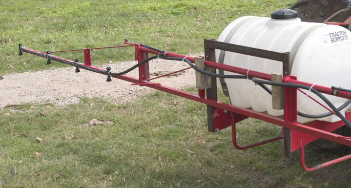

A wing is added to each end with industrial door hinges. Total width 21'.

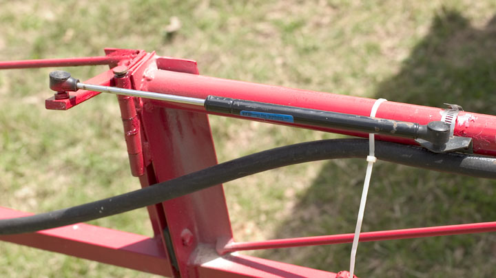

The hinge is not vertical, but rather points forward. This makes the boom wings want to stay folded out or stay folded by gravity. I also use a gas filled cylinder on each side. This is the shock absorber thing for your SUV hatchback. It dampens swinging and keeps boom straight.
This thing is cool. When I bump a tree it just folds up, and unfolds when it has passed the tree.

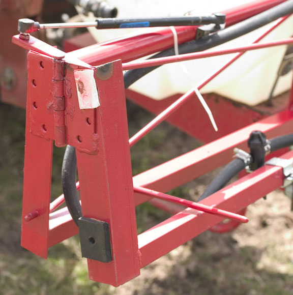

This view shows the gas shock and wing folded. The force of the shock also acts to keep the wing folded.
The rubber block and pin help prevent the hinge from twisting. Actaully, a longer hinge would be better.

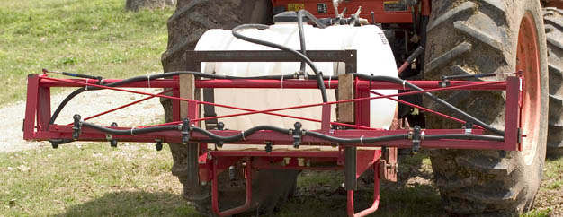

This is the assembled rig. The sprayer tank came with one big brass five nozzle thing that was suppost to spray 30'. It sprayed very wide very very poorly. A recepie for a drift lawsuit.
I tried my rig before I painted it. The coverage with the good quality tips was great, and drift was not detectable. The weed kill was vary complete.

In a few seconds the wings fold. With two flow valves I can spray all, or the center section only which is just right to put roundup on the drive.
Once the two banjo fittings are loose the boom just lifts off the wood hooks. It stores on two nails in the shed.
This has been a very easy and rewarding project. If you have a smaller tractor you could scale it down. There is no heavy loads so it is a good practice job for your welding skills, and the lack of thick metal make it good for smaller MIG welders. Use good quality spray tips. I like Teejet XL. Wylie sprayer makes and sells big big big spray rigs. 800+722-4001. I visited their store and got all the parts at prices less than TSC. They know sprayers. www.wyliesprayers.com
