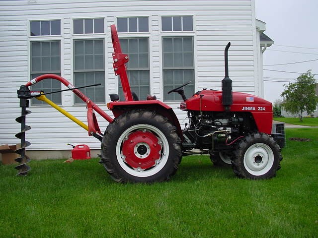

   / Post Hole Diggers #3
I purchased a PHD from TSC last year and so far it has worked great. I augered over 100 holes with it. I busted quite a few shear pins but thats what they are for.

   / Post Hole Diggers #4
John............ your Jinma probably weighs about twice what the BX1500 weighs and the front tire is larger than the BX rear tire. Your three point hitch is probably higher when it is down, than the BX when it is up. Other than that, I guess that you could say that the Jinma is equal to the BX in all other comparisons.... LOL.. /forums/images/graemlins/grin.gif /forums/images/graemlins/grin.gif /forums/images/graemlins/grin.gif /forums/images/graemlins/grin.gif
