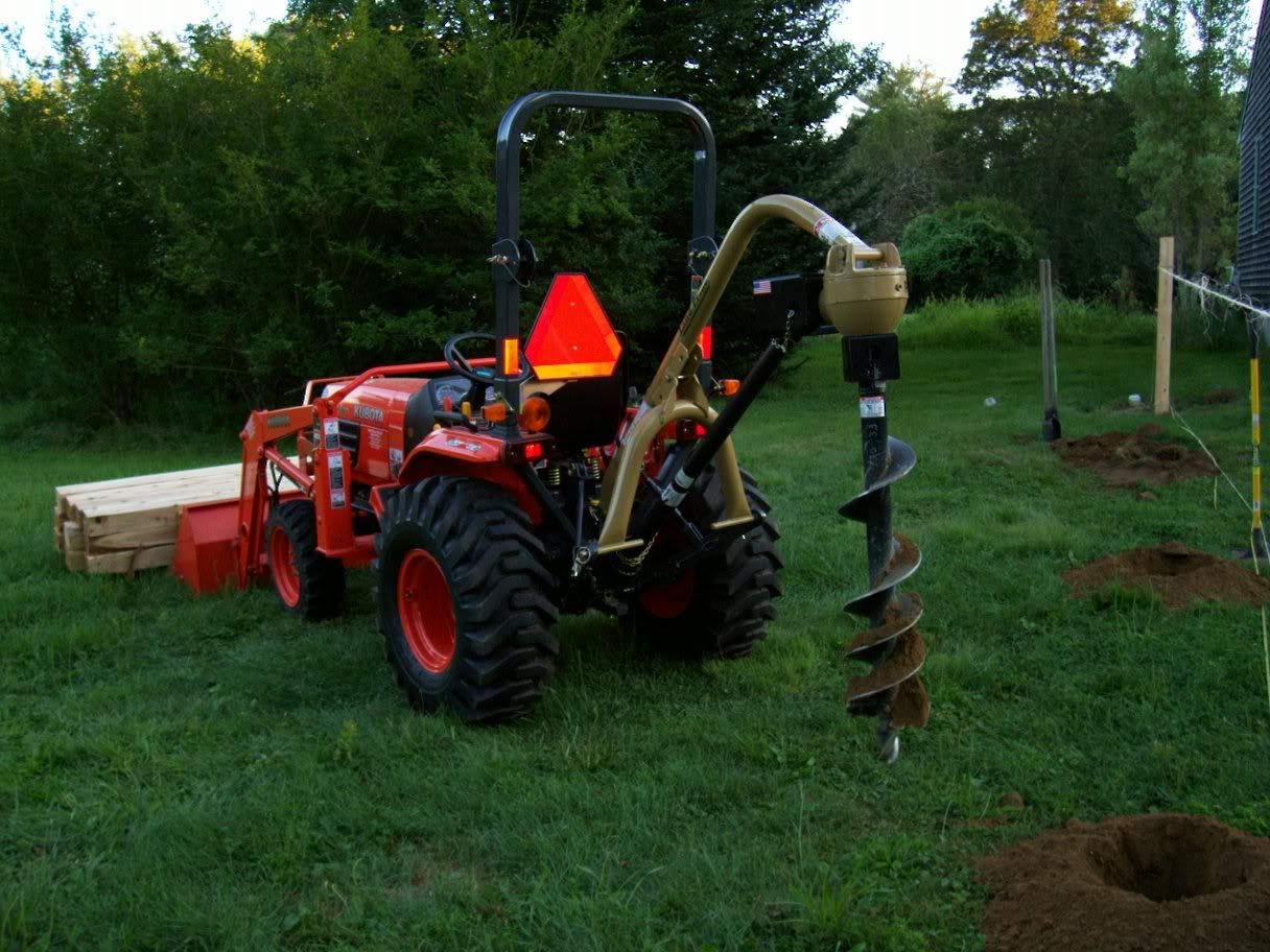

Two man augers just flat "SUCK"! If it's bouncing..Id say either the speed is too fast..or the "feed" is too fast ( to much "bite"). Run is relatively SLOW...bore a short distance and then pull it up to clear the dirt..and then go at it some more.
I can borrow one anytime I need one so I havent bothered to purchase one...and the only problem I had was clearing the ground with my B3030....it was REAL CLOSE and the dirt piled up around the hole kept hanging me up when Id pull it out to move to the next one.
