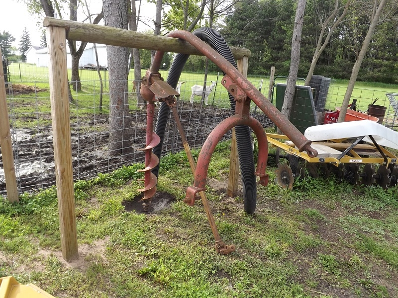

My machine is 31Hp engine and 26Hp PTO. Your machine has the power .... HOWEVER,
The key isn't just having the PTO power. It's the ability to raise and lower the PHD up and out of the hole and then drilling down to make the next hole.
SCUT and small height profile rear wheel on tractors prevent from ever using a PHD on a machine. So keep in mind the tire profile height and the 3PT lfit distance. It all matters.
This wasn't my design, I seen PHD mount a few ways, and this goal post method is the easiest to make, to use and cheap !

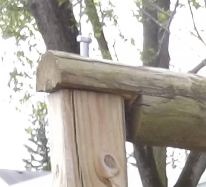

The top bar has 8-inch long lag bolts that sit in holes at the top of each post.
Take the top beam off, back the tractor to center the PHD. Raise the 3PT all the way up. Slide the top beam under the PHD elbow. Place the lag bolts in the 2 holes. Lower the PHD. Disconnnect from the tractor. To mount, the PHD just do the reverse. :)

Great post. Thanks so much. I do like that design. I have mounted the post hole digger with everything on it but the auger and it lifts up and down fine I will be trying it next week. Will keep you posted. I think I will build that goalpost like that it looks like a good idea, thanks again I will not be attaching the hydraulic assist on this tractor
