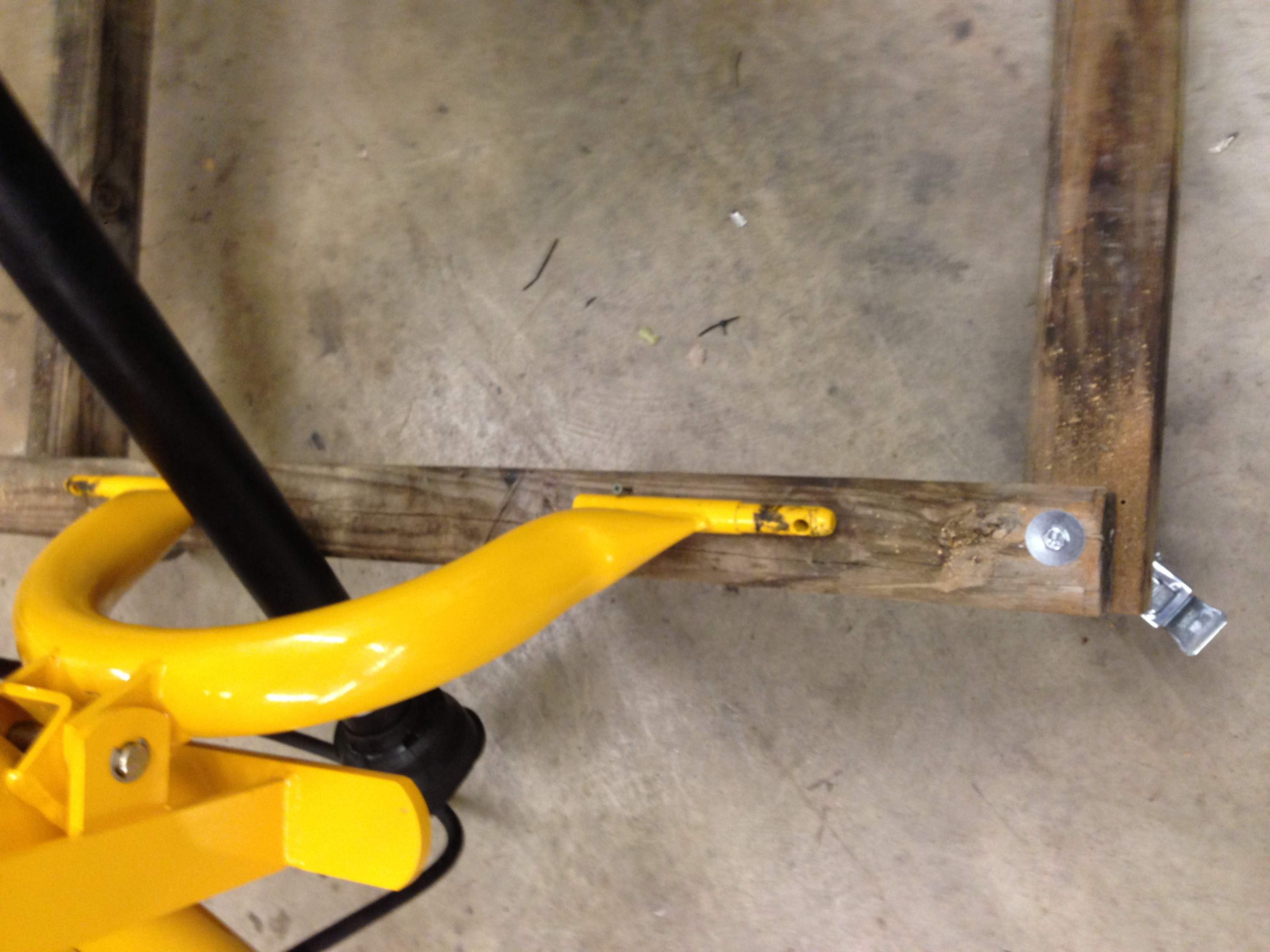

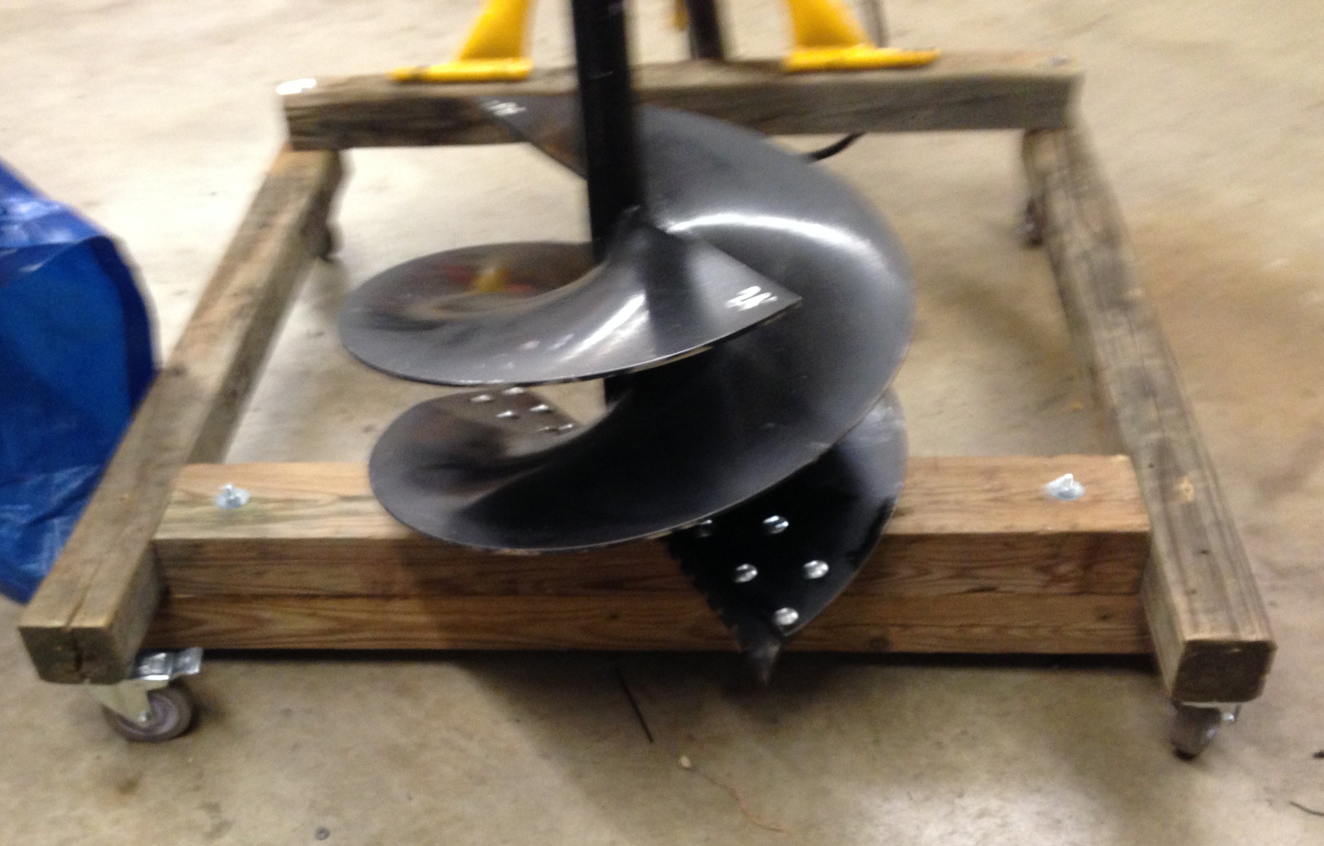

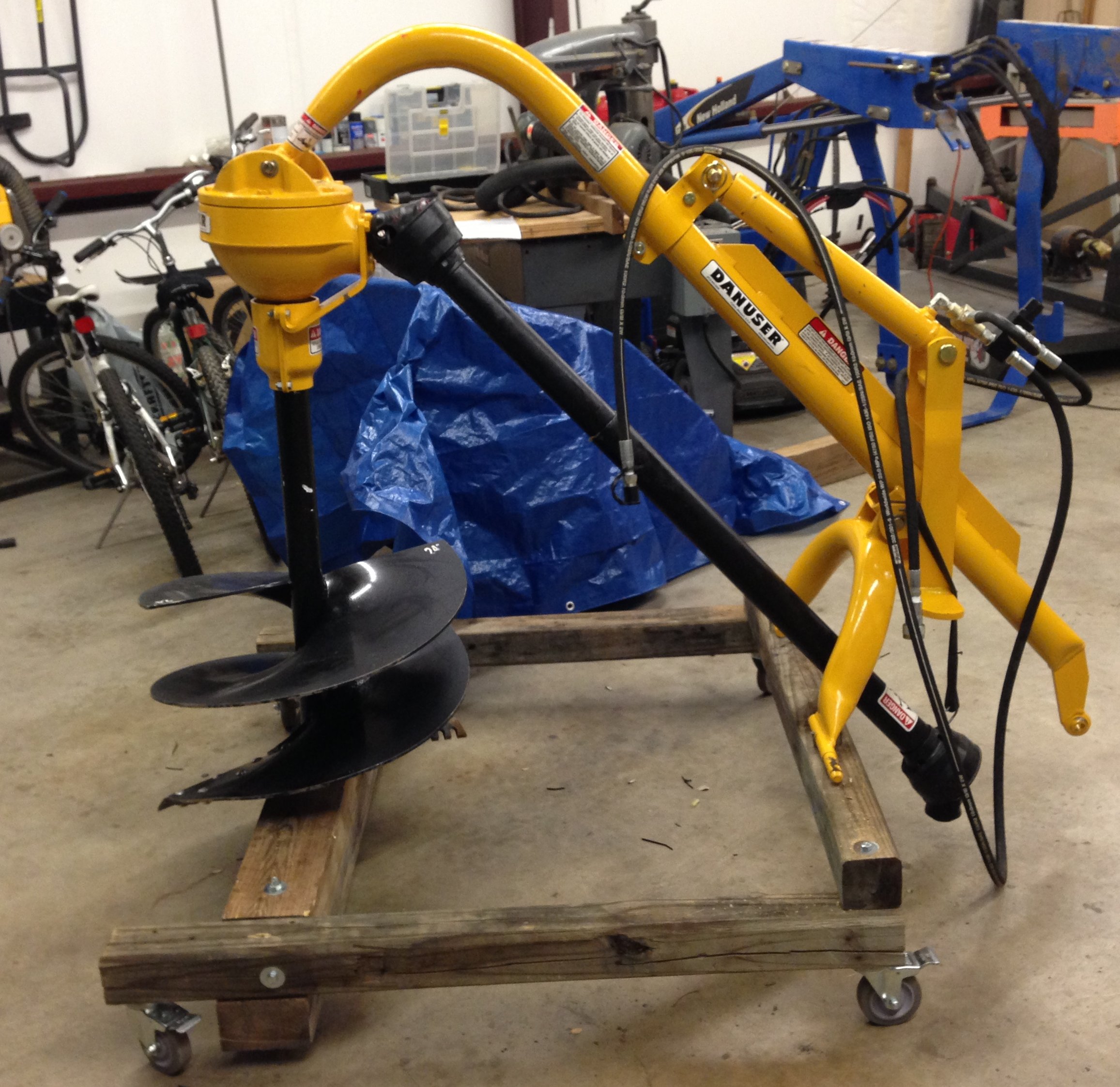

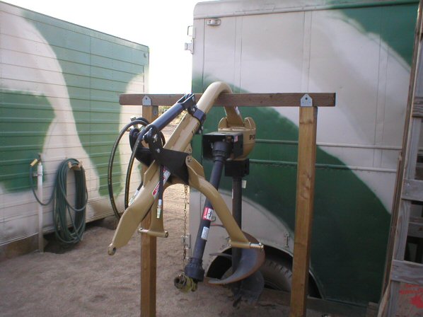

I've seen a few other PHD stands here and most fall into the category of either "hang it up" or "drill a hole in the ground". I threw together one that combines both. The auger fits into a 2 1/2" hole I cut through a couple of 4x6s. The hitch pins rest on a 4x4 with a couple of decking screws to keep them from sliding forward or backward. The wheels are 4" casters with external brakes and rubber tires that do a great job of holding the setup in place.
Most of the stand was constructed from lumber left behind by the house's previous owner. I spent about $85 on the casters (castercity.com) and probably another $15 or so in bolts.
To attach the PHD to the tractor I support the front of the PHD with a couple of 4x4s under the hitch pins. I'd like to integrate that into the stand; I'm thinking some sort of flip out legs, but haven't given it a lot of thought yet. Any suggestions?
Thanks.

I don't trust the deck screws. Looks like you could drill a hole down through where the hitch pins go in the second picture. Then drop a bolt through those to hold it.
/ Post Hole Digger stand #3
I like. I'd add a small piece of 2x4 on either side of the wood were the hitch pins rest so it couldn't slide off. Other than that - looks great!
Thanks for the input. I've got a few lag screws hanging around - I could probably use those rather than the deck screws. Admittedly the deck screws were a last minute addition :rolleyes: I could then use the deck screws to hold down the 2x4 pieces on each end (owner left some of those too).

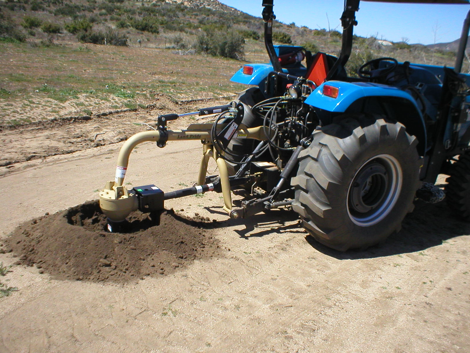

Do you think the down force is really needed? ! :)
Depends on the ground. Before I bought my down force unit for my PHD, I had holes that would take days to dig. Ground was so hard that water would be in the hole for days. I am usually a weekender. When I need things done, it needs to be now, not tomorrow or days later. Bought the down pressure kit for my PHD, I have not had ANY hole take longer than 2 minutes to drill since that purchase. One of THE BEST investments that I have ever made. Makes no difference in hole dia either, and I have bits from 6"-24".

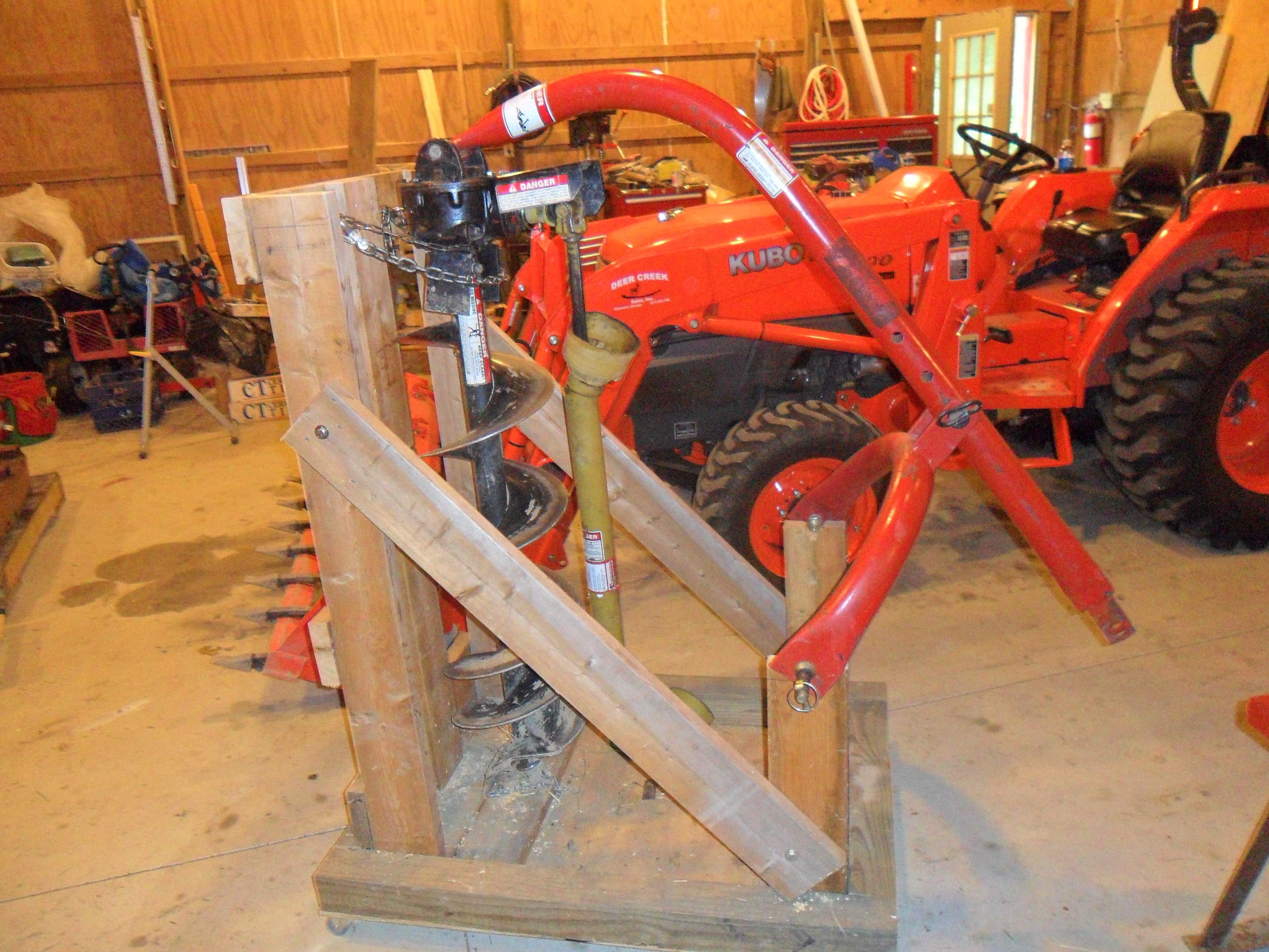

I tweaked the stand a bit by adding an upright support. This makes it easier to hook up. A tie-down hooks to the lag bolts at the top of the upright to keep the PHD from sliding forward.
/ Post Hole Digger stand #16

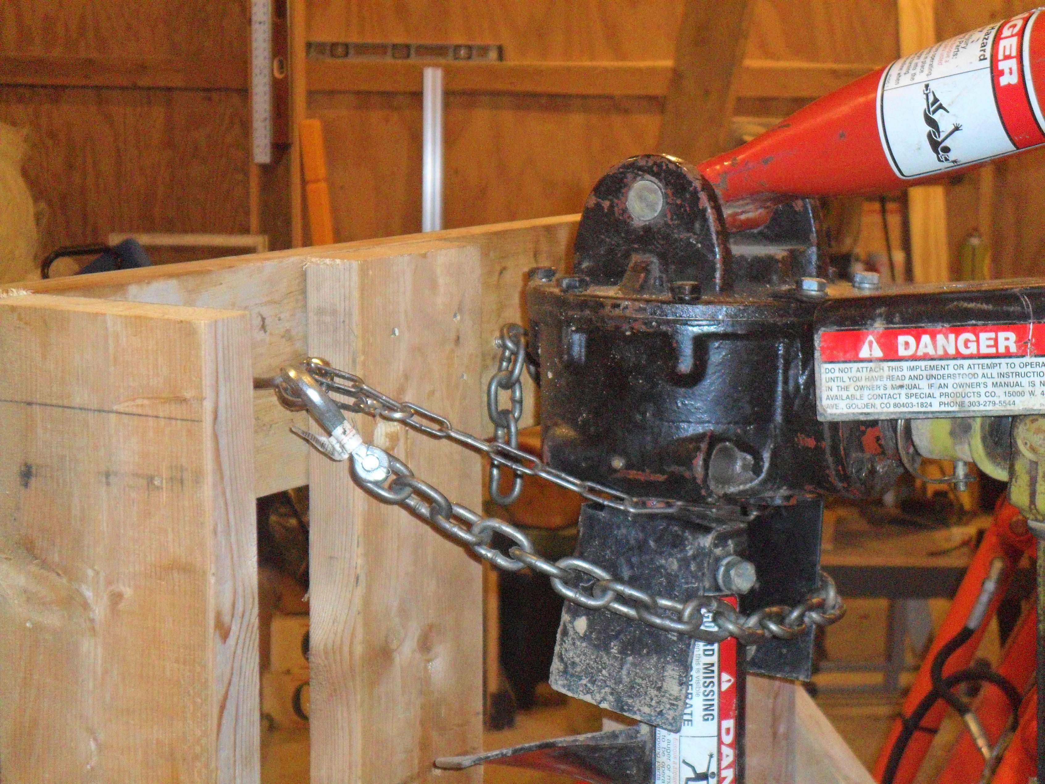

I did things a bit different, I put the support next to the auger, I have a chain that I hook around the gearbox. This keeps the auger from moving, left, right, or down, because it's pinned against the vertical. I have 2 more verticals that support the 3 point pin arms. I can hook this thing up in a couple of minutes. I'll try to post a pic.
When I put it on, I roll it up to the tractor.
1) I put the pin thru the mast into the bracket on the tractor.
2) I hook up the lift arm pins, secure them.
3) I connect the power shaft. ( with the engine off )
4) I release the chain from the gearbox.
Now it is mounted, and can't go anywhere, then I start the tractor and lift the auger out of the cradle.
To put it away. I reverse this procedure.
