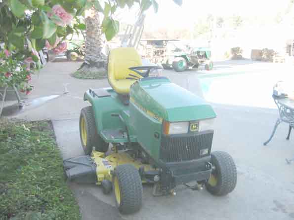

This is the new to me John Deere 425 48” Deck, 3 pt and 26 x 12 x 12 Bar tires coming. It is the replacement for the 325

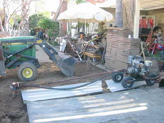

This is the Little Beaver Post hole digger – 8 HP Briggs, Flex cable drive and gear head

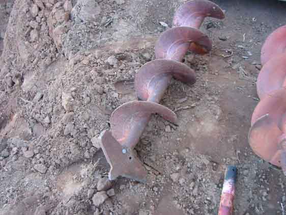

This is the 11 inch auger. It has the fish tail lead, but I will need to get the two hard surfaced lead bits that fit in the slots.

I'm very familiar with the Little Beaver products. I have and use often the Little Beaver Hydraulic unit.
Your larger auger has the Pengo head. That's the system I prefer. The ones I have are fitted with carbide pieces on the fishtail and flite teeth. The good thing about this system is your options as far as teeth for the earth situation are almost unlimited.
The next size down one is fitted with Beaver's idea of a rock bit. It works okay in sandstone if you're not in a hurry.
Your small bit looks to me as one that won't fit your auger at all. It appears to me to be a Ground Hog bit out of San Bernardino. They use their own fishtail and Pengo flite teeth.
I wouldn't mess with the system and use it as is. Probably the best reason is the cable drive is only really strong enough to dig based upon the typical man's capability strength wise. On a tractor it'd be prone to die or slip immediately if not sooner.
One thing about the Beaver, besides it being the best one man systems I've ever used. I'm not much on the cable drive though.
But NEVER EVER operate it without the torque bar in place and functioning properly. That puppy is about as friendly to your well being as a ticked off alligator in your bath tub if it's not in place and functioning properly. I can't over emphasize this enough. NEVER EVER is too often. It will hurt you, permantly crippled kind of hurt.
