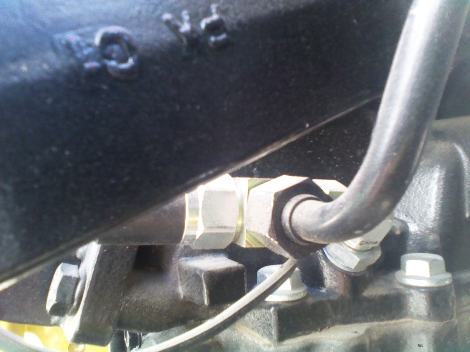

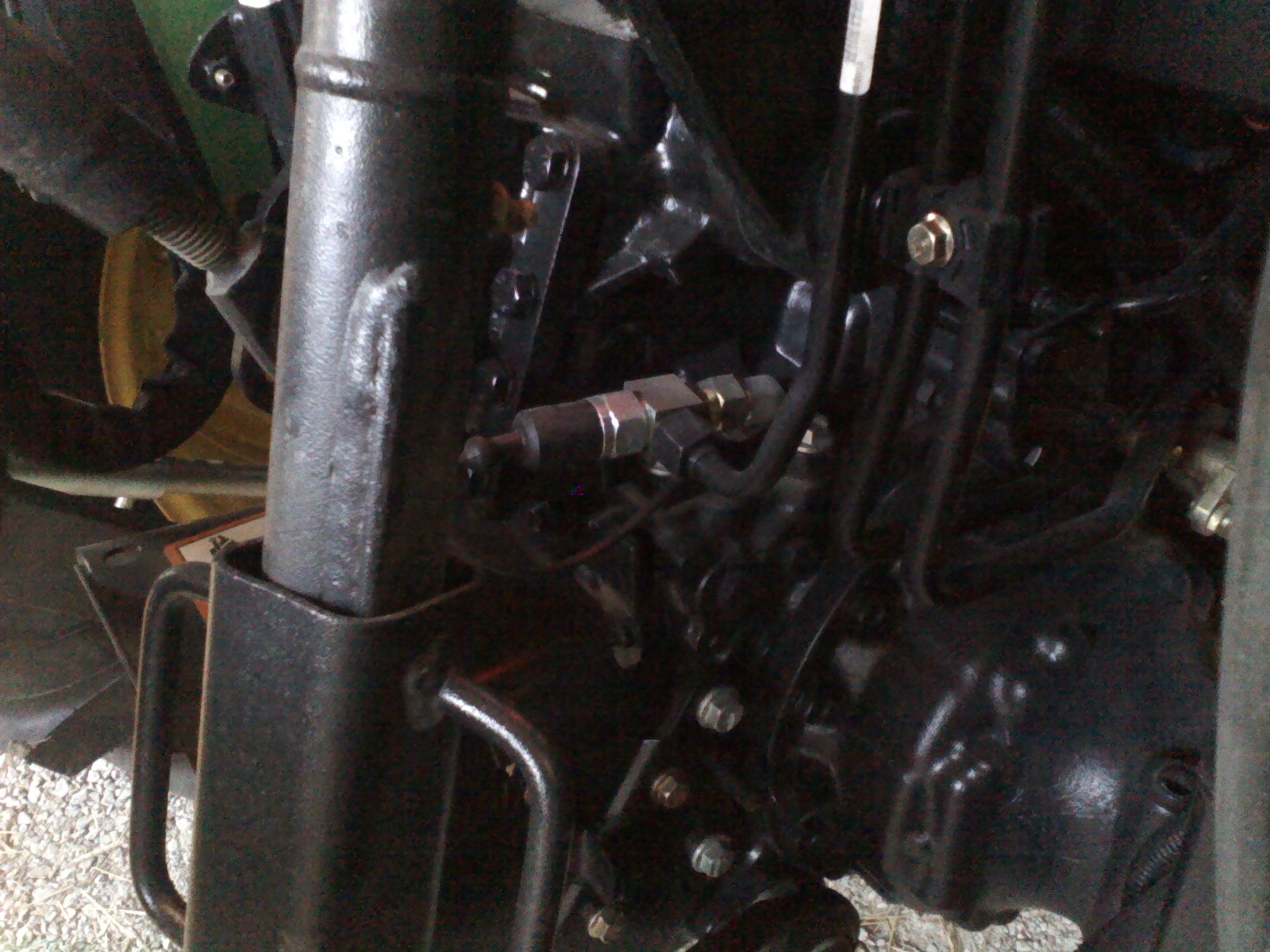

Recently purchased a down pressure kit to fit my PHD. Both Frontier products from Deere. The installation of the HDP is straight forward except for the return line to the hydraulic tank. Naturally there was no instructions included. The dealer (Washington Tractor) hasn't yet been helpful with instructions or how or where to connect this line.
I have a JD 4520 Compact.
I have identified a plug on the upper portion of transmission that appears that I could remove the plug and tap into the reserve there. That is just a thought.
Any ideas?

That should be the right spot. That is where my 4th and 5th SCV tank port goes on my 2012 4720, and the power beyond tank port. Here is a parts breakdown of the power beyond. You can see the main parts 23, 7, 14, 15 plus the misc. o-rings. That would get you the quick connect, and all.

Thanks for this recommendation. If you could post a close up picture, that would be most helpful to me.

Ask and you shall receive. From 2 different angles.

Isn't technology great. Thank you. I am on the right track.
