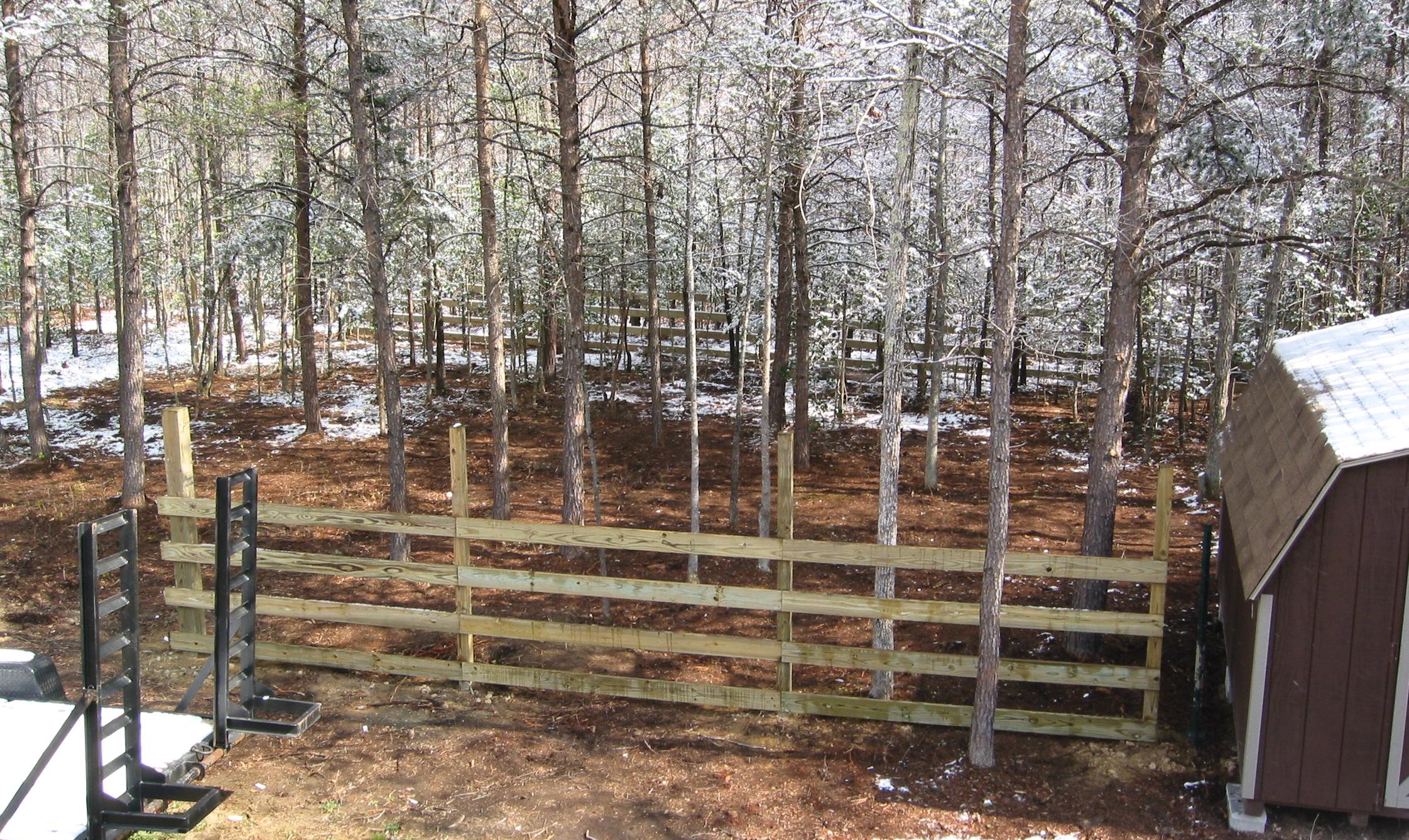

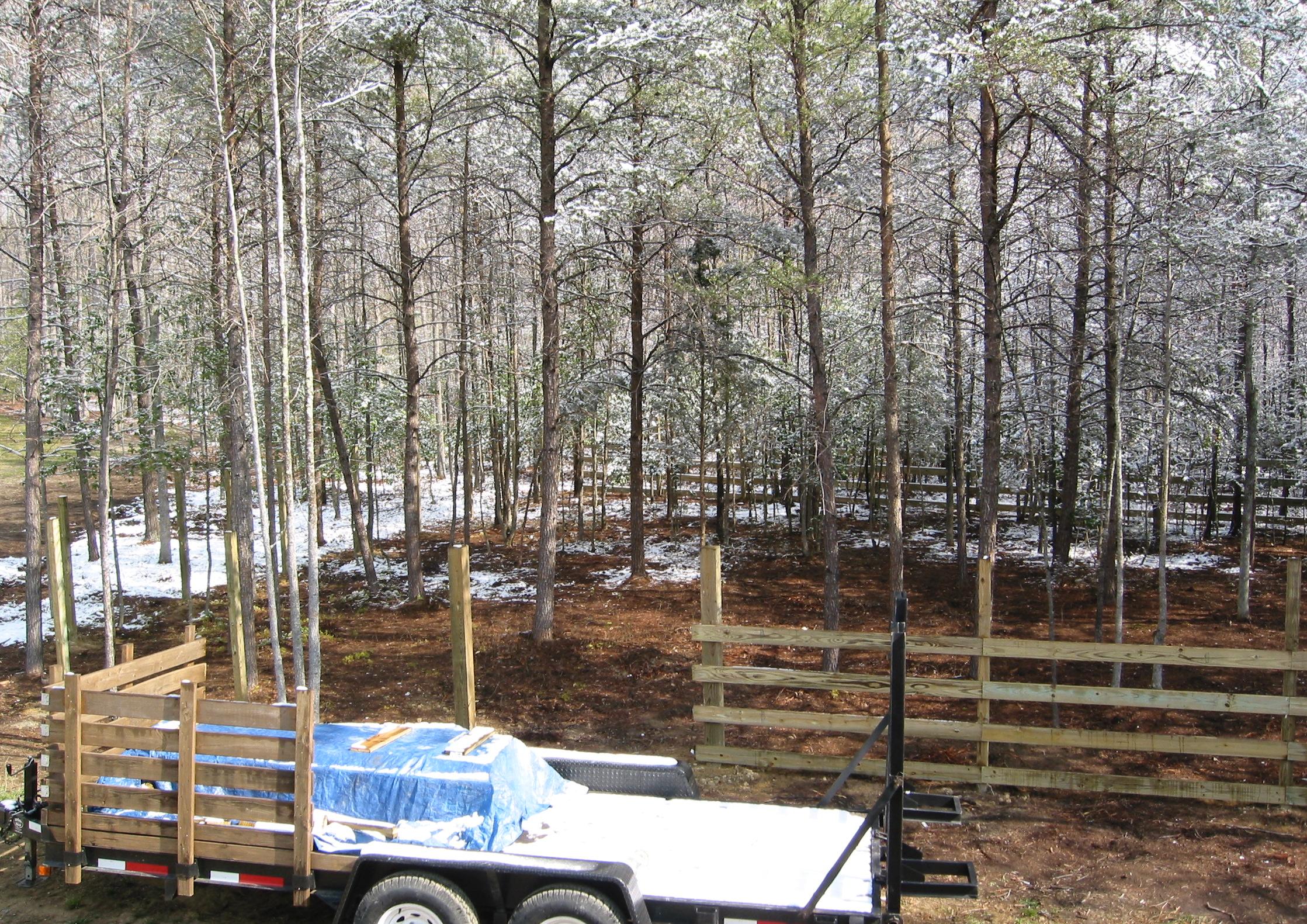

For the 10th of an acre dog fence, I went with a wood horse type fence (the dogs are small horses -- great danes). Almost finished but got caught in some freak snow today.
I'm still considering the 440 for boarder fence.

/ Post Hole Digger Options? #18
I would have put the planks on the inside. Horses scratch there fat asses on the planing and knock it off. The also kick the boards off. always plank inside the paddock
