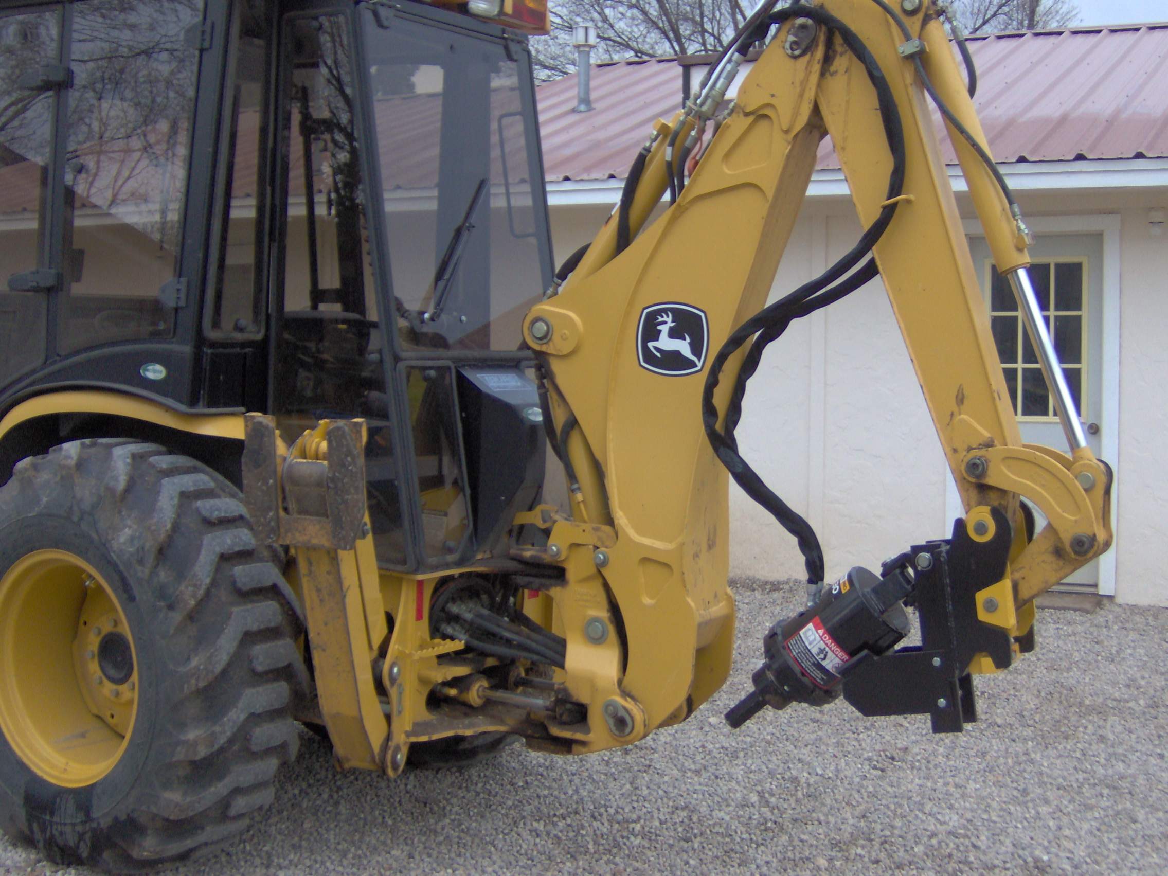

I would like to add a hoe mounted hydraulic auger for fence posts on my Deere 110.
Tractor does not have Rear Remote... only front remote.
The simple way would be to forget about using the backhoe and mount the auger on the loader with 12 gpm available.
Optimal would be a hoe mounted auger to allow access to the berms and hillsides.
Any pictures or suggestions?
Anyone use an Auger with the 12 gpm front remote vs the 16 gpm rear remote... which I don't have?

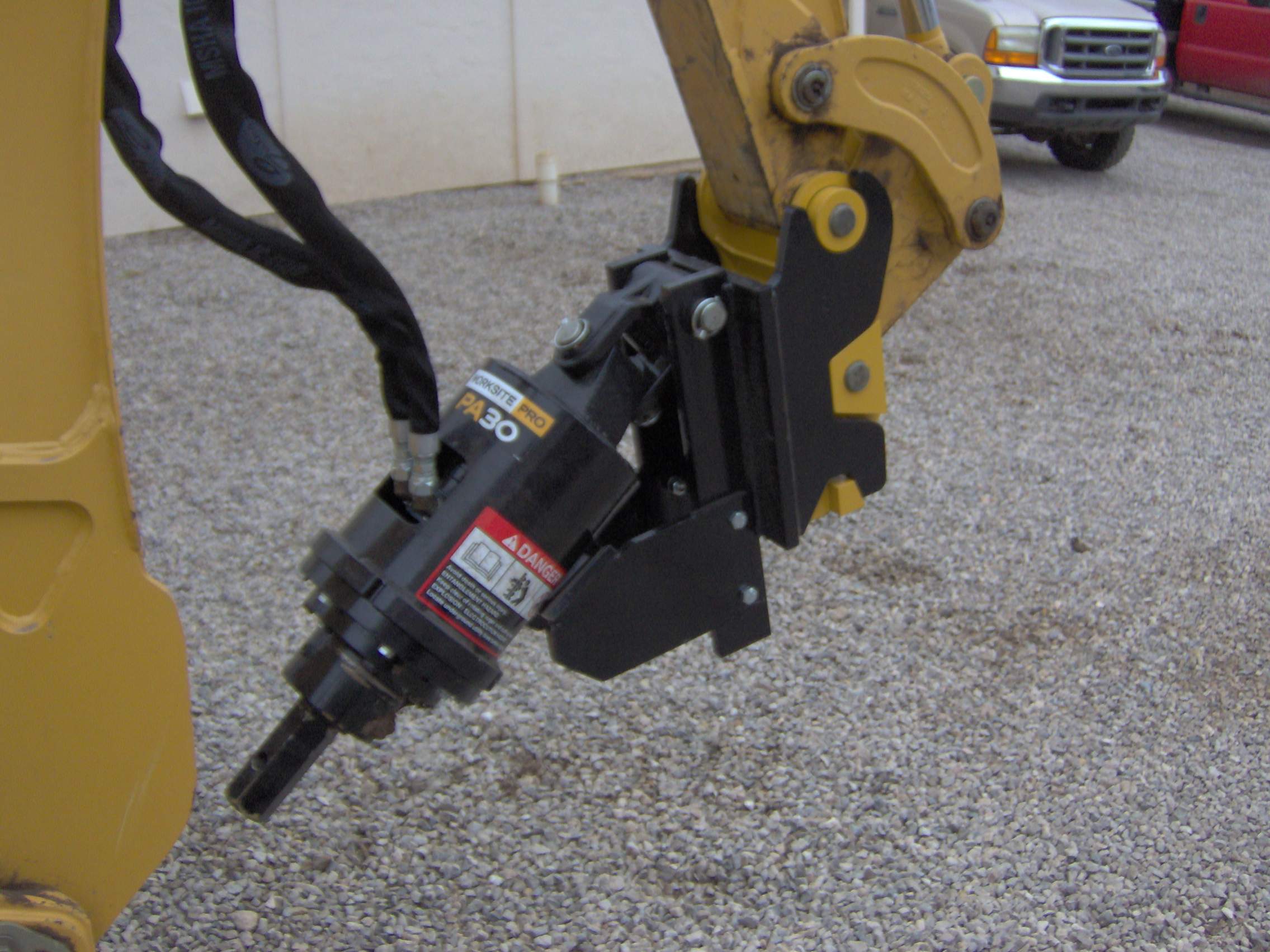

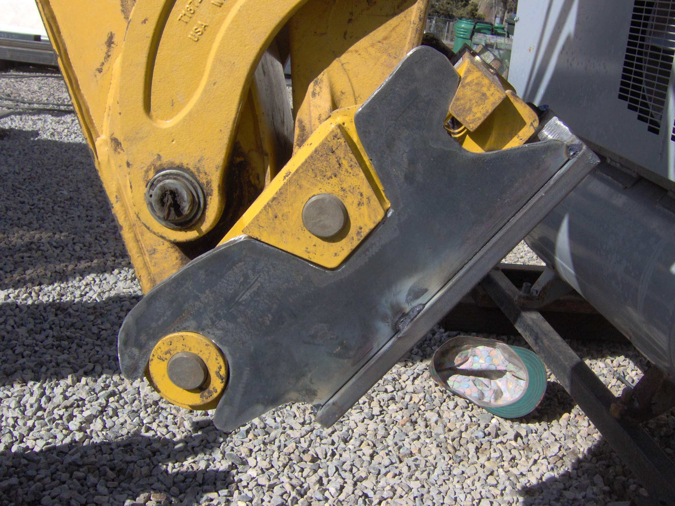

Here are the pics I have as mentioned in the pm.

   / Post Hole Digger Options for John Deere 110
Worksite Pro 30...
Looks like I would have to make an adaptor and find an auger rated for 12 gpm.
Thank you very much for posting!
