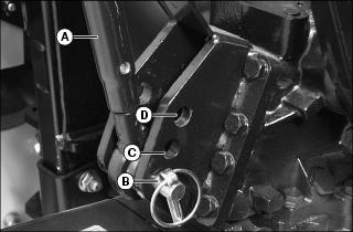

The top link could be in the wrong hole. I believe the lower the hole the higher you can lift an implement.
Actually the PHD boom attached directly where the top link goes. The pivot point for the boom is on the u-fram that attaches to the lower 3PH arms, so the lower you attach the top link connection, the higher it will lift. It is in the lowest position.
