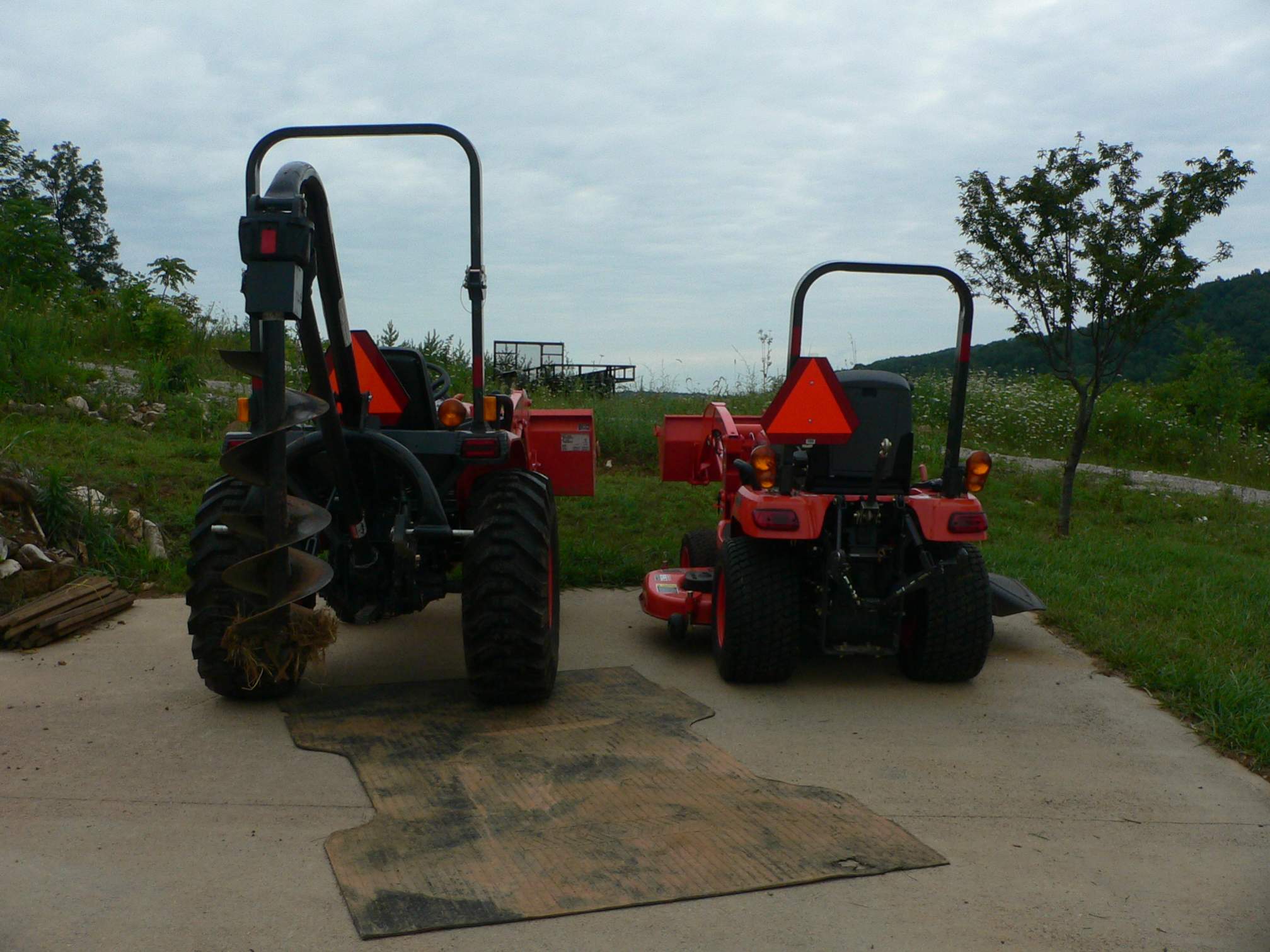

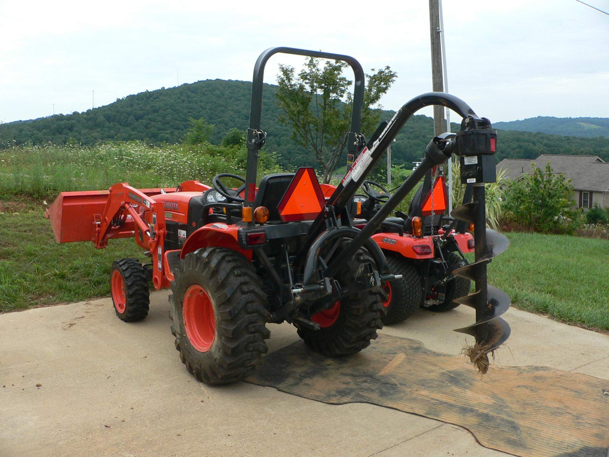

I bought Lowe's left over trees for one price a few months ago. There were 50+ so I "had" to buy a posthole digger. Bought mine from Barlows and not sure if it was $500 or $600 new. Call or contact Barlows and they can tell you brand and price. I may have pictures and will post to this if I do. Dug all my holes and my brothers and a hole for a neighbor for his mailbox. I bought the 12" auger and I also have clay and rocks. Dug about 10 more holes a couple of weeks ago for some trees I'm going to plant soon. You will get informed that you need a BH for planting trees and you need to make holes really bigger than PHD etc, etc. I did PHD and they are doing OK for left over 1 year guaranteed trees. My brother is a certified Master Gardener and has a magazine cover yard and he grinned at the don't use a PHD for trees stories. I would use a BH if I had one, maybe but for 50 trees I doubt it. PHD is alot cheaper than BH.

I forgot to add the pictures. Here they are. Zoom to see detail.
