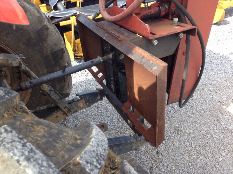

Just finished driving a few posts for my sorting lot. Should have done this about a month ago...man the ground got hard.
Driver is a Shaver HD 10. Didn't have a lot of trouble even though the ground was hard.

We've had a Shaver HD 10 since around 2003. It's driven countless miles of fence. In that time it has only needed springs, a cylinder end cap, and a few welds. I tacked the nuts to the bolts where the driver mounts to the three point frame, no amount of Loctite would keep them from vibrating free.
I like this one so much that I bought another gently used one recently. It has the hydro tilt, which should make life a little easier. Looking forward to getting around to using it.
