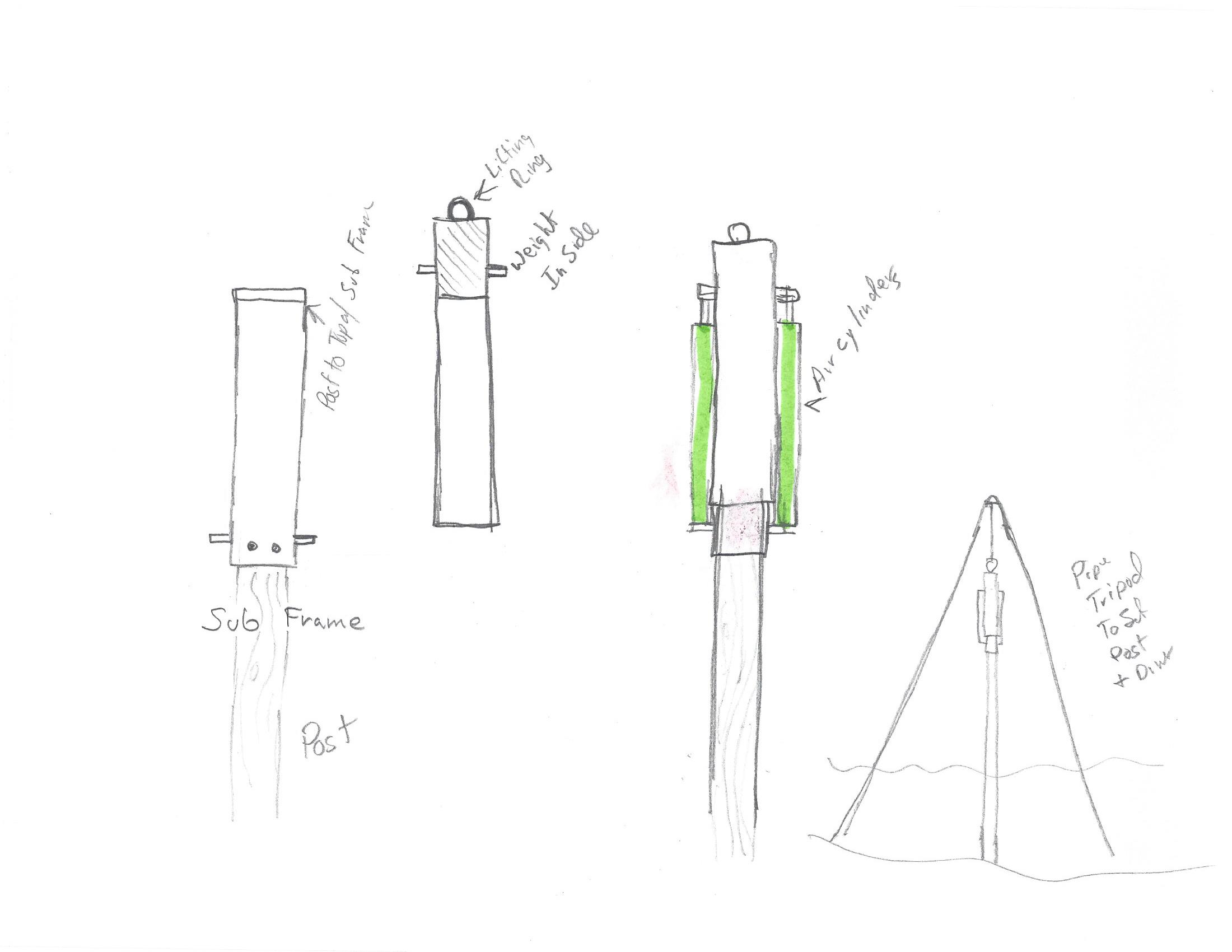

Just a suggestion, if you look in the post I did before, 98E Basic T- Post Driver, T Post Driver, Post Driver, Fence Post Driver - Rohrer Manufacturing look at this link,
what is interesting about this driver, is (if you look at the bottom "YELLOW" part, this attached to the post to be driven by a "T" handle screw, there is a weight, and a small air cylinder on the side and a switch/valve,
you attach to the post, and it is self contained, The AIR cylinder pushes up the weight, and at the top it is reversed and helps slam the weight down on the yellow sub frame,
what I am thinking is make a sub frame that can be bolted to the post to be driven, on it a air cylinder with a weight and over frame that guides the weight, (a hand valve could be used to raise and lower the weight via air cylinder, (the manual cylinder would not be as fast as a automatic valve), but it is self contained and attached to the post, do to the size of it a set of twin cylinders one on each side may be needed to make it smooth and not bind,
since it is all self contained on the post, one would not be shaking your floating dock, or boat your working out of,
and would not need a large compressor to use it,
my to cents,

Wouldn't it be a fantastic improvement if, somehow, the driver did not have to go over top of the post? For instance if the driver could clip on from the side, engaging with the post firmly to dive it. Then the heavy driver wouldnt have to be lifted up so high.
