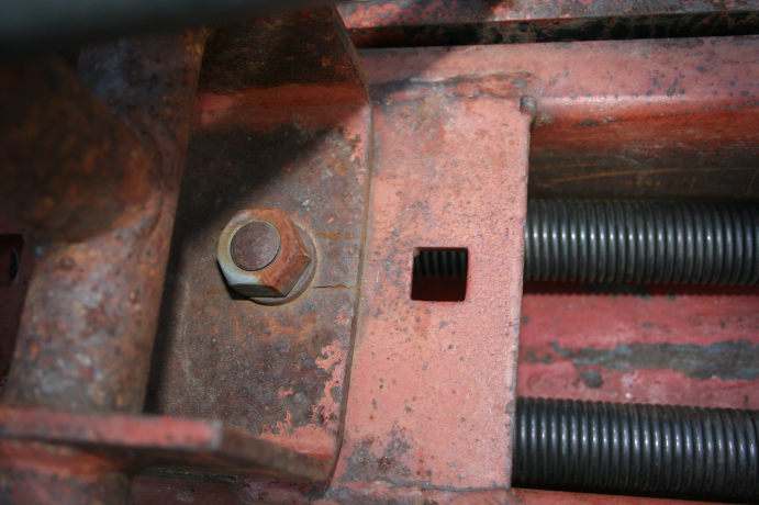

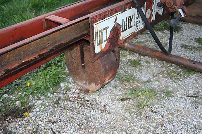

/ Post Driver #19
SPYDERLK said:
Thanks for posting the pic. Keep an eye on the area where the tilt frame connects to the guide for the hammer beam. The metal on the guide deformed on mine before I got it [used]. Large high strength washers under the bolt heads are in order as a preventive measure.
larry
On the weekend I changed a leaking cup seal on the cylinder and while removing the cylinder I noticed a stress fracture on the mounting bracket near the top bolt head. The guide is not deformed in any way. I think I'll replace the washer with a much larger one. I have no idea how old this post driver is or how much use it has actually had. Attached is a photo of the fracture. I also noticed on the new drivers they no longer have the large round chunk of steel like mine has at the top of the driver for extra weight.
