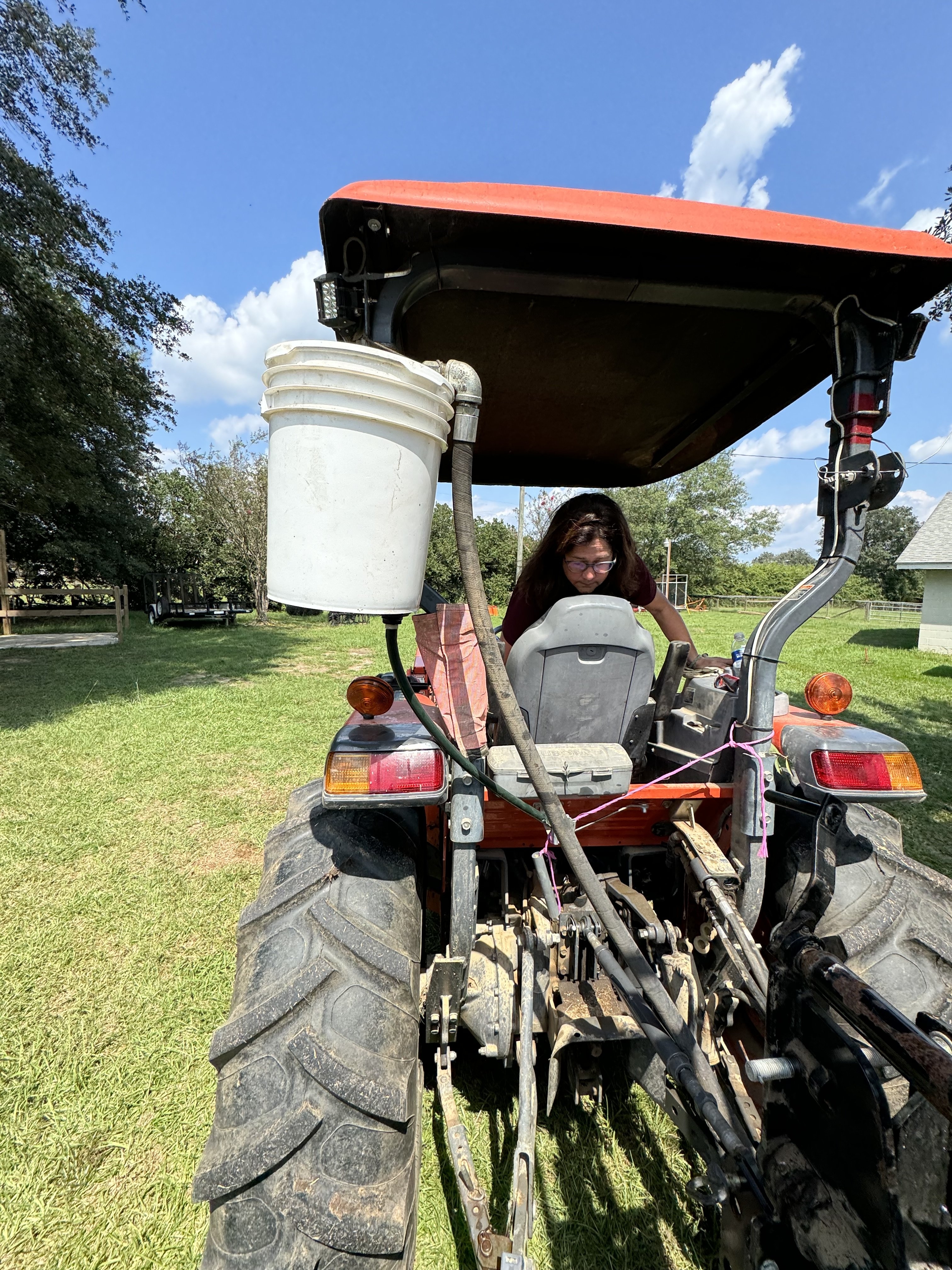

Put this together to stop the constant leaking around the return hose on my shaver post driver. My kubota just has a plug, no threads.
Driver dumps into the 5 gallon bucket. Bucket drains into tractor. Bought a bulkhead fitting from tractor supply. Bucket and old garden hose were typical farm recycling.
Works great.
