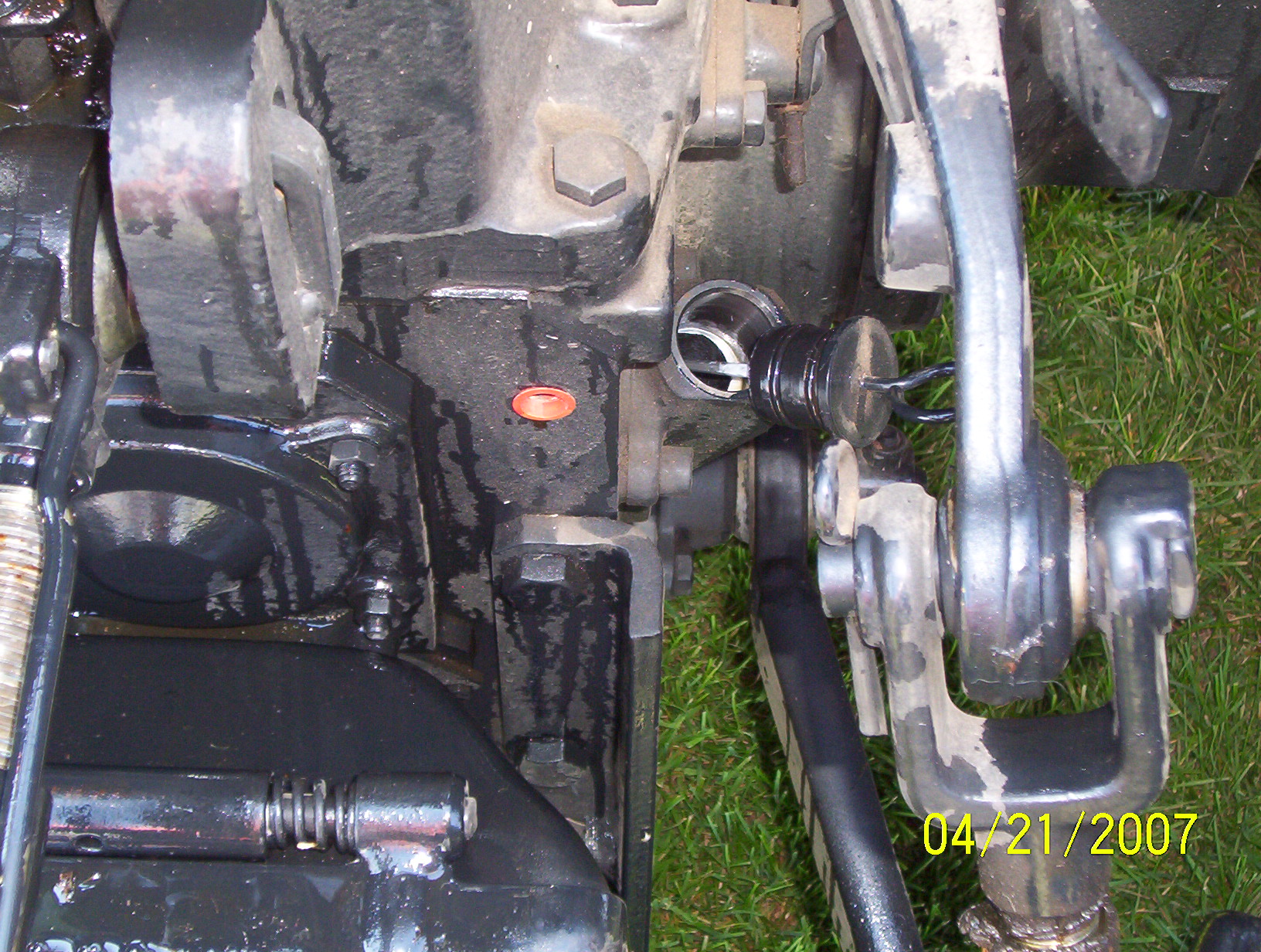

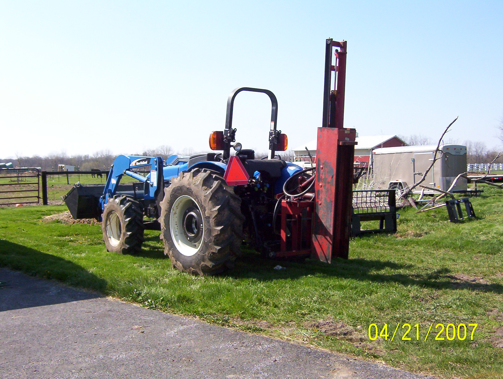

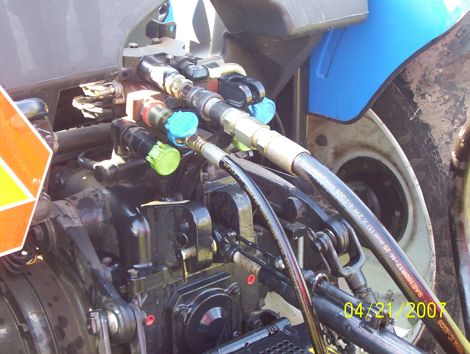

Thanks for the replies. I decided to go to my favorite shopping center, Farm and Fleet, and I was able to get enought couplers, nipples, and a reducer to plumb the exhaust or return line into the zero pressure return port, and the machine works fine. Attached find pictures of the pounder on my tractor, the first coupler on the port on the tractor, the finished plumbing job attaching the line to the tractor. I also put a picture of my dipstick and hydraulic sump filling port where the dipstick fits. My dipstick has a 1 3/8" x 1 1/2" rubber hunk around it and a large enough hole, 1 3/8" in diameter to accomodate it and I still am waiting to see what Shaver sends as a way to put the return line into the sump. Thanks again for the replys. Bill
