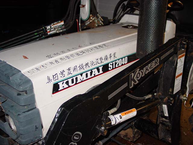

Here are the results from last night's work on the tractor...and a few pics.
The problem statement is:
at 2000 RPM the implements do not work
at 2500 RPM the implements work very slowly and appear to have full power
Here is what I did.
1. raised the bucket and 3 point as high as it would go.
2. drained the hydraulic fluid in a bucket...fluid looks fine, no froth or discolor
3. gravity dropped the bucket and 3 point. I could hear the oil spraying into the crankcase.
4. disconnected the low pressure suction line from the hydraulic pump and from the crankcase.
5. disconnected the high pressure line from the pump and from the loader valve.
6. removed the hydraulic oil filter...relatively clean...cleaned with compressed air
7. blew air through the low pressure line...there was no obstructions
8. blew air through the high pressue line...there was no obstructions
9. blew air into the loader valve and could hear the last of the oil blowing into the crankcase
10. blew air into the loader valve and operated the 3 point, it lifted. let gravity drop the 3 point and I could hear the oil blowing into the crankcase
11. The air was not enough to lift the weight of the bucket, but I doubt there are obstructions there because the problem statement covers the loader and the 3 point.
12. put everything back together and filled with new hydraulic fluid
Test results:
idle tractor at 2000 RPM, neither the 3 point or loader would operate
raise rpm to 2500, the loader would lift very very slowly and smoothly...same with the 3 point.
I haven't removed the pump yet, but I believe I will be doing that tonight. Unfortunately, I don't know if I would be able to determine a problem if I were to disassemble the pump.
Here are a few pictures...cause we all like pictures =]
Marcus
