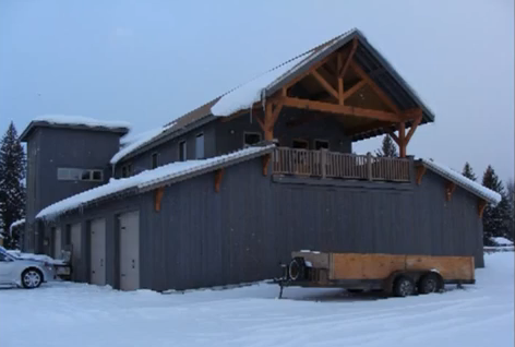

I'd love to build one of these with a 24' center bay and 24' sides. I'd put a temporary house upstairs in the middle and my shop on the main floor.
