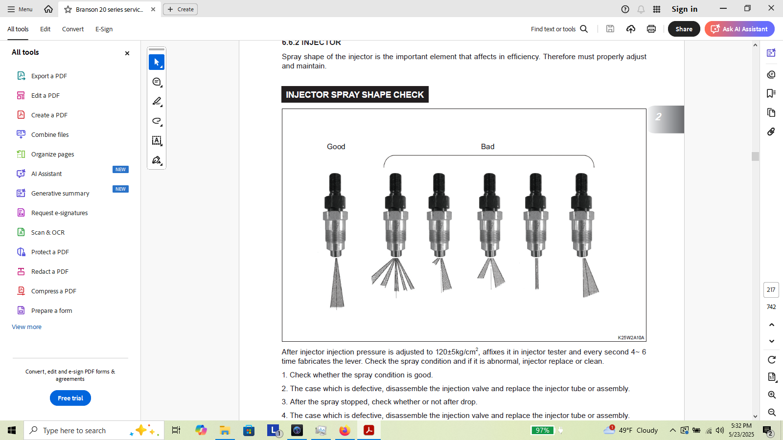

On Pg 163 (Chapter 2) Section 6.6.2 INJECTOR of this service manual, it states " . . . ". . . Injection Pressure is adjusted to 230+/- 5 Kg/cm2". These pressures (assuming the 2 different Conversion Tables I found on-line are correct) equate to 3271 +/- 71 PSI !!! Someone please correct me if I'm wrong but don't these pressures seem much higher than what they should be? I was under the impression the Injectors in the A1500 - A1700 model engines should be popping at somewhere between 2000 to maybe 2700 PSI. Do I have a phony manual or do they all read this way (and WHAT ARE the correct pressures if these are wrong? Thanks.

From the 20 series service manual;
After injector injection pressure is adjusted to 120±5kg/cm2, which is just over 1700 psi.
and then I find this,
After injector injection pressure is adjusted to 150±5kg/
cm2, affixes it in injector tester and every second 4~
6 time fabricates the lever. Check the spray condition
and if it is abnormal, injector replace or clean.
which is 2133 psi.
The 2133 psi sounds more in line to me but who knows for sure.
The last time I messed with injectors it was making sure they were all at the same pressure and for some reason 2600 psi rings a bell.
And then the indirect injection such as the old Olivers were only 1900-2000 psi.
   / (Possible) Error in Branson 20/25 Series Tractor Service Manual
LouNY: Probably why I got my Manual for so cheap! Couldn't see any numbers at the bottom of the page photo you provided, but mine has 'K25W-201406' at the bottom left hand corner if that might explain any Revisions. And yes, yours seems to be much closer in line with what I was able to see on youtube for what looks like similar injectors BUT what's up with the 2 different sets of pressures ?! Mine has the exact same verbiage as yours after the initial pressure (yours: 120+/- 5kg/cm2; mine 230+/- . . .) and continues with 4 sentences of what to do regarding "spray condition" but it is definitely an exercise in 'Pidgin English'. Sheesh. Thanks for your input.
