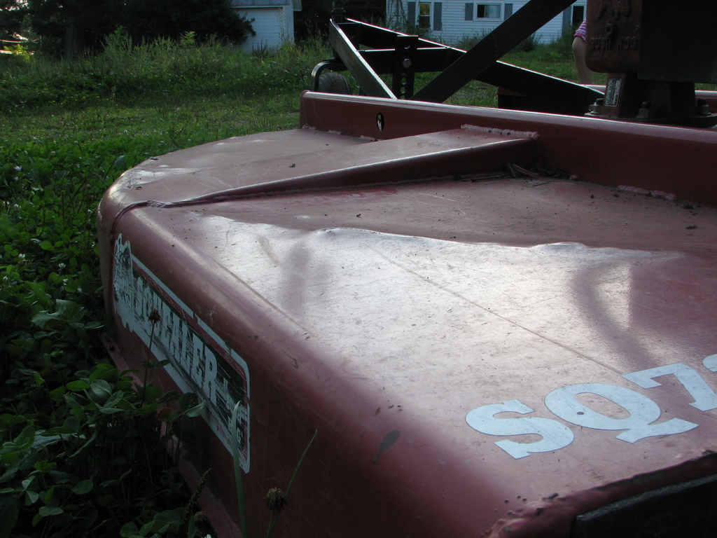

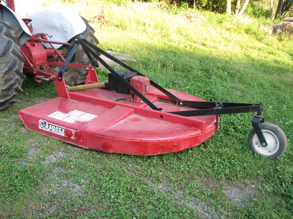

So I bought the BH SQ720. I'm wondering now, at $1000, whether I didn't overpay given the denting on the deck caused, the seller tells me, by his brother hitting something big; it was big enough that he replaced the main axle (the one to which the blade is attached, I guess). And, beyond overpaying, do I have a structurally compromised unit? I don't know how to think about this; is it, "great, you have a unit with a brand new axle!" or is it, "bummer, you don't know what kind of secondary damage was caused by the accident so, even though you have a new axle, you might have a gear case that's damaged/weakened."?
I've attached some pics. In the 2nd pic you can see a side view of the deck; the blade really wacked it; pushed it up a good 1/4 - 1/2". I wish I'd taken a far away pic from the same side as that close up but when not so close the dent on that side seems pretty similar to the one shown in pic #1. Disturbingly, though on the phone it was all "everything works great," after talking he told me that he hasn't used it since he replaced the axle. That worries me. That seems like a major repair caused by major damage and now I have a unit that, though "fixed," is untested.

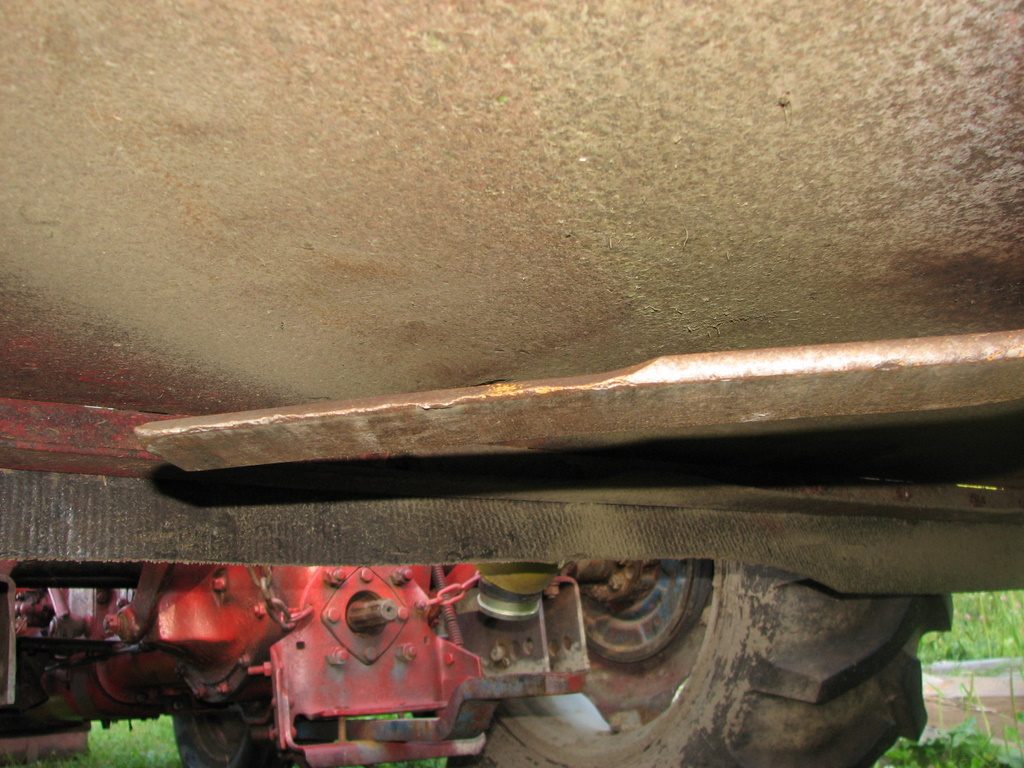

Seems to me the blades are in reasonable shape; some dents but I can get a hand grinder on that. The seller didn't say that he replaced the blades but they must be pretty tough as they don't seem to show the damage from hitting the deck.

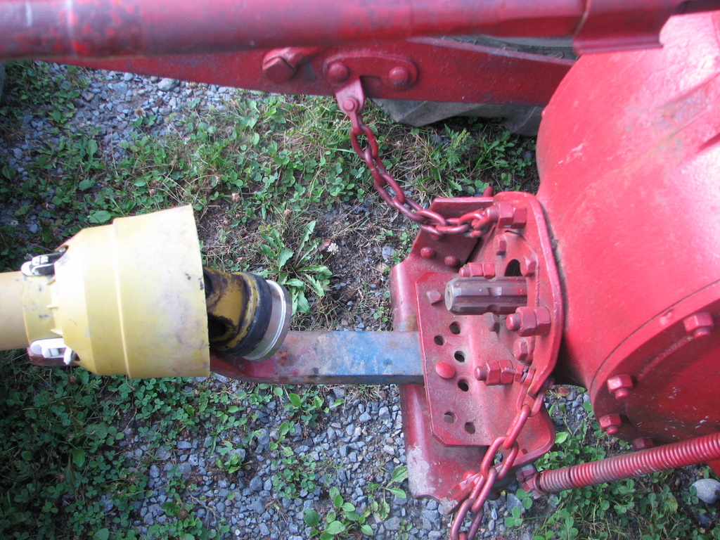

As another pic shows you can see that the PTO shaft doesn't reach. I'm assuming there's some extension that I can buy. I'll be calling a tractor shop today (Tractor Supply were out of stock).

So long as the output shaft (what you're referring to as the "axle") was installed CORRECTLY, you shouldn't have any issues there I'd think. I have a couple BH 286 mowers we use in my mowing business. One is hammered and dented far worse than that. (and has been for several years) No issues to report there. Bush Hogs can take a thrashing while doing their "thing".
OK...Grease points. You covered all but one. There should be one to lube the telescoping portion of the shaft. If not, or if you can't find it, simply pull the two halves apart and slather grease all along the length of the inner shaft, then re-assemble. Also, oil the snapping lock collar where it attaches to the tractor if the mower will set outside. They'll tend to stick otherwise.
On the pto shaft length. Looks to me as if there's PLENTY of overlap in the telescoping pto shaft, but I also see you have the mower on an "N" Ford. You'd be well served to get an over-running clutch. That'll serve as a pto shaft extention, probably long enough to take up most of the gap between tractor and pto shaft in your picture. If you choose not to use the ORC, pto shaft extentions are available through any GOOD farm equipment dealer, or TSC.
$1000 for a pristine Bush Hog SQ series mower would be a bargain. That one ISN'T pristine, but it APPEARS to have quite a bit of life left in it. In a year or two of service, even a new one would start to look a little "worn". I wouldn't call it a bargain, but you didn't get hurt either.

I'm assuming by "axle" you mean the output shaft of the gear box. And yes, you can remove the plug to see if there is gear oil in the gear box. If he ran it and you see no signs of a leak, it's probably OK, but I'd check anyway. Go to Bushhog.com, click on "manuals", then go to the Squealer manuals and print out a manual for the mower.
As for the PTO shaft not reaching . . . you do know it telescopes, don't you? Have you pulled it apart? When extended enough to hook up to the tractor, you still want 6" or so of overlap.
So I tried it and PRESTO! it just pulls right out. ;-) Attaches fine with plenty of overlap. So now I can add "knows how a PTO shaft works" to my farming resume! ;-)

Be sure and follow the advice of FWJ's and get an overrunning clutch an important safety feature that could save your life. Keep all PTO guards properly maintained and in place.
