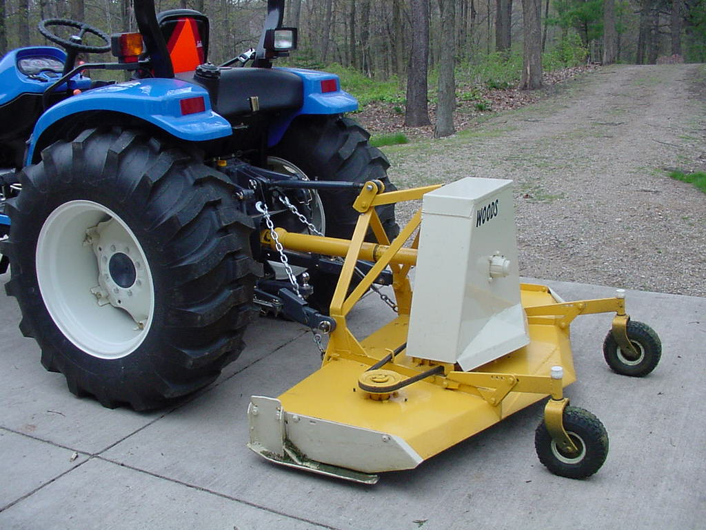

I wouldn't bother with all that. Lift up the deck and scrape any large clumps of grass, etc, off with a putty knife or similar, and call it good. Attached is a picture of my 29 year old Woods deck and other than a new coat of paint, that's all I've ever done to it cosmetically. I store it up on a set of blocks so air can circulate under it, but I've never seen rust form. Must be that vegatable oil from the grass protecting it. /w3tcompact/icons/laugh.gif
