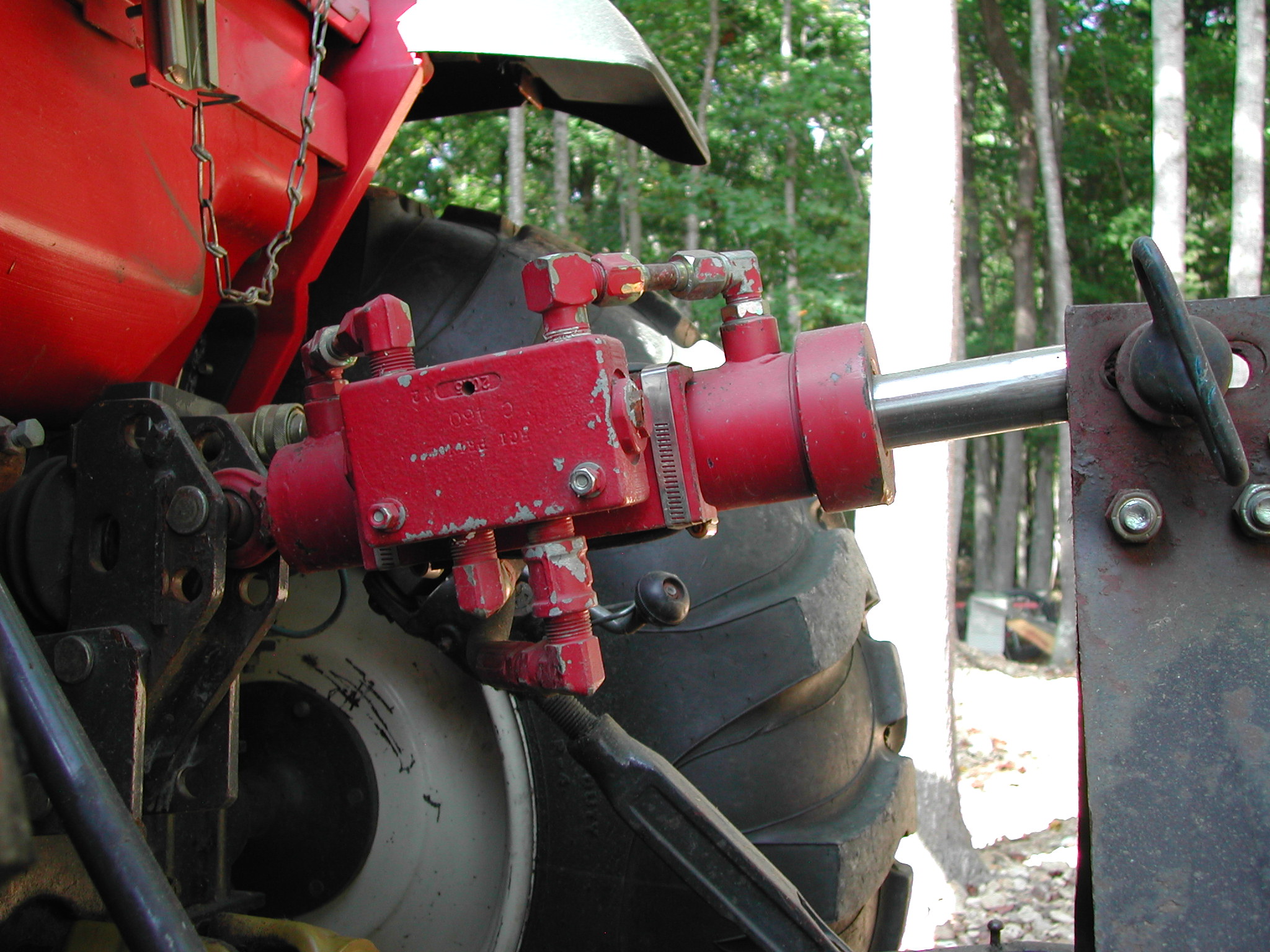

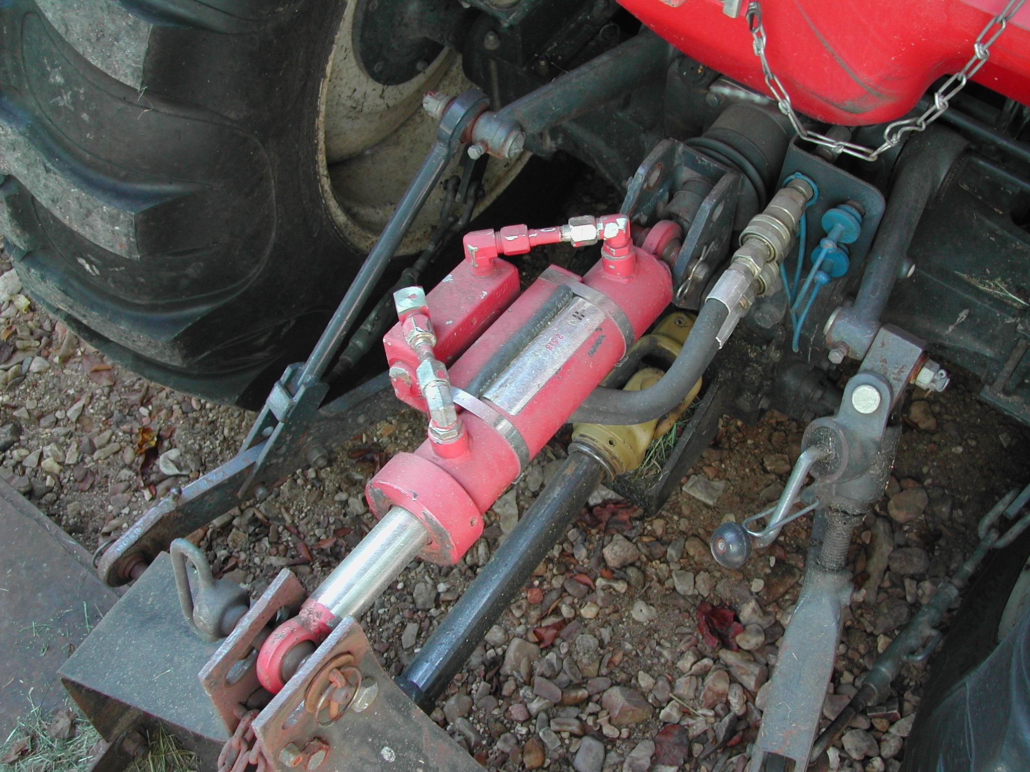

This is my homeade toplink - that's a Prince DPOCV mounted on the side of the cylinder. I got the parts from Surplus Center 6 years ago and built it and has held up to extreme duty on my tractor - I don't baby it !! Doesn't look as pretty n' sleek as most but it works well and was reasonable in price. My hoses have never gotten in the way and I have no other clearance problems throughout the range of toplink movement, even with my little toolbox on the valve side. My remote disconnects being mounted real close to the hitch really help too - don't know if it's feasible on your tractor but you might be able to move where your remote connects are to help use different hoses.
I mounted the DPOCV to a piece of 3" channel iron with bolts, then along the 2 edges of the channel I split some 5/16" fuel hose and slipped on it for insulators, then mounted the channel to the cylinder with a couple stainless hose clamps. I hardwired the valve to the cylinder with the steel hydraulic lines and fittings which made the mounting even more solid. When changing implements or using an implement that doesn't need a toplink I use the small chain you see slipped under one of the steel lines to hold the cylinder up out of the way. That cylinder is a 2 1/2" dia., 8" stroke with a heavy 1 1/2" dia. rod. Originally it had clevis ends but I cut them off and cut the rod at that time to the exact length I wanted for my tractor and got 2 weld-on ball ends from TSC and welded it up. I paid $59 for the cylinder, $70 for the DPOCV, about $30 in fittings and quick connect ends and the 2 hoses and the 2 ball ends were about $16. I already had the channel iron and hose clamps and fuel hose. The main reason I built my own toplink was the fact that I couldn't find one with the right retracted length to fit my tractor and the implements I use. All the ready-mades were too long by a couple inches and would have been almost useless for me.

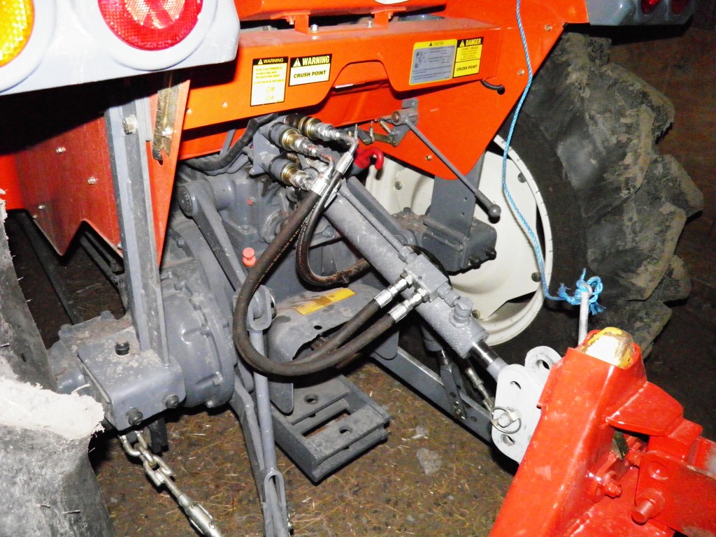

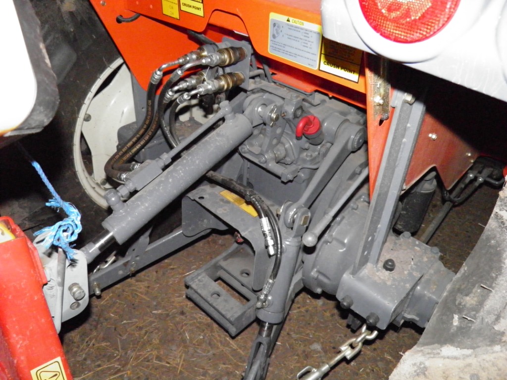

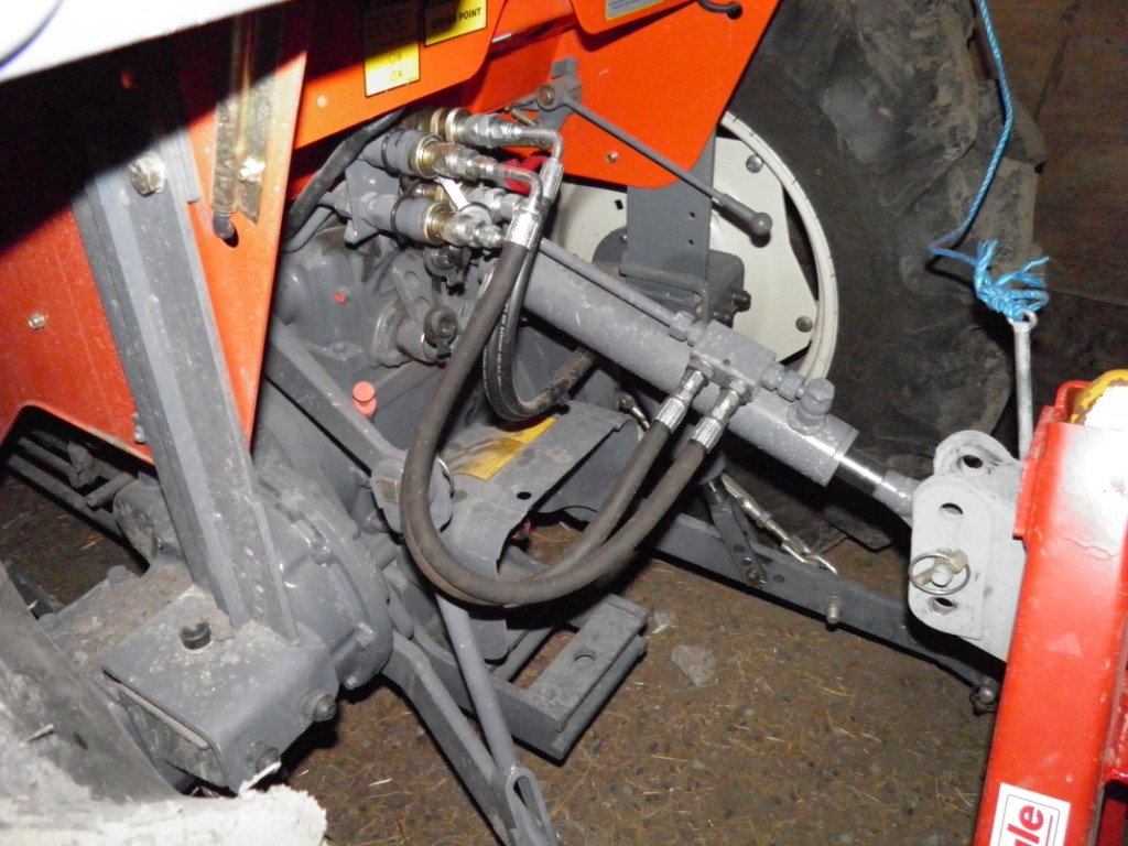

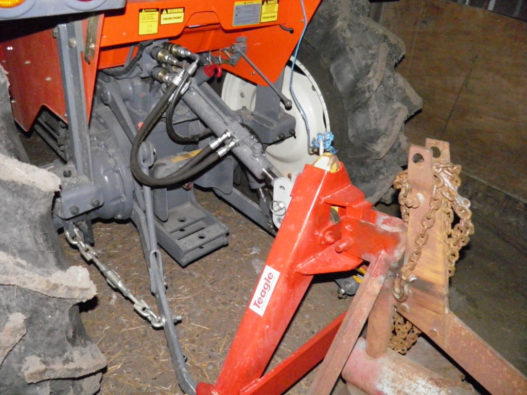

Mine was a tight fit and I tried several different positions. Here is a pic of one I ended up with. Not sure if it helps you at all.

IMO, one hose fitting is vertical, and the other end is horizontal. As the cyl moves up and down, the wire braid is trying to twist, and could eventually loosen. I would loop the hose in a vertical plane, and possibly a swivel if necessary.
I would loop it straight off the back down to a swivel on the cyl .
If you have ever wound up a pressure washer hose, you know what I mean. You have to wind it in the same plane. It does not like to twist or kink.
   / Position of hydraulic hoses on top link #7
QD's makes excellent swivels, and I can't see why XCAT's solution shouldn't work....
if cylinder movement is vertical, hoses needs to be looped in a horizontal or offset plane, to allow flexing alt swiveling....to longer loop the less need of a swivel, and vice versa....
Good example XCAT!:thumbsup:
I like tight plumbing, but Skipmarcy's plumbing looks little too tight, and it don't look like the QD can swivel?? The, way too short, hoses, might put tension into hose wiring and the fittings on the DPOCV. Do you have to plug in the QD's before connecting the blind side of cylinder to tractor?? Looks very tight....but if it works it works...:thumbsup:
Agree that vertical loop (at vertical movement) can eliminate need of swivel if plumbed right, but then you'll depend on a hose bend flex, and that might take an extra large loop of hose....(have seen 360+ deg loops LOL)...but now you have to use QD's so why not take advantage of the swivel option QD's give you!?
