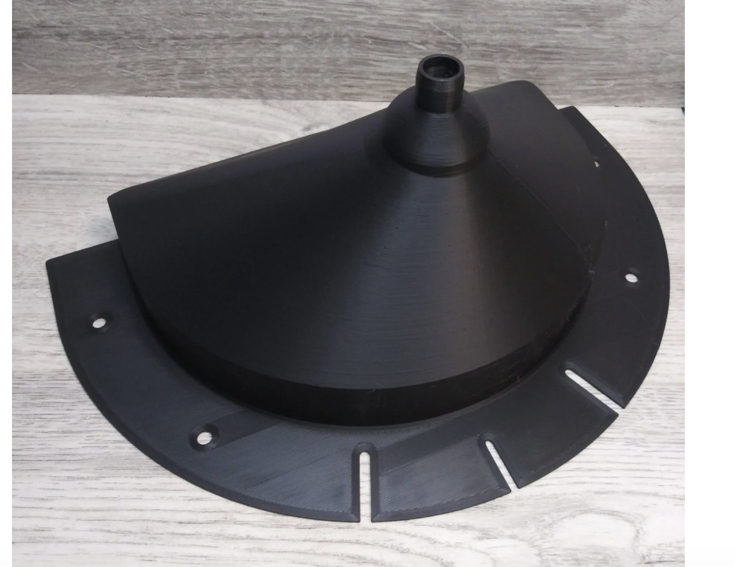

I think I would go the composting toilet route with a urine diverter. Way easier to deal with than the blue crap juice. Get a 55 gallon drum and cut off the bottom for soilds and get on etsy to buy a 3d printed urine diverter with a tube to dump out underneath. I promise those composting toilets work and DO NOT smell. You could also add a solar fan into the barrel cabinet to create a negative pressure in there so if there is any smell it gets exhausted. PICS PLEASE!
