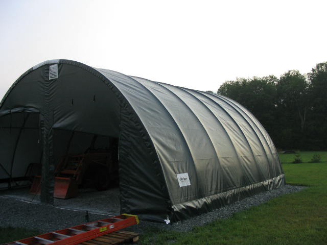

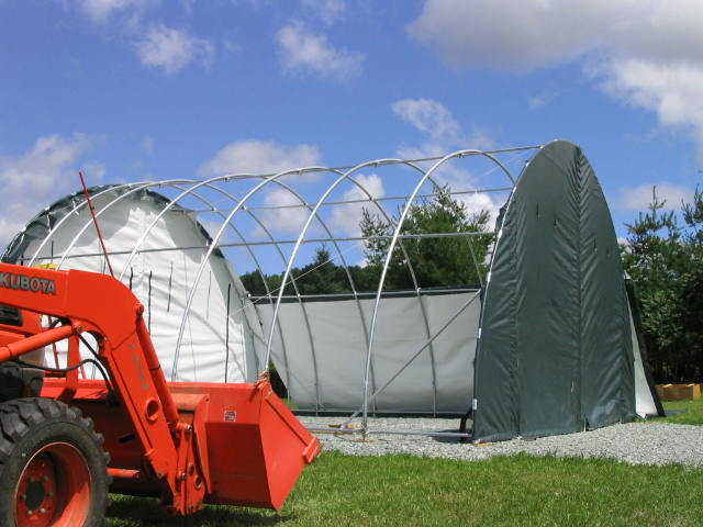

Hi...
Inquired here a few months ago about portable garages...
Just completed putting up a 26'wide x 24' deep x 12' high Clearspan "portable" garage...
My girlfriend and I constructed the frame and rear cover in a weekend... I put on the front cover and main cover by myself... with the help of 2 tractors and a truck... /forums/images/graemlins/smirk.gif
"Closeout" price about $1,500 w/ delivery... $400 for stone base... ~$200 in extras...
~$2,100 total... + labor...
Seems like a nice unit... all parts went together well...
A photo is attached... and 2 more follow...
Dave...

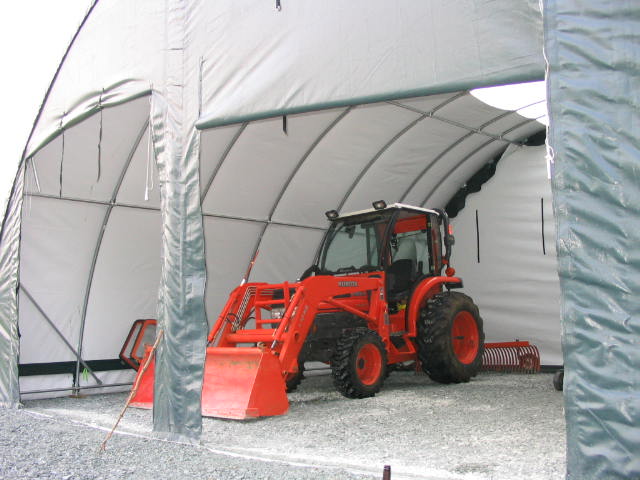

Tractor inside...
Dave...

   / Portable Garage Done... #4
Nice looking unit. Did they give you an idea how long the life is?
Michael
Life...
15 year warrenty on the cover... pro-rated I guess...
Pipes are galvanized & substantial... 1.66" O.D. for main rafters & other pipes... 1.35" pipe for rafter connectors...
Dave...
