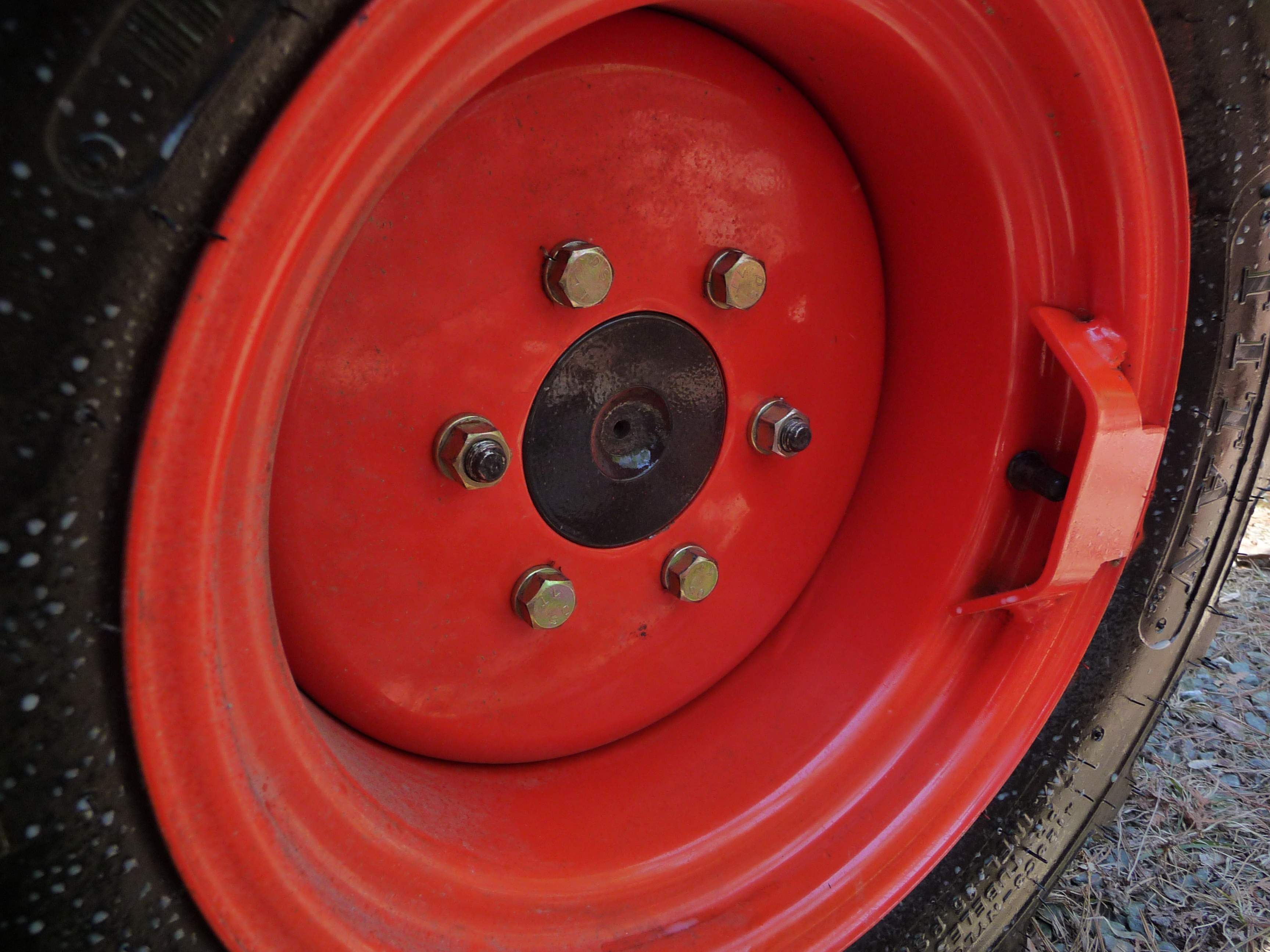

When I bought my CK20 they did install a little plate in front of the valve (four tires). You can actually see scratches from rocks and branches hitting the plate. Very usefull detail!

My wheels have the stem guards, but a stick at just the right angle can still reach the stem. If the guard were threaded to take a cap (like a threaded-pipe cap) I could just cover it up that way but still screw off the cap to check the air. If it happens again, I'll definitely make an effort to implement a solution.
