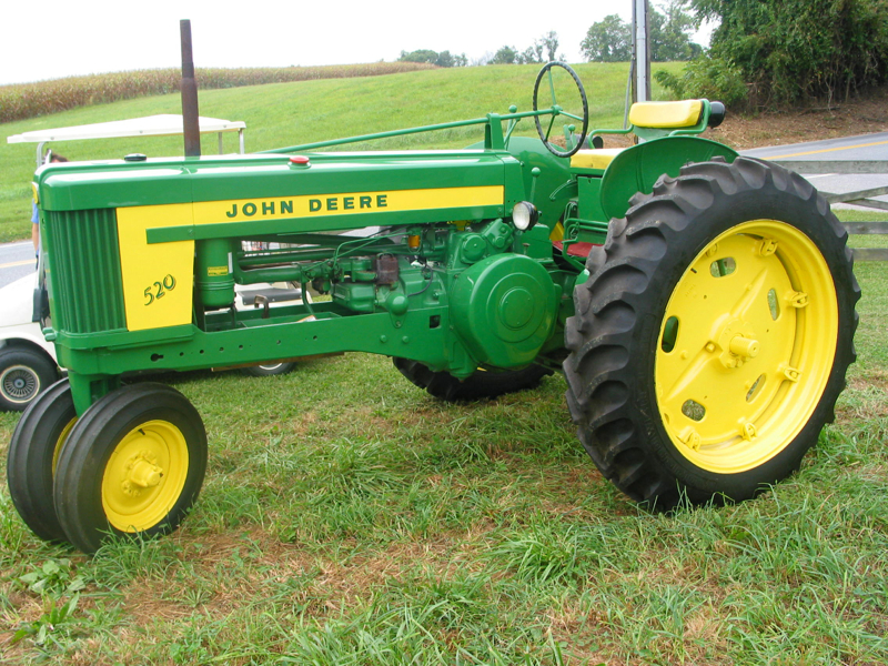

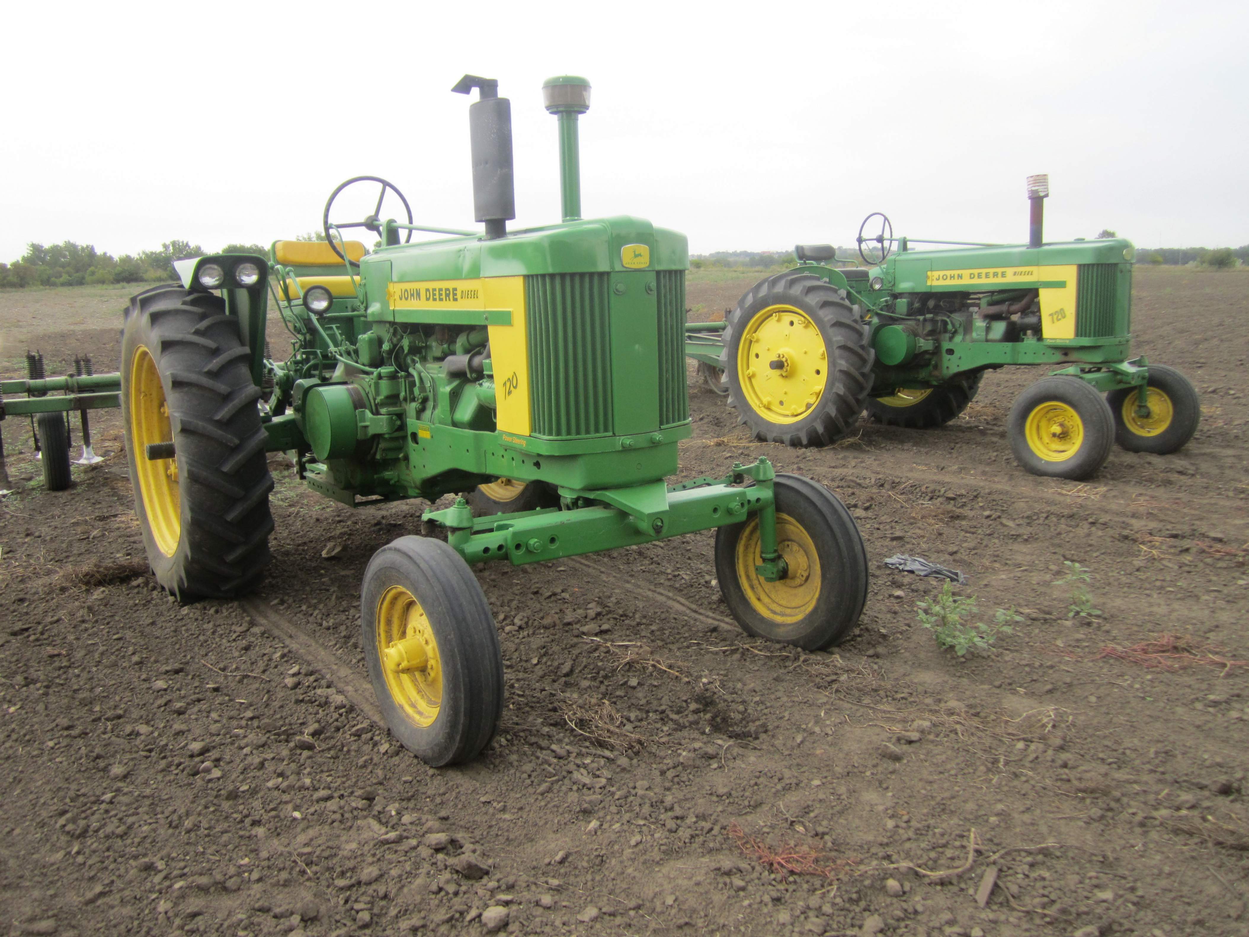

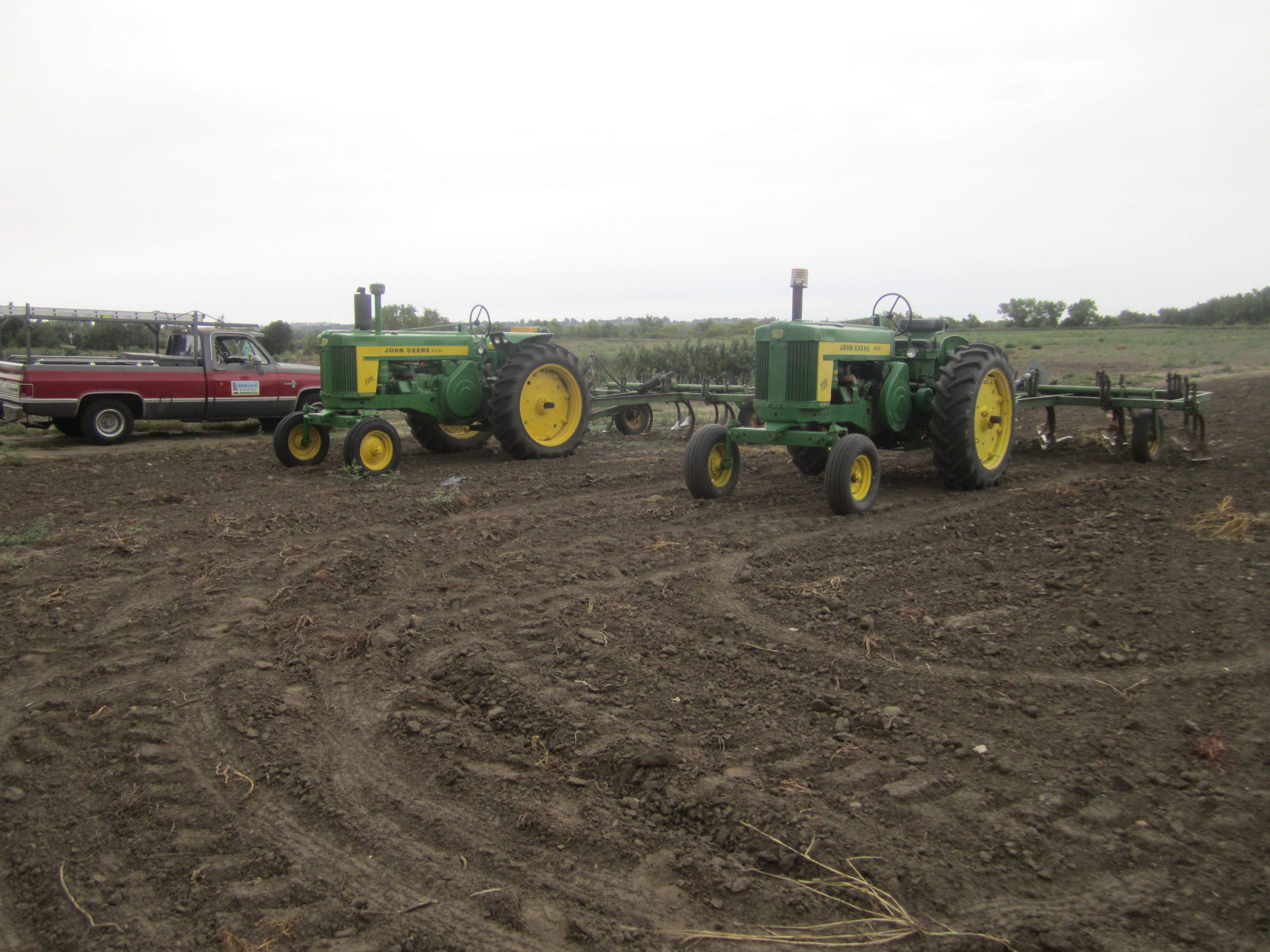

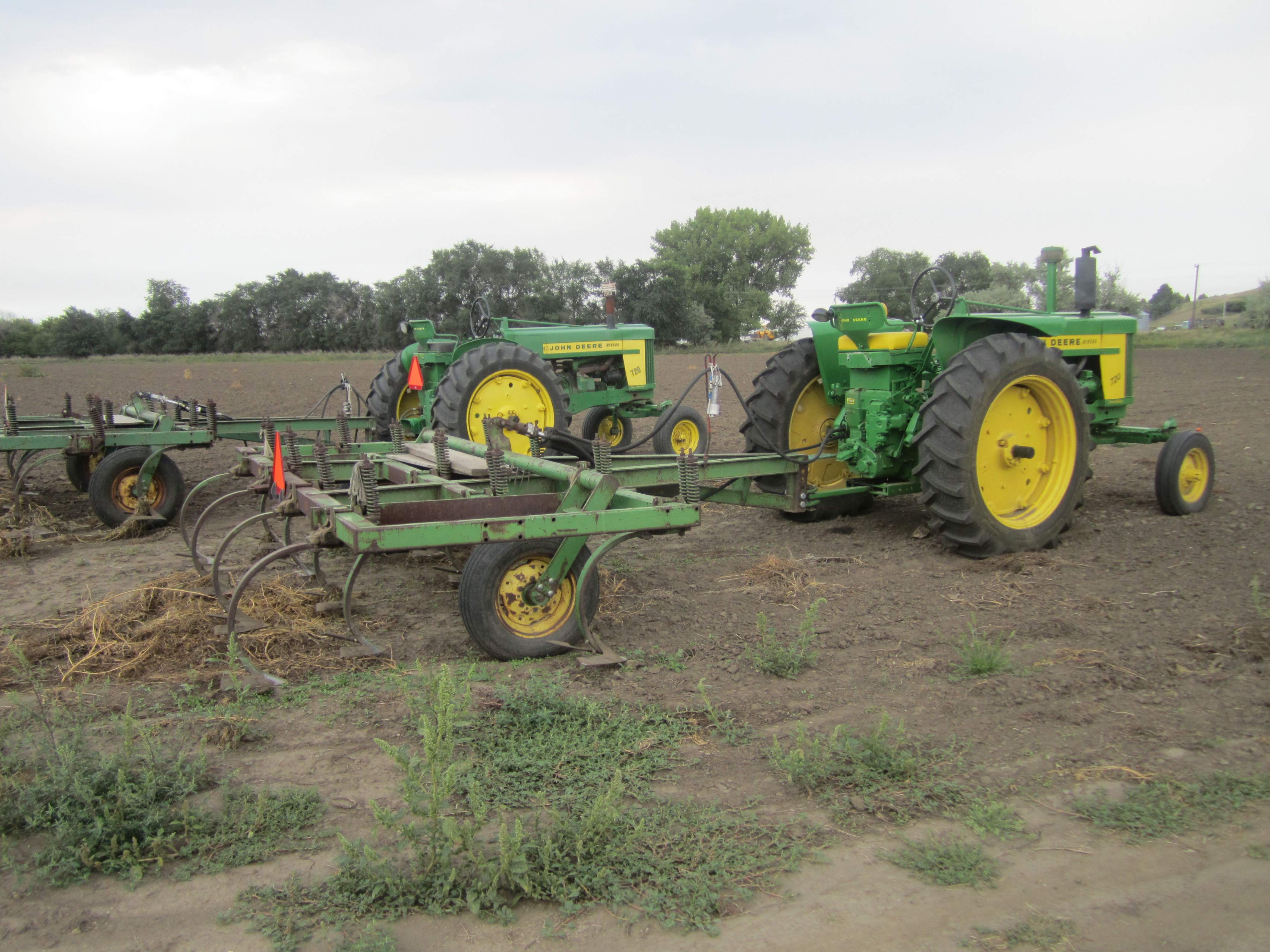

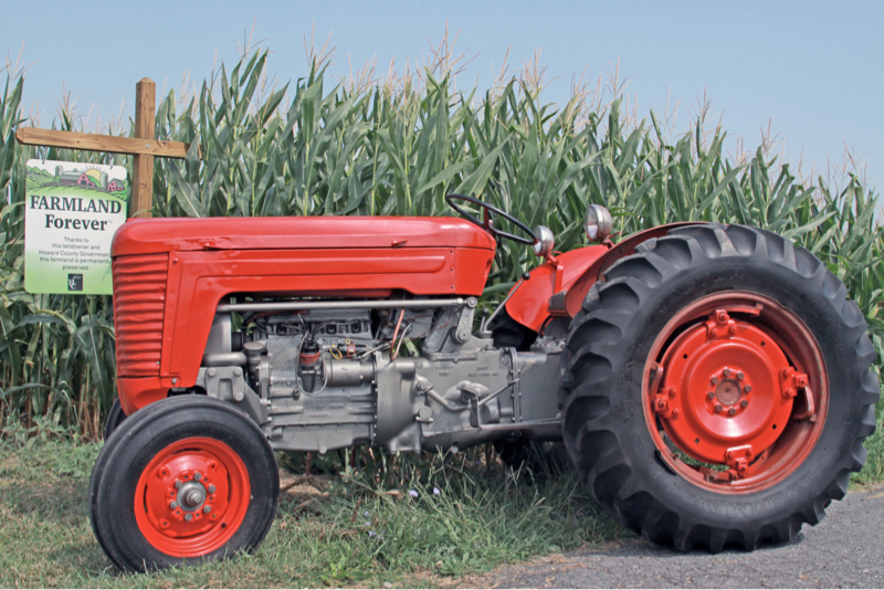

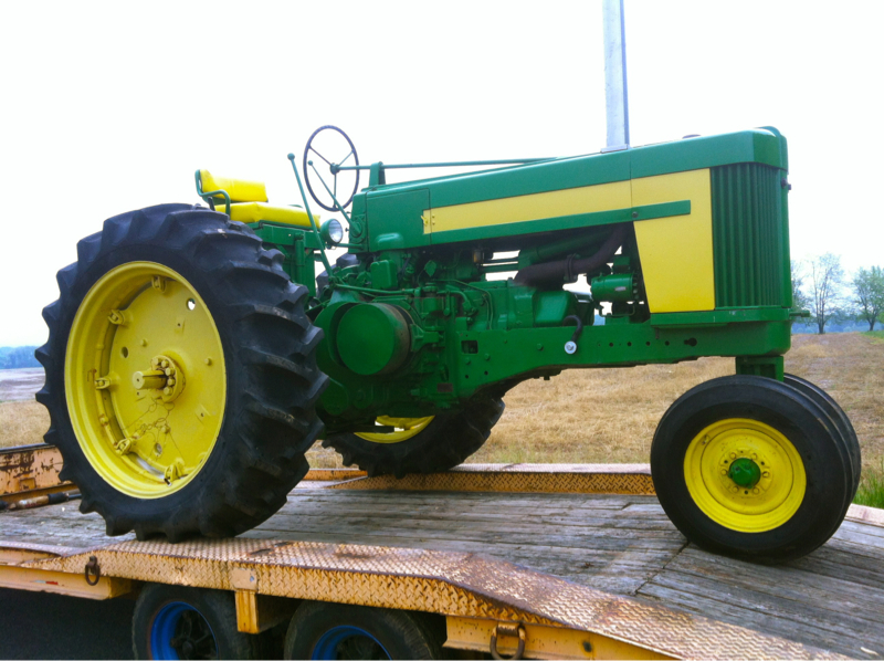

Dear Larson:
I am taking a liberty to assume your handle begins with your first name,
I see you have an early and late 720D. How sweet it is. Do they have the same issues?
My 720d is a hobby tractor. I have the decals in a drawer for Spring.
I grew up on a 100 acre dairy farm so our tractors were a Ferguson TO-20 and a Massey Ferguson 50.
Now I work for USDA in Wash. DC. Retiring this year at 71.5 and hope to play with tractors for a lot of years yet.
I have loved that two cylinder sound since I drove a Model 50 at a county fair in 1955 .
Jim

hey welcome to the tractor place
i really like you tractors
i sure know what you mean about the sound of the 720
