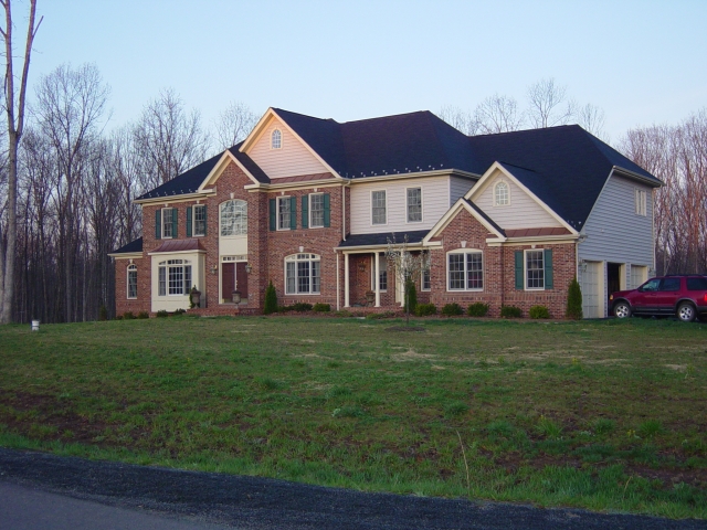

Well...the wife has told me that I have make room for her vehicle in the garage this winter. Guess that means that I have to build a new garage for my tractor. There are rules in this neighborhood regarding the type of construction...basically, it has to match the house fairly well which means that I can't put up a steel building or anything like that. What I'm looking for is advice on what people wished they had in their tractor "garage" in order to make it easier or better and any other advice you may have. So far I have the following:

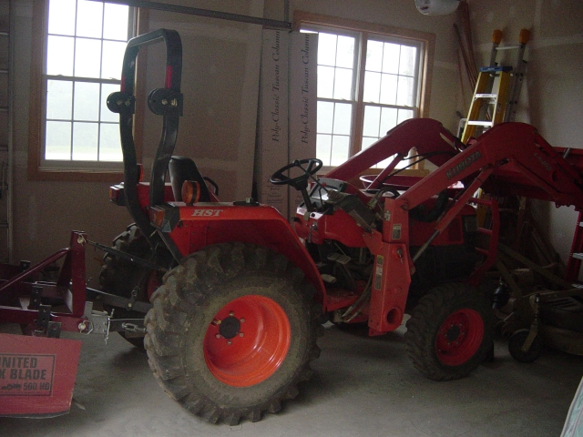

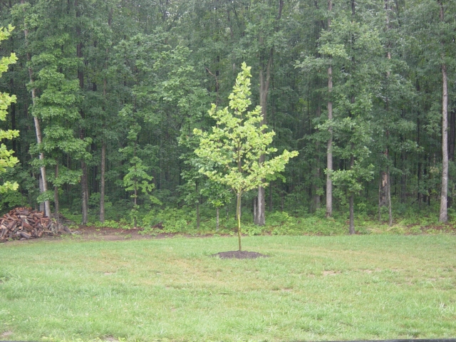

Couple more pics...
- where the new garage will go
- 'bota in the current garage where the wife wants to park

Nice house!!
To match a barn/garage to it is gonna cost you, but in the end, the added value will be well worth it.
You didn't mention who will do the work? If it's you, I'd only use brick as an accent at the front and stay with the siding as much as possible. That's real easy to install compared to the brick. You mess up on the brick and you have a disaster.

Make sure you have plenty of room on the sides of your tractor to both work on it and store stuff out of the way. Think 2 feet for shelving and six feet for working on each side. More if you want to park anything else in there besides the tractor. ATV?
Same for the back. You want to be able to walk around your tractor and get to it, front and back, with the doors closed. Four feet would be my ideal minimum.

I think you're right on the brick. I'll plan on just doing it on what is facing the street and the house. The brick is probably the only thing I will pay someone else to do.

I agree with you on the room to work. I was thinking 3' on each side. I wasn't going to put a lot of room in from or back but if I don't have an attachment on it I would definitely have the room. I was thinking that if I had enough space with the hog on it and the FEL down then that would give me a lot of room if the hog was off.

Would you consider an open overhang that provides like an open shed on one side? Might be nice for firewood storage or another use you have not thought of yet.

Thanks Rox...some really good things that I haven't thought of yet. Think I'll use the overhang idea for firewood on the west side of the garage. That solves another problem as well.
