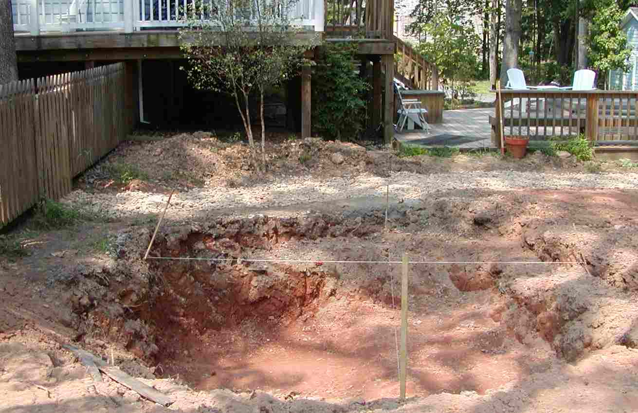

Started our pond project this weekend, a lot of time in the seat of the BX22. Looks like we'll end up at a bit over 3500 gallons. Rough hole is dug which allowed me to get some measurements, now we're researching heavily to buy the equipment. Have found a couple of places online that sell complete kits (filters, waterfall, pump, liner, etc.) which looks like it may be the way we go.
We weren't sure just how many rocks we were going to run in to or what else we might have, there was a large tree at the back of the pond as shown in the attached picture that took some digging to get the stump out. Think I've got enough of it to not cause a problem. Not going to do any more digging until we get all the equipment but will post more shots as we go along. No hurry so probably will be a few weeks.

   / Pond Started #2
Looks like a nice start. Just a pointer, when you start getting equipment, most people end up trying to economize on the pump, filter and such and undersize them. If it is undersized it's hard to keep the pond healthy and you end up with a lot of maintenance work instead of a place to set and enjoy.

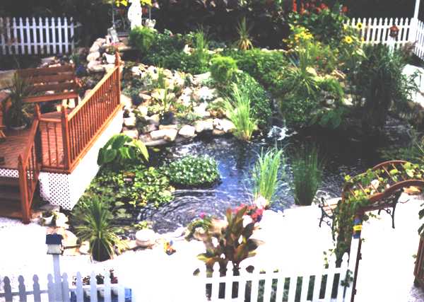

   / Pond Started
Great shot of your pond, that's what we're going for! Will check out the links as well.

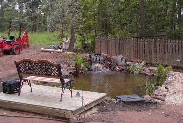

Spent the last couple of weeks of spare time working on our fish pond, pretty happy with the results.
Used 45 mil EPDM liner, size is about 16X22X2.5. Some areas are slightly deeper. Have about a 1/2 inch of gravel on the bottom, all the rocks came from my 4 acres and there are plenty more where they came from. Used rock to line the edges and we're slowly building them up the sides as well.
Have 11 goldfish, ranging from 2-4 inches. First 2 stayed in the waterfall and never saw them unless the pump was turned off. Added 9 smaller ones yesterday and they are all over the place, including the first two. Guess they just needed some company.
BX22 did a great job digging the hole, leveling fill around the pond and I even used the backhoe a few times during construction to lower some of the larger rocks in to the pond.
Lot of landscaping to do but has been a fun project so far.
Pictre is an overall view.

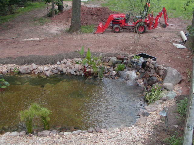

   / Pond Started
Another picture.
