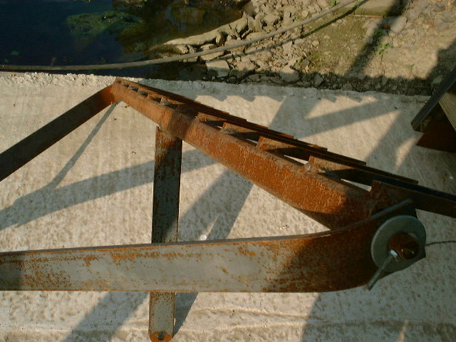

Okay Lads, let's give it a try. In this first picture, notice that
the tines are welded to a length of square tubing and that this
tubing pivots on a steel round bar which passes thru the center of this tubing. Also notice that there is a flat strap
welded to this tube in such a way that if you pull on the end of the strap, the tines will point downward and slightly forward so that they grab the roots, etc.
The trunk of the Y, or yoke, is made of hollow tubing. The main haul line
is attached to the end of the strap and routed thru the hollow
trunk of the Y. Therefore when the pulling device (tractor, horse, atv, wife, children, etc) pulls on the main line it (they)
are actually pulling on the end of the strap and the tension is so heavy that it causes the strap to align straight forward,with the tines facing downward. At his point the Y yoke is
just along for the ride. (see next post for the conclusion)

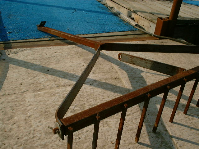

In the second picture you can see that the tines, welded to
the square tubing, have rotated on their pivot shaft. In this
position whatever weeds, roots, etc you have collected will
slide off the tines, allowing you to return for another load.
To make this happen, you stop pulling on the main haul line
and let it relax. You then pull on the trip line, which is attached to the lug on the free end of the Y yoke. You can
see this lug in the previous picture. As the tines rotate forward to the trip position, the haul strip will
rotate downward so that it may actually drag on the ground.
For me this has not proven to be a problem, but in fact it
lifts the tine bar to facilitate dumping. I use steel cable for
the haul line, since I use this thing in deep water and don't wnat to chance losing it. I guess if the haul line were to break, you could still retrieve the rig with the trip line.
