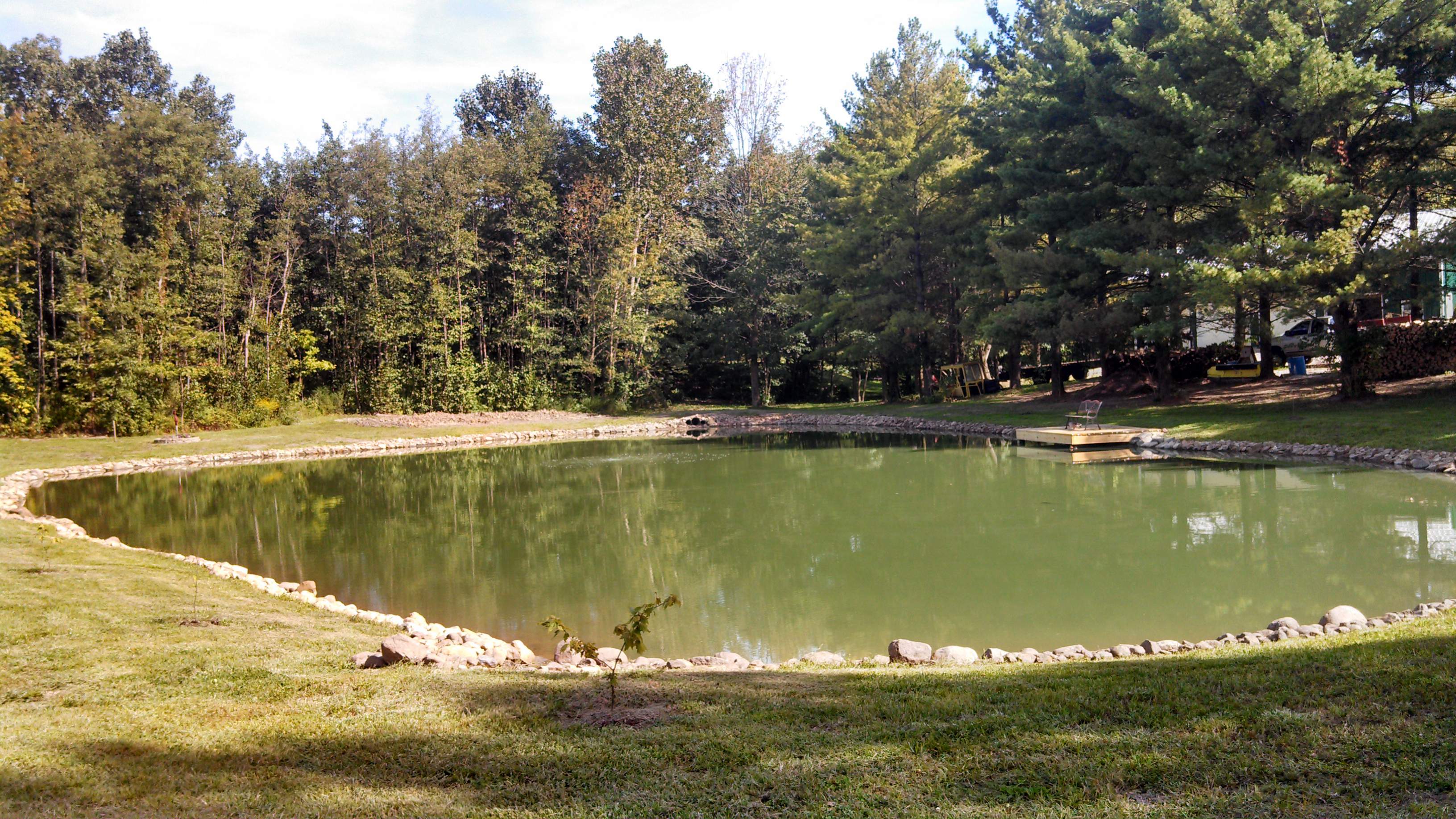

Looking for some suggestions as to what others have or have seen. Most all ponds I have seen in my area don't really have an overflow so to speak, but also don't have a lot of fill water coming in either.
Currently, my pond has a 12",culvert with 2 8" culverts for an overflow. I did this cause I need more than a 12, but didn't want to go bigger cause I didn't want to have to build up and over that much higher. The pond is fed with 2 12" culverts and a few 4" tile. The 12's flow full with a good rain. But I am wanting to redo the spillway and get rid of the "hump" over the culverts. So looking for ideas. I also want to be able to drive over it.
Considering the following.
1. Concrete swale. Kinda a shallow u shape. About 4-5' wide and 25' long. But worried about freezing, and not having a great base. My soil all around the pond is thick black waxey muck, that sticks to everything, and never really drys.
2. Considering stone. Not sure what size to get to not wash away. And am afraid it wouldn't support driving over very well due to the muck. And to be thick enough to be firm to drive over, would mean digging deep enough that water would flow through the rocks an cause a lower pond level.
3. Just leave the culverts and live with it.
I appreciate any suggestions. I'll see if I can find a picture of what I am dealing with.

Sure looks good to me. Nice work. WOW ! I would tend to a concrete swale overflow but my ponds are more ground water than flow through.
/ pond overflow/spillway ideas
This is definataly a flow through. You can see in the second pic. That was last spring.(the first spring after it was dug). The first pic is how it looks now. But I don't like the hump.
I have read some places online that concrete isn't good for a spillway. Ice and frost heaving, which is a definite concern heren and also erosion and washing out underneath, since I cant really do a suitable gravel base as that would undermine the spillway.
But have also seen several nice looking concrete spillways online too.
I am not opposed to gravel. But what size? I got a load of #57's coming for driveway maintenance. But am afraid its too small and will wash away.
I want whatever is going to last the longest and still be able to drive over with the tractor and mower.
And if I go with rock/stone, is limestone or gravel better?

I would check out geotextiles, filter fabrics. They should keep the muck out of the stone if you build a rocked spillway. I would use 6" to 8" rock, river rock would be nicer looking than crushed limestone. I wouldn't use much gravel if you have a 12" culvert running full, that's a lot of water and maybe enough to move gravel.
You could call a vendor, like above and describe the situation, email a pic whatever, and see what they recommend. Rocked spillways would be my choice over culverts or concrete.

Why not use the same rock that you have around the perimeter? It looks large enough to hold without washing away. You could put down some geotextile fabric first then a couple layers of rock should hold. Use a broken rock with irregular shapes so it locks together rather than round or smooth shapes.

If one of your criteria is to be able to drive on the overflow, concrete would be the best. I contract mow the city's containment ponds. They used 8"+ sized rip rap for the overflows. It looks nice, serves the purpose however is a weed magnet. Its a pain to weed eat....

What I would look at doing is using some concrete (shaped like a parking lot wheel stop) in sections & placed w the Kub. off to the left (first pic) you have a round hydrant/burn ? pit. about half way in between there and the culverts is where I would place them.
Side by side on good sized rock, would have to dig down (back 8 or 10 feet from the pond edge) to get them all in there. Lay them in a corduroy road fashion in a two by two (right side up then upside down) an inch or two apart. Here is a link to google for corduroy road https://www.google.com/search?q=cor...Blue%2FviewImageData.jsp%3Fid%3D80322;512;412
With the Kub get the spillway out & around the back side of the lip (leave covered) that is between the culverts and that spigot/pit. Then once you have that done use the kub to cut in the rest of the spillway up to the pond & fill it with some larger decorative stone like the shoreline has. Might even be able to raise the level some to make the bump of the culverts less obvious, use some 90 or 45 degree fittings on the culverts to get them under water level some...
You might even be able to sued round fence posts for the corduroy road out of treated lumber & could hold up well enough as MOST of the water would still be thru the culverts & spillway only heavy rain flood use.

You may have a local soil conservation office that can look at it and give you some free advice. I agree with using stone about like what you have around the edges. It could be a little smaller. Around here it is called rip rap and putting a fabric under it would help a lot. One thing to keep in mind with culvert sizes. 2 12" pipes don't equal a 24" pipe. Two 12" pipes would actually flow about half what a 24" pipe would. The reason I bring this up is I bet the two 8" pipes you have don't equal the capacity of the 12" you have but I'm not sure without crunching the numbers.

As to the culverts, I have 2 12" feeding the pond. That's an inside area of 113 sq in each. So I need at least 226 on the exit not counting surface runoff, or the 4" tile. With 2 8" plus 1 12" for the exit, that gives me 213 sq in. Its a tad undersized but the 1 12" feeding don't flow full bore. Hasn't been an issue in the two wet springs I have had so far. A single 18" would only flow a tad more if than my arrangement now if flowing full. But to flow full would also mean water levels would be 6" higher.
But as side from all of that, I want to get rid of the hump and rather have a swalw with rip rap. I can't get ahold of my stone guy, but was told by some others that rip rap is lots more $$$ per ton. Cause its so large. I wonder how well #1's or #2's would hold?
