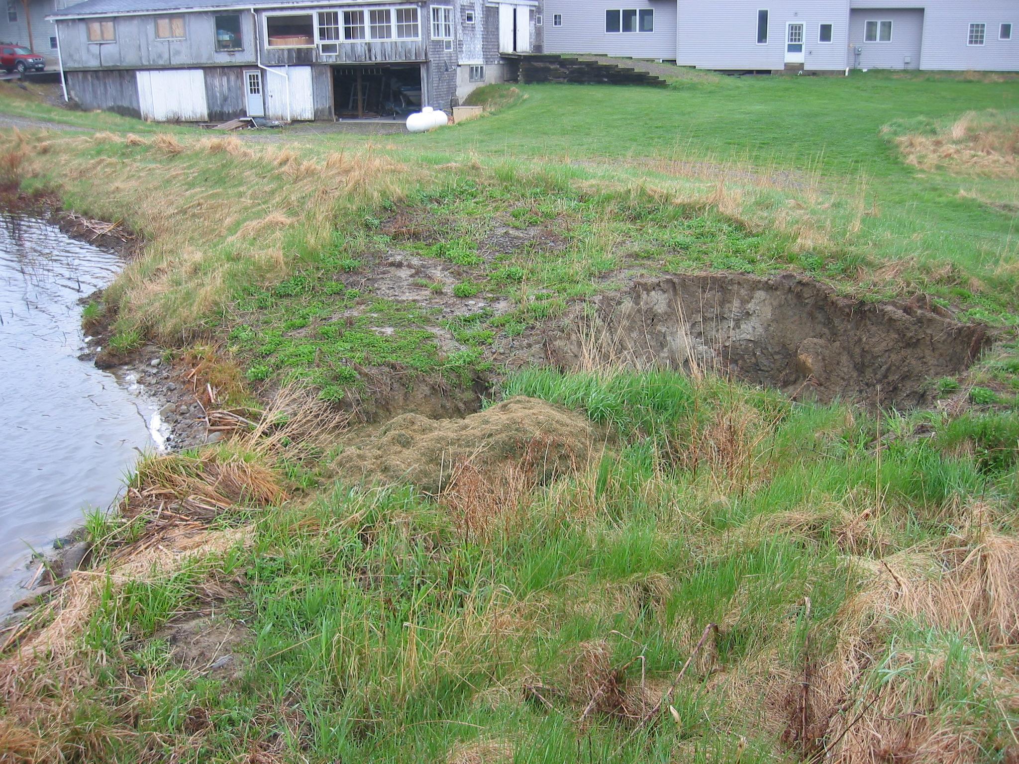

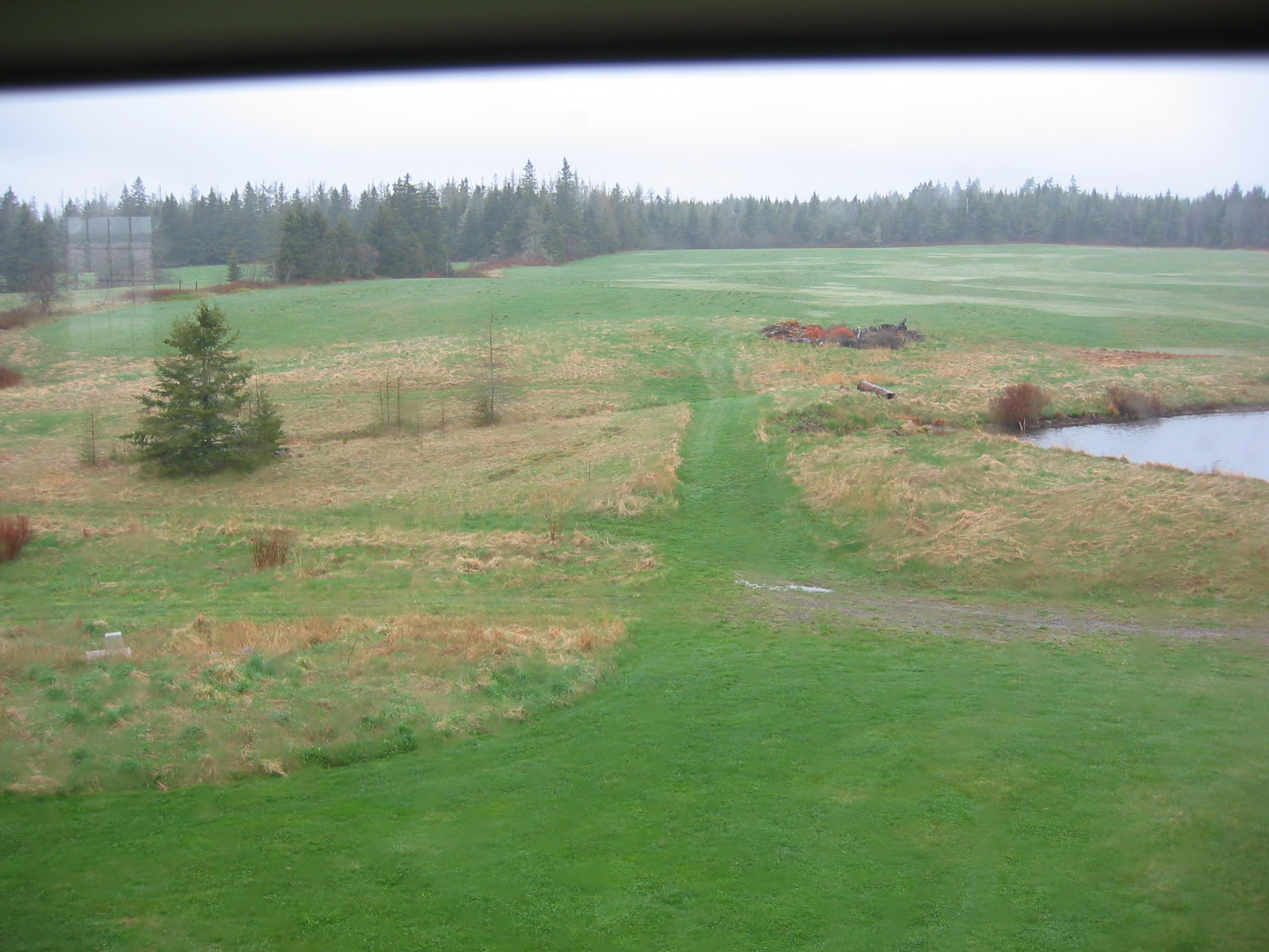

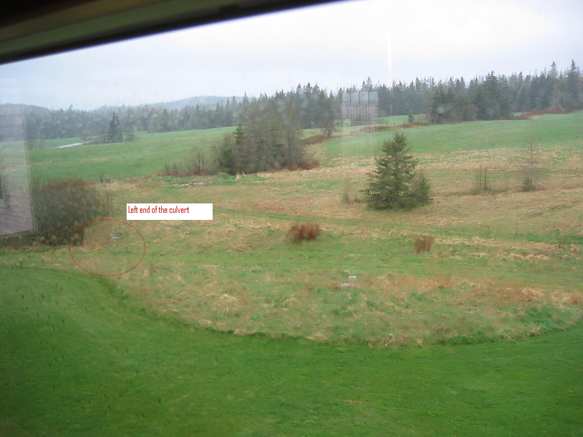

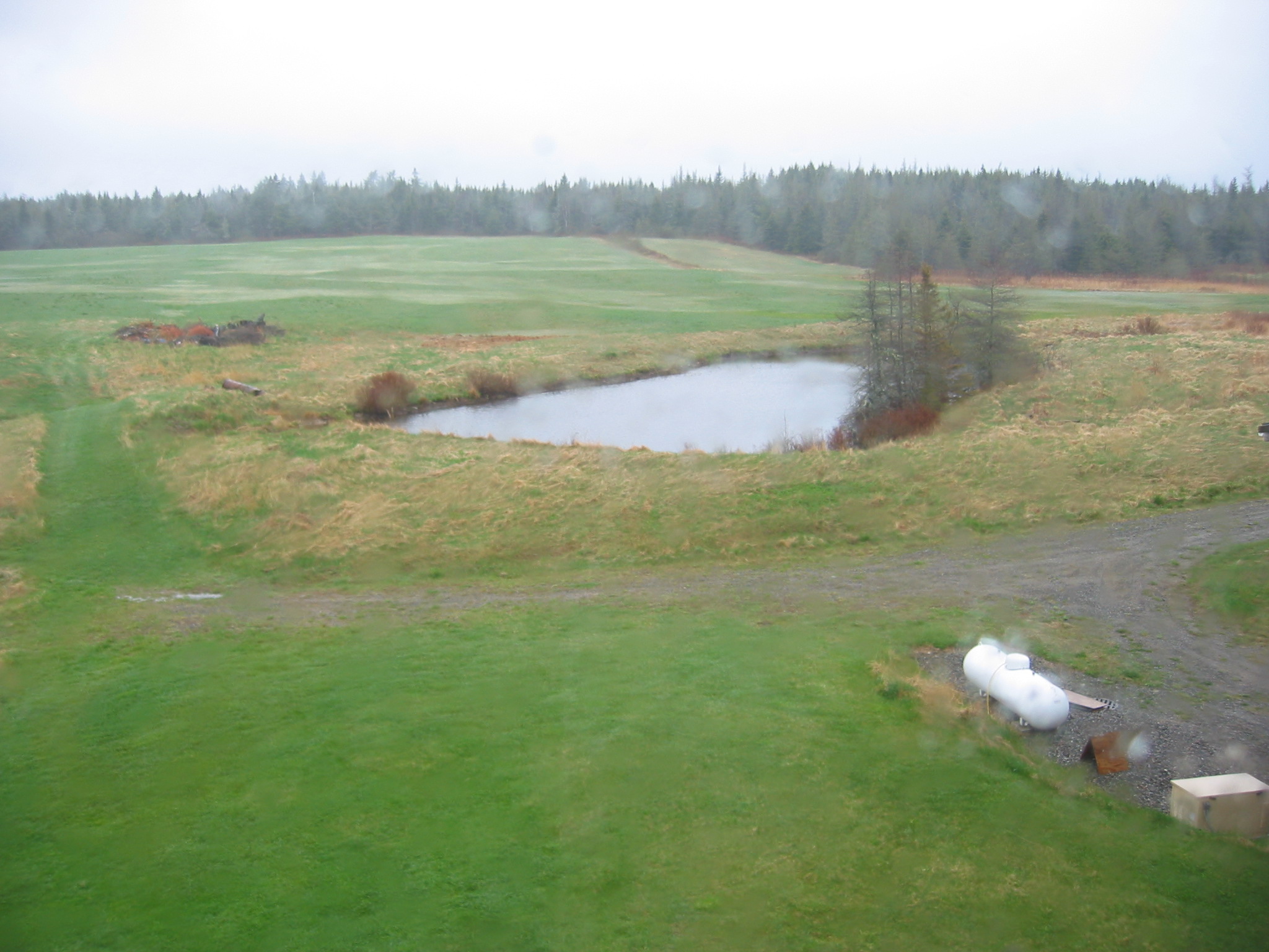

I just returned to Maine for the summer after a nice long winter away to find a few new projects have turned up in the yard. Looks like the first will have to be the culvert for the back pond. Here are the details:
It is a small pond in one of the back fields with a very old culvert made from welded barrels. Somewhere along the run the culvert has collapsed and is causing the dirt to erode. Looks like a simple project.
My plan is to dig up the old culvert and replace it with a new black plastic 12" or 15" culvert and standpipe. The culvert run is about 150'. I have never set a culvert before and wanted to know if there is anything in particular I should keep in mind. Our soil is primarily hard clay.

I have attached a few pictures so you all can get a look at the problem / project.

The most important thing when laying culvert is getting good compaction underneath and around the pipe. Having support under the bottom quarters of the pipe is especially important. Think of the pipe as holding the shape, and the compacted soil as taking the loads. If you have portions of the run which aren't going to be driven over, that's maybe less important for those portions.
It sounds like you will be downsizing the pipe diameter (and therefore flow capacity) by a good bit. Without knowing more about the situation it's hard to tell if that will be a problem.
Is it possible to convert part of the run to a suface channel?

Thanks Toiyabe,
The diameter of the original culvert is about 22" so we will likely be downsizing a bit.
I think part of the run could be converted to a surface channel.
Only the first 30' will ever be driven over.

A 15" pipe has only 46% of the area as a 22" pipe. Corrugated plastic (if that's what you are getting - there's also smoothwall plastic but that's more expensive) also has more friction than smooth steel. Friction is an important factor on a long run. My seat of the pants guess is that you'll only have about 25% of the capacity that you used to have. To run the actual numbers, you would need to know the slope of the pipe, and the inlet and outlet conditions.
Is that a problem? Do you have a sense of how full the old pipe used to flow? What are the consequences if the pond overflows?
