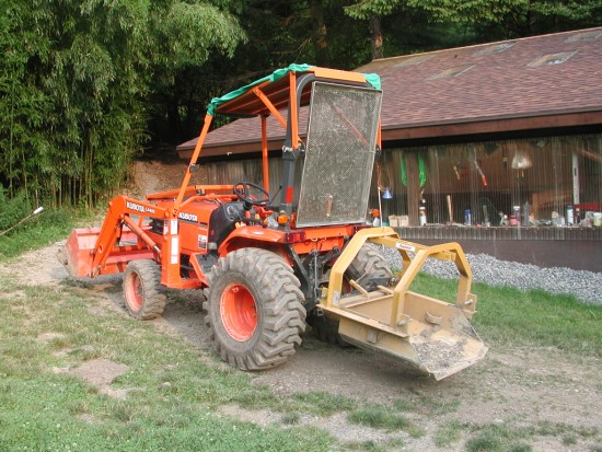

   / Pond/dirt Scoop #4
<font color="blue">Could you possible post a picture of it </font>
Here's a picture of mine. It's a KK and works pretty well.
In this picture it is on backwards so I could back into a pile of dirt...
